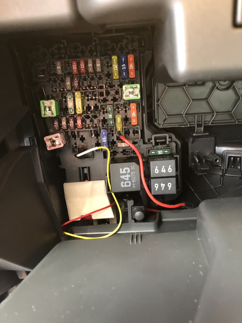

See attached pic of fuses behind the glovebox. The yellow fuse with the red wire tap is for piggy lighter etc. I have my satnav and dash cam wired to this. On only when ignition is on. If you move that fuse up half a position I think it is so level with the green one to the left it is permanent on.
The yellow wire you see also goes to a permanent on contact.
Hope this helps.

That’s what I was trying to get at.. although I didn’t have the wires in there..lol
When mine was delivered the yellow fuse was up half a position and the 12v was on full time.. move it down to that position and it only works with the ignition on..
