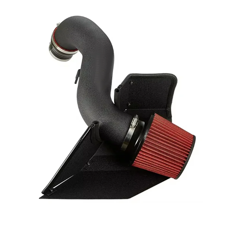

If you want to experiment on a budget, you can try the Aliexpress 100 euro intake

Link to the intake:
I bought the intake at a dutch webshop for 115 euros inc shipping. In the meantime they have upped the price to 149 euro (ex shipment) :eek:

The price of the air intake actually seems reasonable to me! I’ve read a lot of positive reviews about the Integrated Engineering intake, but it’s over eight times more expensive! Does the SK Import version cause any issues in hot weather or higher outside temperatures?

The Ali intake does not fit 100%, you will need some adjustments here and there. For the money it isnt bad! I adjusted it further so I could fit a bigger filter (trimmed a couple of cms of the intake pipe).

Is there a difference between the SK version and the one from AliExpress? I’m not super handy myself, so I’d rather buy something that fits perfectly right out of the box.
I just read in your thread that they’re actually the same. What modifications are involved? What’s your experience with it?
2 Things I remember
- The bracket on the intake pipe does not line up with the bolt hole on the engine block, needs adjusting
- Therefore the intake pipe on the silicone joiner on the turbo elbow fits under a little bit of stress
The silicone reducer will hold the intake pipe, but this fitment could be a lot better
