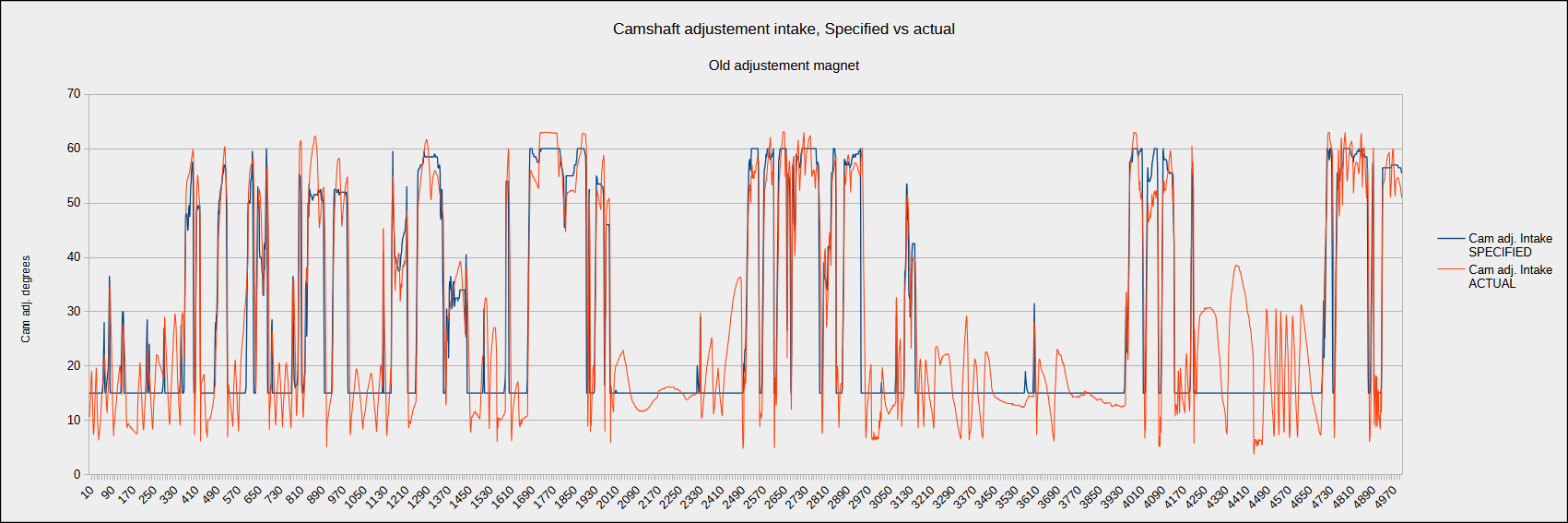

Here's a chart before changing the magnet:

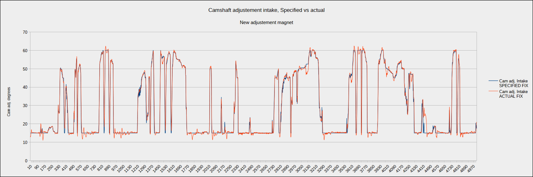

and after:
as you can see before changing the magnet the actual degrees were WAY off, especially at the 15° mark, when the car is idling.

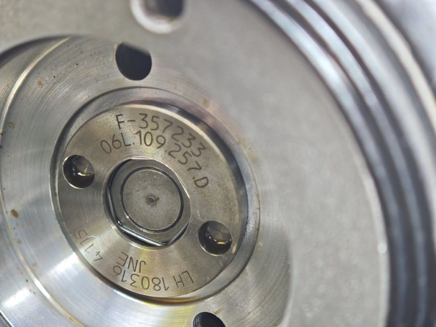

Now this isn't the only possible issue when having a rough idle with this kind of data, it's also possible the valve that this magnet actuates is stuck or broken. The valve is right behind the magnet on the engine, so if you remove the magnet actuator you can see it:
the circular pad in the middle is what the pin on the magnet moves! It should be flush wit the the surrounding housing and you can easily press it in with your finger, and it should spring back out to this position easily! If not consider changing this part too, but you need a special tool for this. The valve uses engine oil to operate, so it's sensitive to dirty oil, or oil with thicker viscosity.

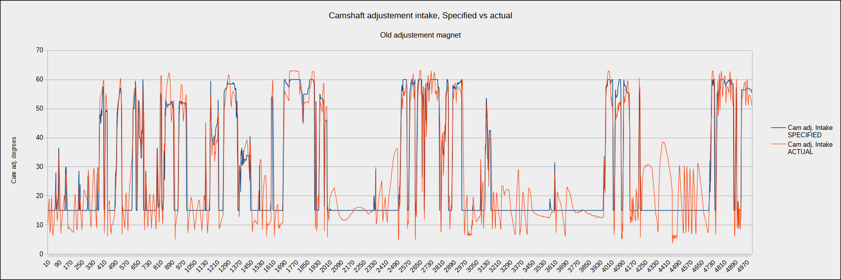

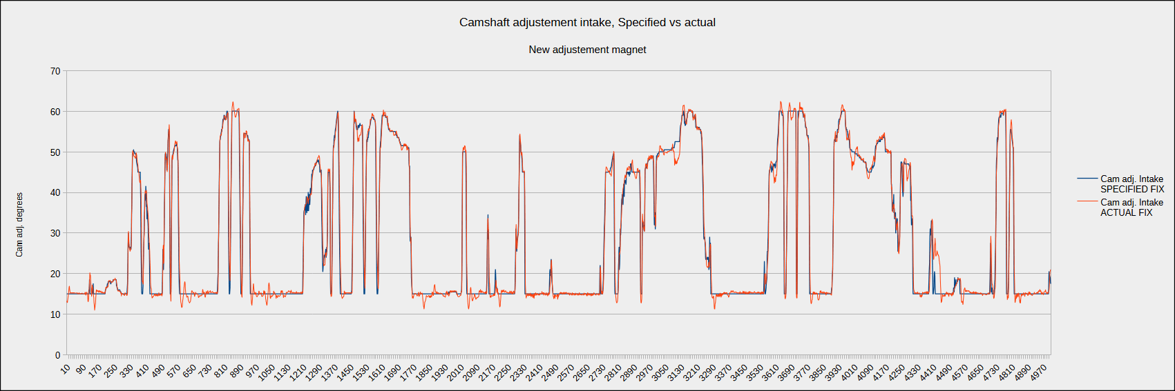

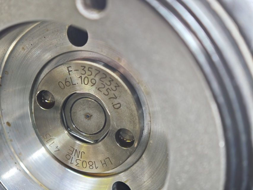

and after:
