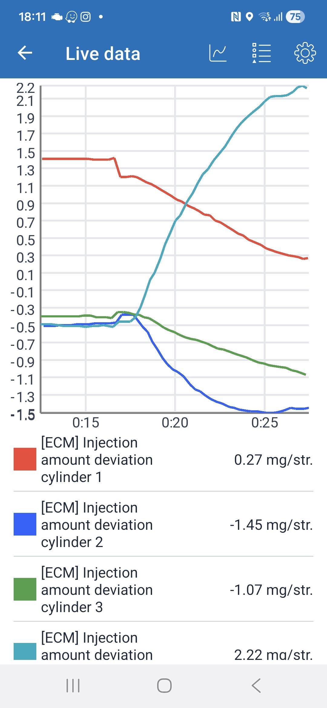

I have taken it to a mechanic and he did say there was an injector imbalance, there is a loop where injector 1 goes high then drops then injector 2 goes high and drops and the loop carries on.
I have a 2014 184 and had similar issue. It was an injector imbalance. Mine are getting replace shortly.

The only thing I noticed was when at idle, usually when the car is warm, I get the vibration/shake. It has been getting more frequent. I had a carbon clean in December and as part of the clean all of the live data gets checked. I was told that there was an injector imbalance. I have a Carista OBD dongle and put an app on my phone (Car Scanner Pro) to measure the injector deviations in real time. You can see the values changing at idle.
So far, the only issue has literally been the shake at idle but I think it's impacting fuel economy. It can also cause power loss and acceleration issues. My DPF has just been replaced so I'm going to see how it runs since that can impact fuel economy etc so it's hard to know if the DPF and/or injectors were contributing to that. The plan is to replace the injectors in the next few weeks once I've made sure the DPF situation is all good. If the car shake gets really bad I've been told that it can wear the engine mounts.

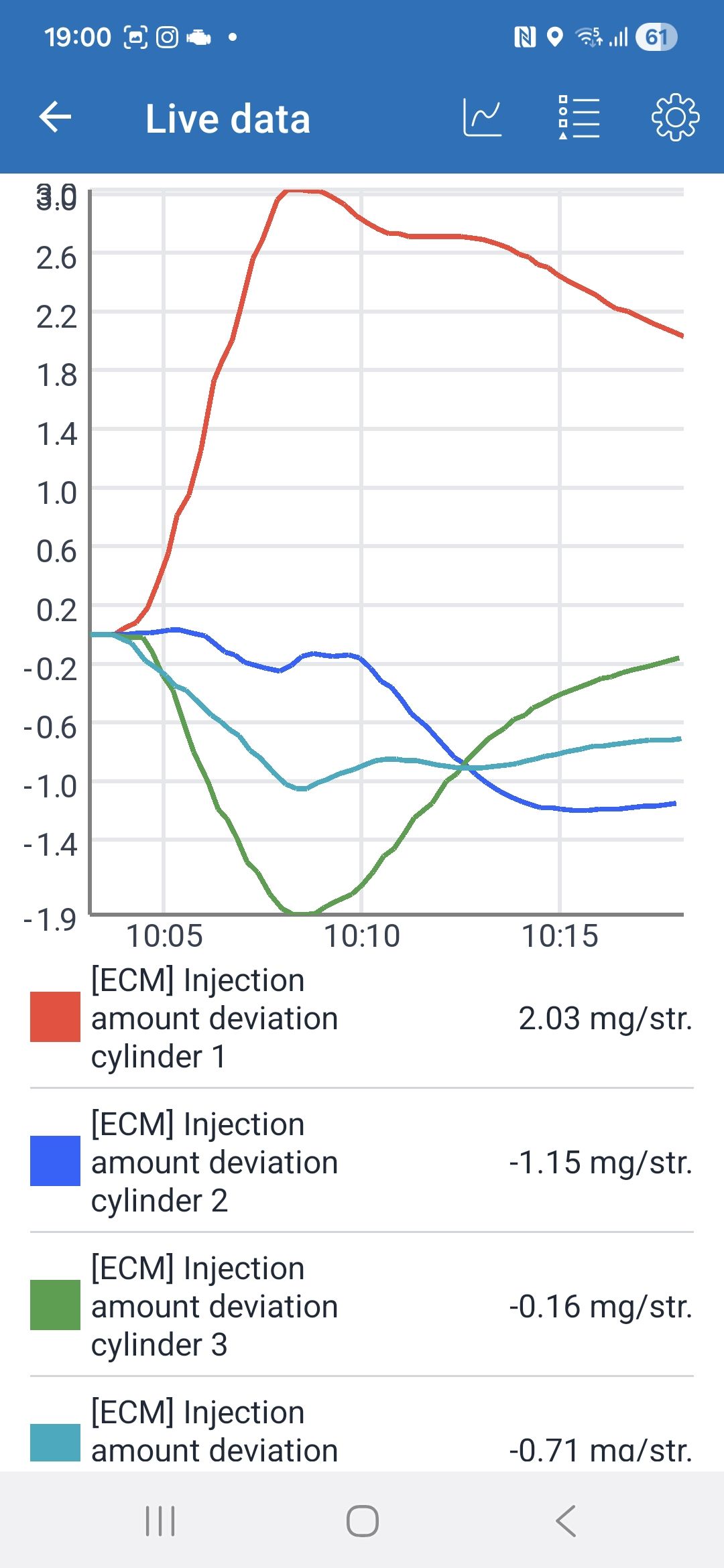

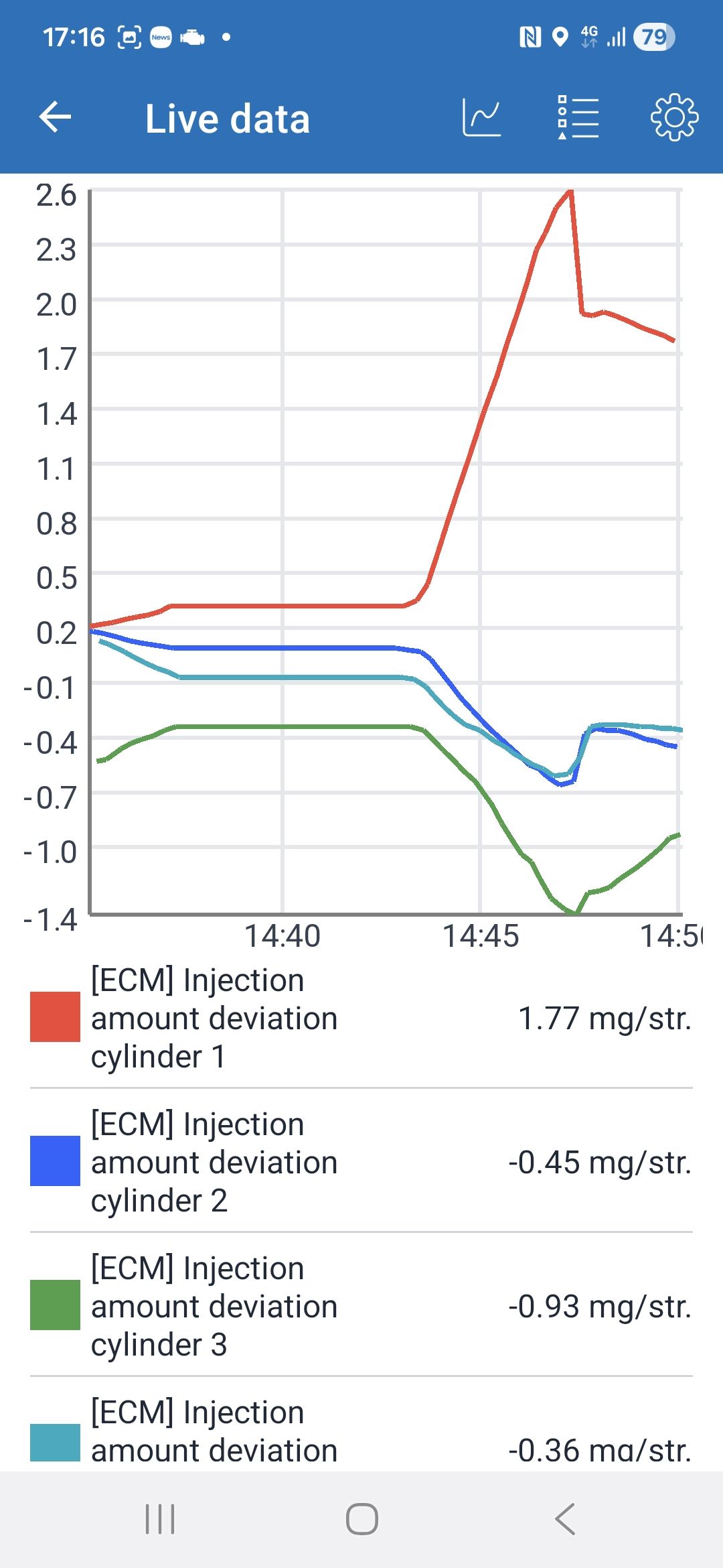

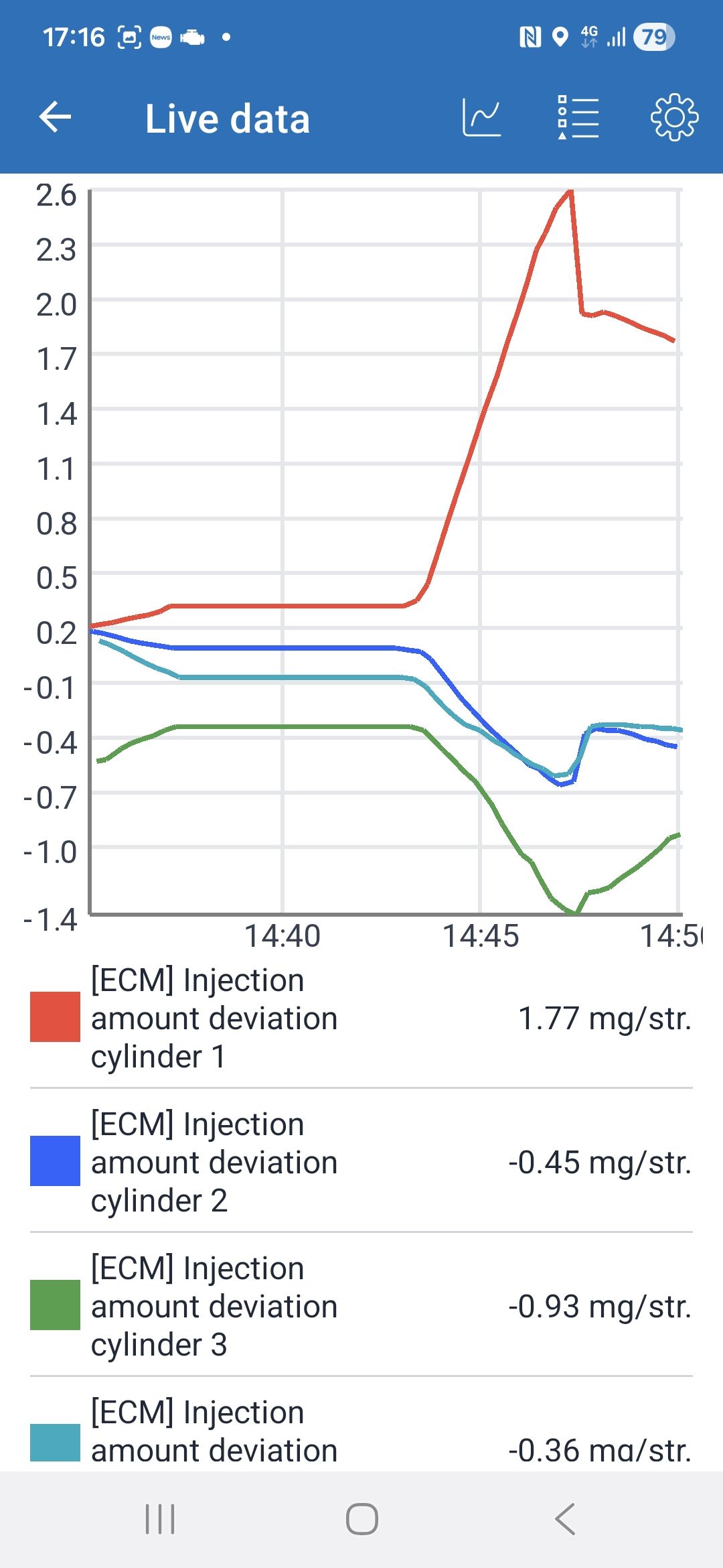

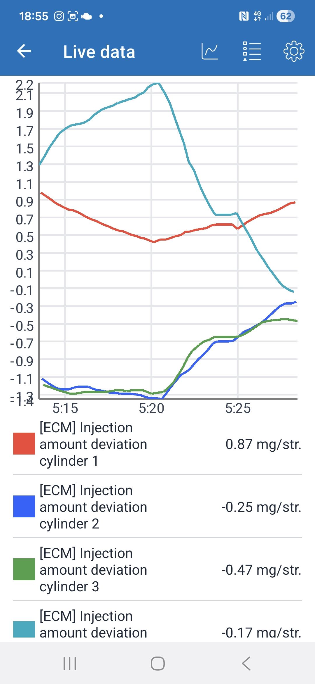

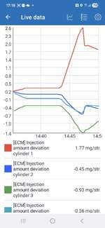

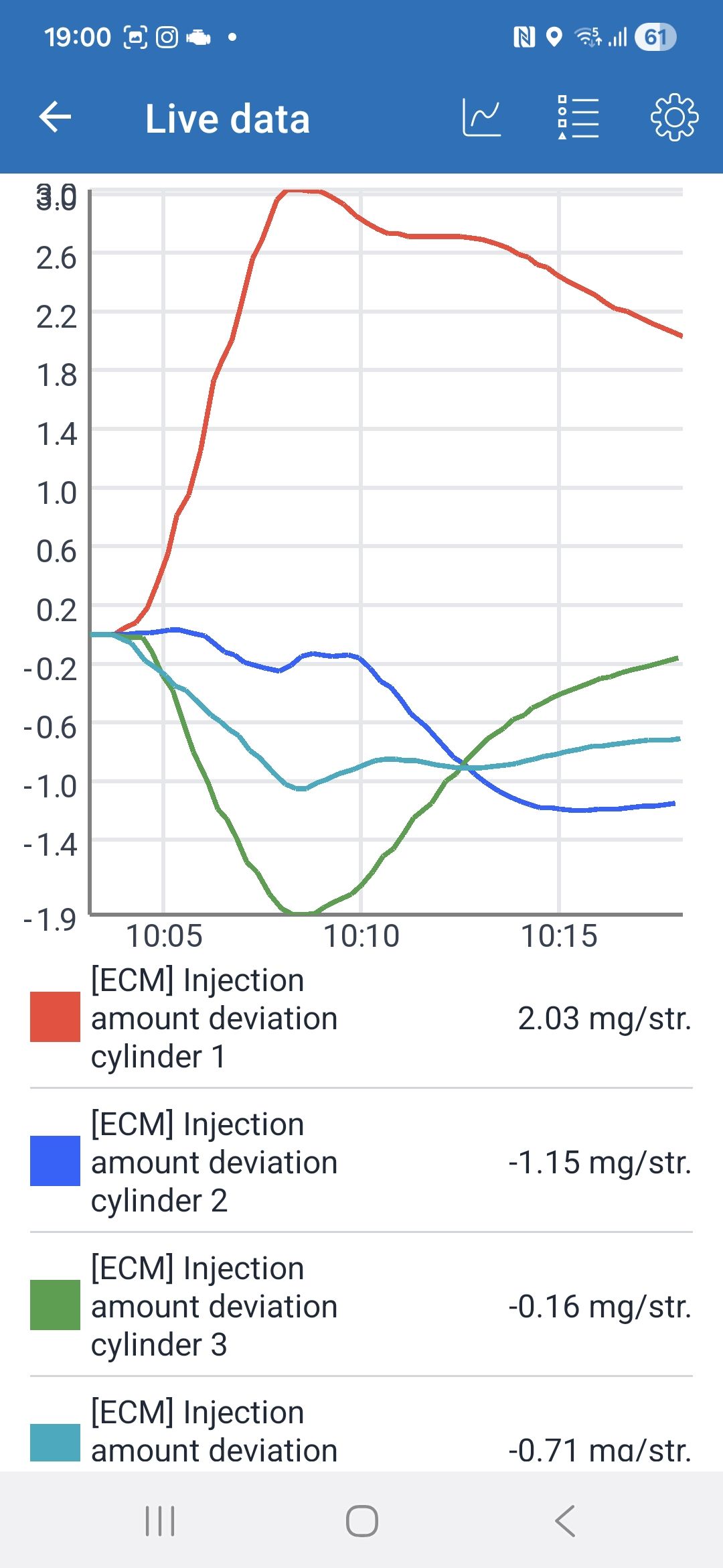

The injectors constantly adjust the flow rate to maintain a smooth idle. The injectors are meant to deviate by no more than +0.5/-0.5 mg/str. Ideally, the values are all much the same. Anything above +2.0 mg/str suggests an issue. If one injector does that, the others have to compensate,
In this picture all 4 injectors are behaving themselves, all within +0.5 or -0.5. The lines are steady and flat. Then, at idle, injector 1 shoots up and all 3 injectors compensate by going negative but mainly injector 3.
In this one - injector 1 goes up to +3.0 mg/str (bad news) and injector 3 picks up most of the slack.

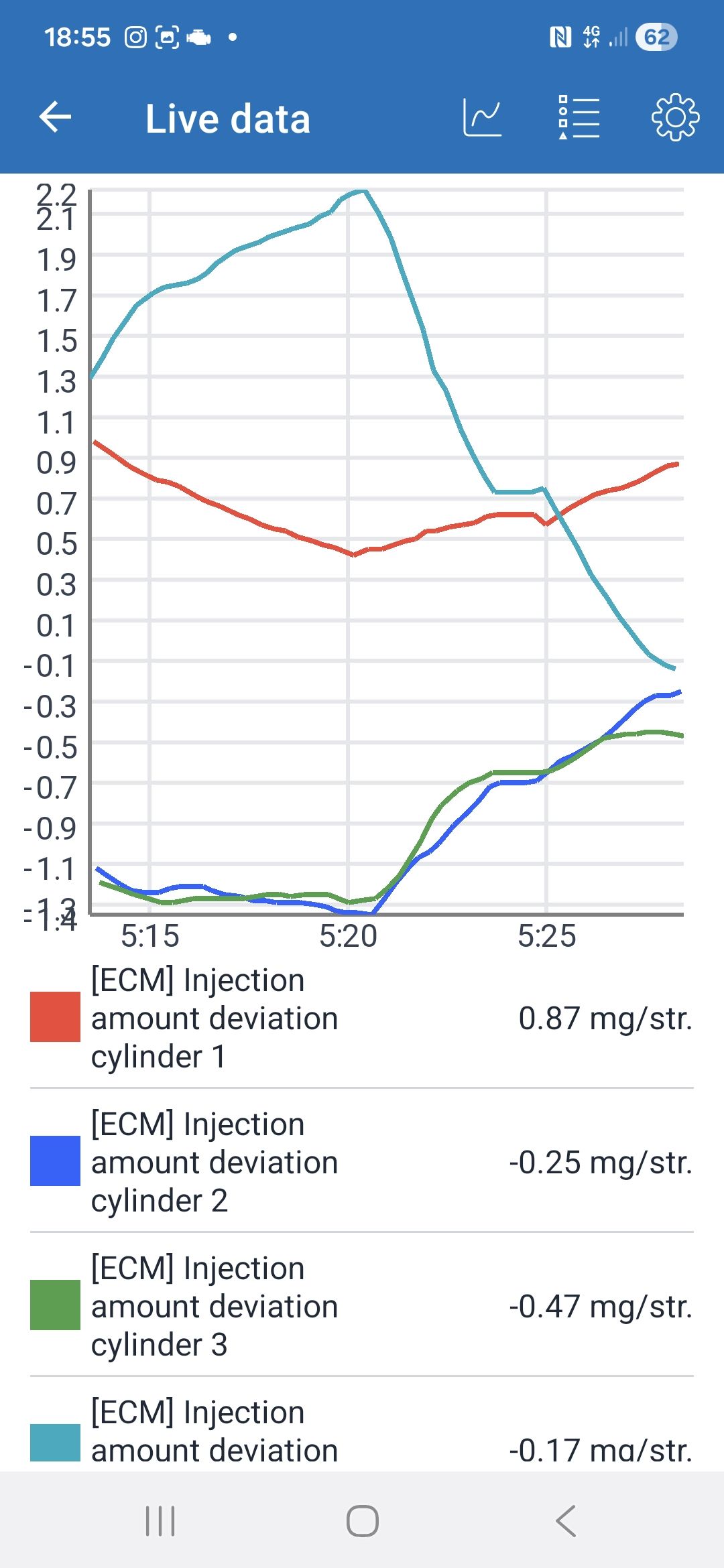

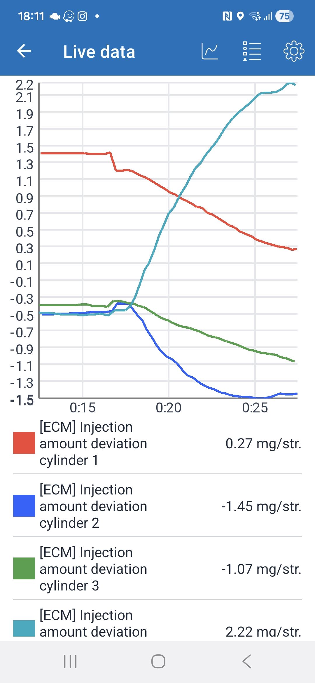

On this one, injector 1 and 4 are having issues, causing 2 and 3 to compensate.
The lines should all be flat and steady at much the same values and not deviate too much. Mine are not. Anything between +2.0 and 3.0 (or more) are signed of bad injectors, excessive fuel or compression issues. Mine are not right for whatever reason so I'll monitor and see how they go. I do think they'll get replaced at some point.

The injectors should not really deviate more that +0.5 mg/str. Anything over +2.0 is considered a sign of faulty/worn injectors. From the images above you can see that injectors 1 and 4 seem to have the issues. I don't need to test them as I can see the data.
