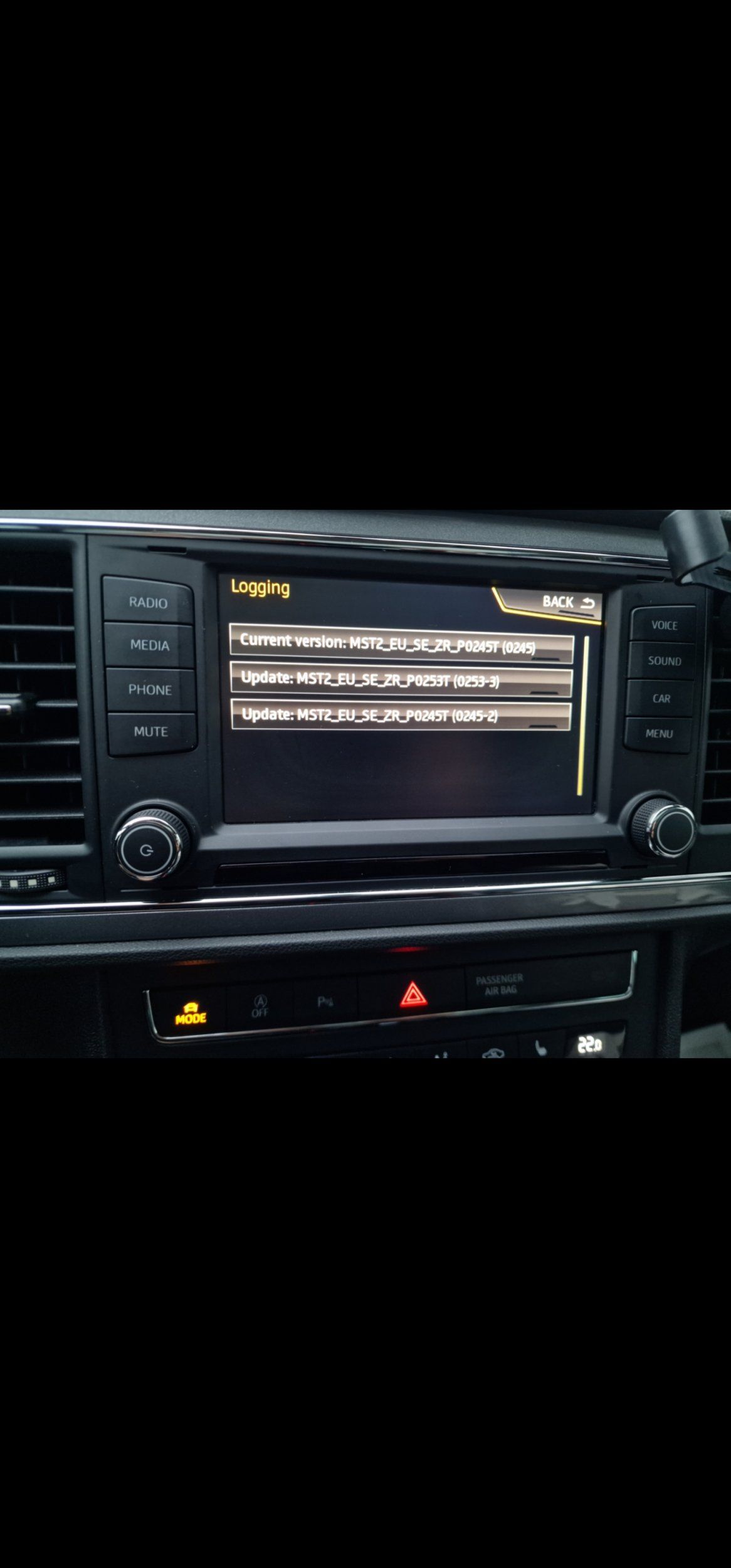

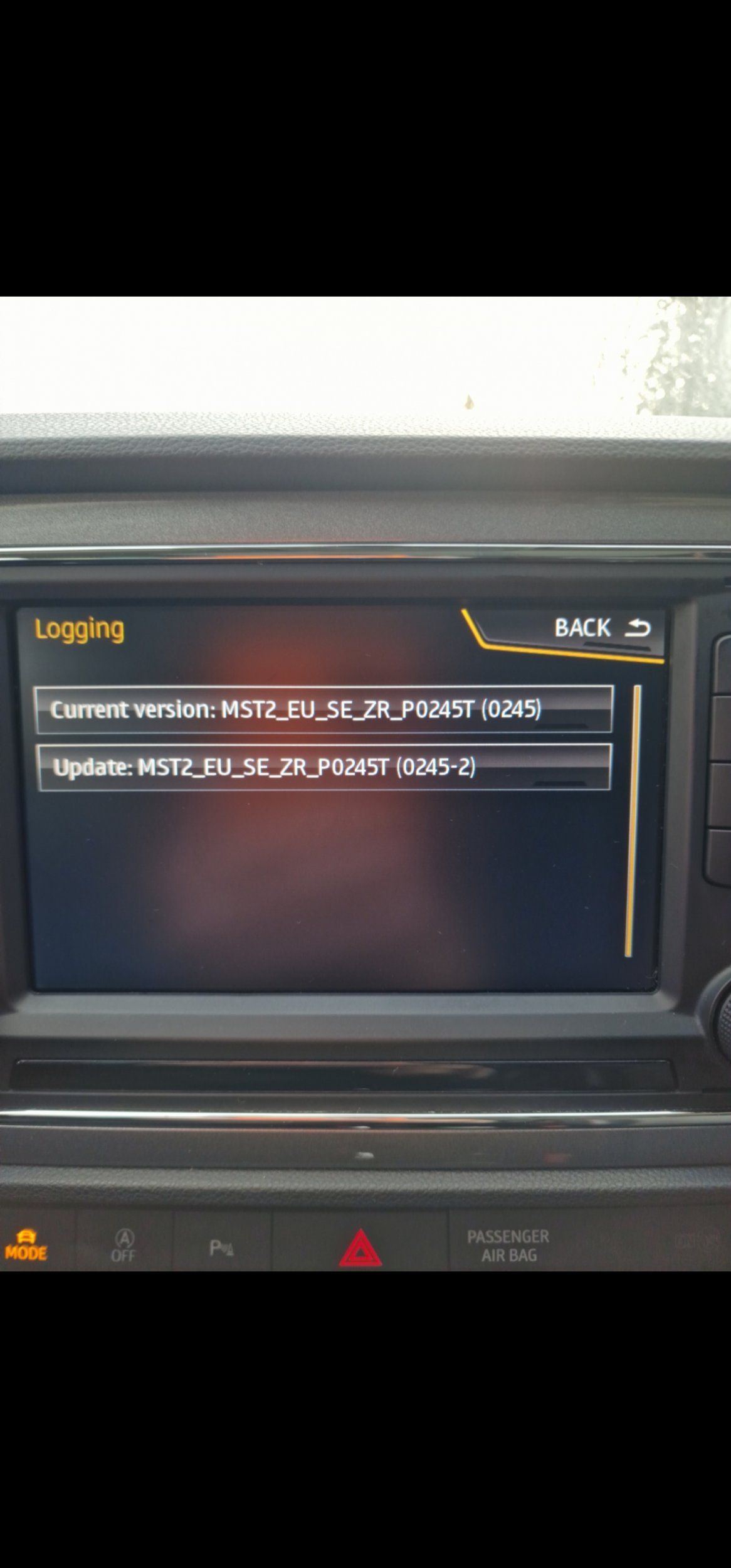

I did the installation of the 0253t version with usb but I didn't see any change. Now I thought if I would change the screen and the central unit something would change. But since you are writing that this cannot bring any change, I will stay with the version I have. It means that it is an expense without result. So I will only use android auto or miror link for navigation. I am sending you a photo to see what happened with the 0253t system that I installed. It works ok but I will not make any attempt to install the new version so as not to destroy it.
Nothing changed. It is still the old version. The new version I wanted to install was interrupted and threw some errors. So I won't try anything else. It works ok now and it's fine like this without any new version!
Not compatible then. Saved you the trouble of messing up your unit.
