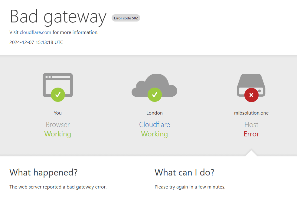

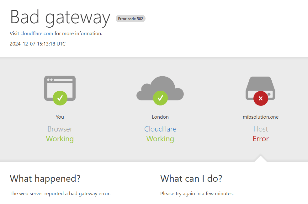

Thanks for this important information as i am also trying to update my unit which is currently on MST2_EU_SE_ZR_P0351T.
The last compatible firmware you advised is MST2_EU_SE_ZR_P0369T which I'm trying to download it but i keep getting bad gateway error.
Is there anywhere else i can find this firmware to download, or does anyone have a copy that they can share with me please?
Cheers
*** Update = After about 10 tries it started downloading, must be very busy server.
