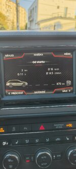

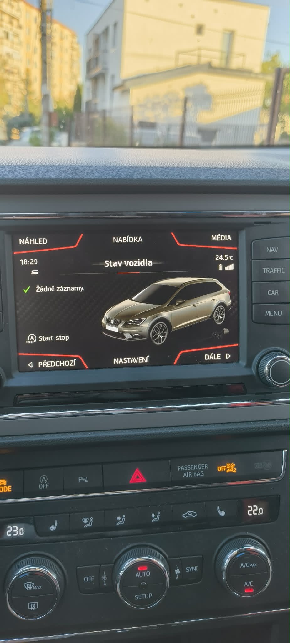

and what about skin, (red lines), is it possible to change it somehow without hard hacking (swapping names of skin folders or so on) instead of adjustment rgb profile https://www.drive2.com/l/550087042839610039/ ?

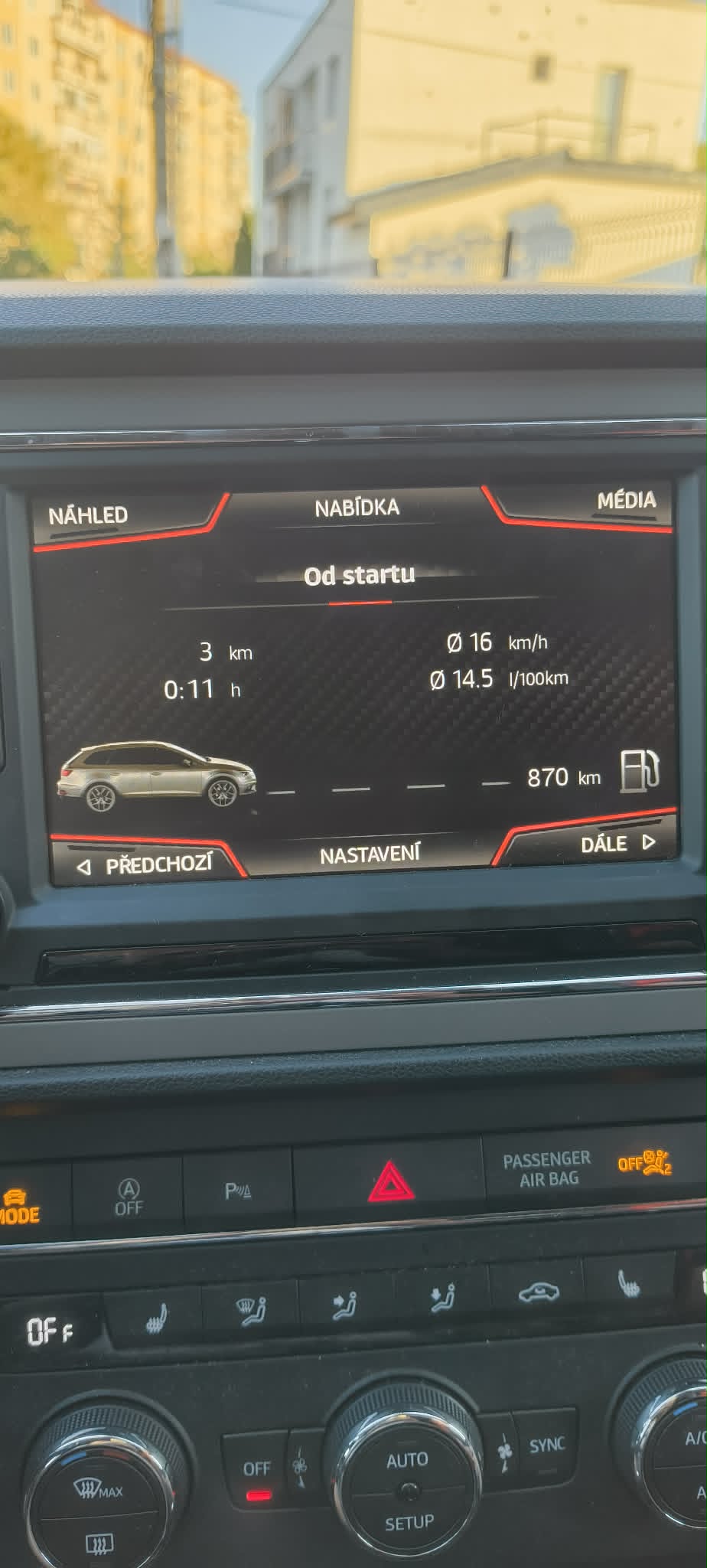

I dont have ambient lights in car, I just want to have in main unit same color of lines, as it is on maxidot (yellow). this is nothing customization, just using existing skin what I see on anothers cars (and also in my prev. sw, but on foto i documented that main unit has red color - strange, if it was switching automatically based on algorithm or what)...

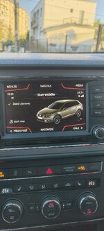

You managed to change the red lines back to the original yellow ones. I have the same problem; after the MU1447 update, I have red lines. I have a 2016 Seat Leon X-Perience. The ambient lighting only has two colors: white and red.
Well the lines take on the ambient light colour so on the pallette of ambient colours on my Ateca Xcellence it has 16 or something so then one retrofitter moved me from the 2017 mib2 high release whatever that was to a later releases that's when it clicked into using the ambient pallette colour.

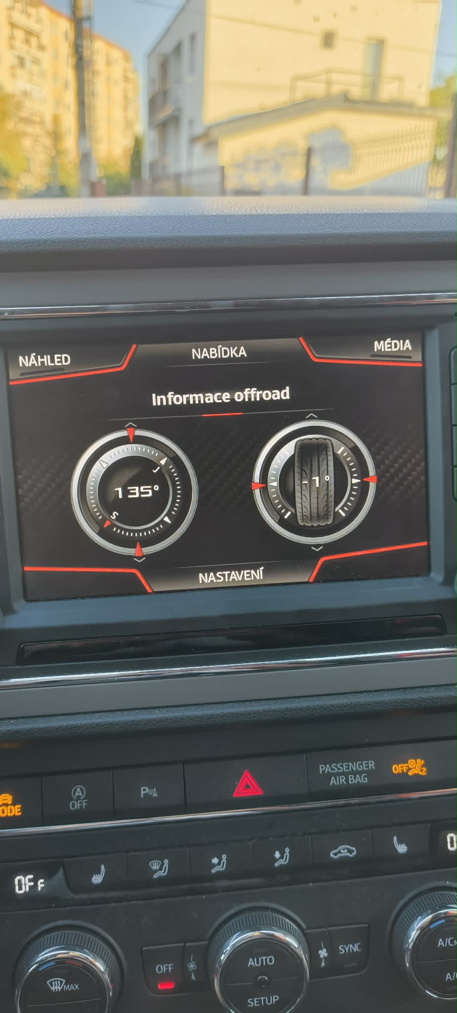

Do you think installing AIO will solve my problem? I found an image for the Leon X-Perience, but the skin isn't compatible with the X-Perience—the off-road menu isn't correct. Long coding doesn't work; I still get the same red lines.
The off road menu is enabled because AIO enables all of those hidden menus via the FeCs for them. That's something different.

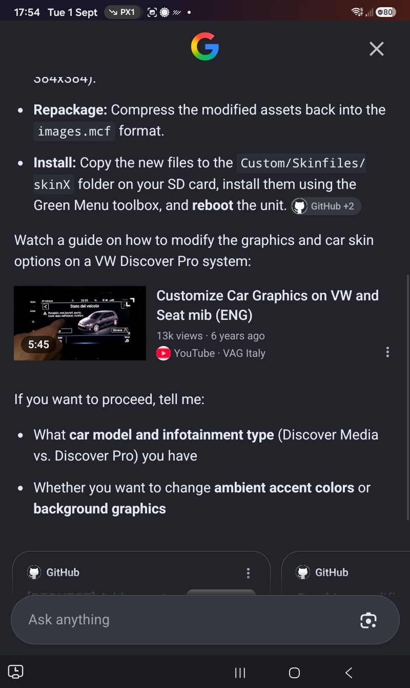

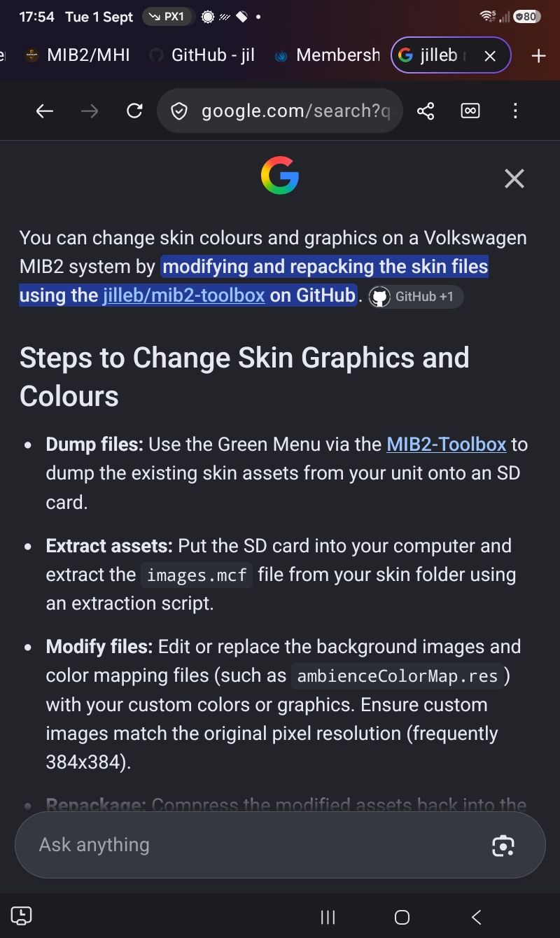

Well Google AI points you in the direction of using the Jilleb toolbox as I said.
Then it links to the YouTube video.
I think that's how you do it but I have never used that toolbox myself.
The helpful AI summary came from this will probably render it in your language.
