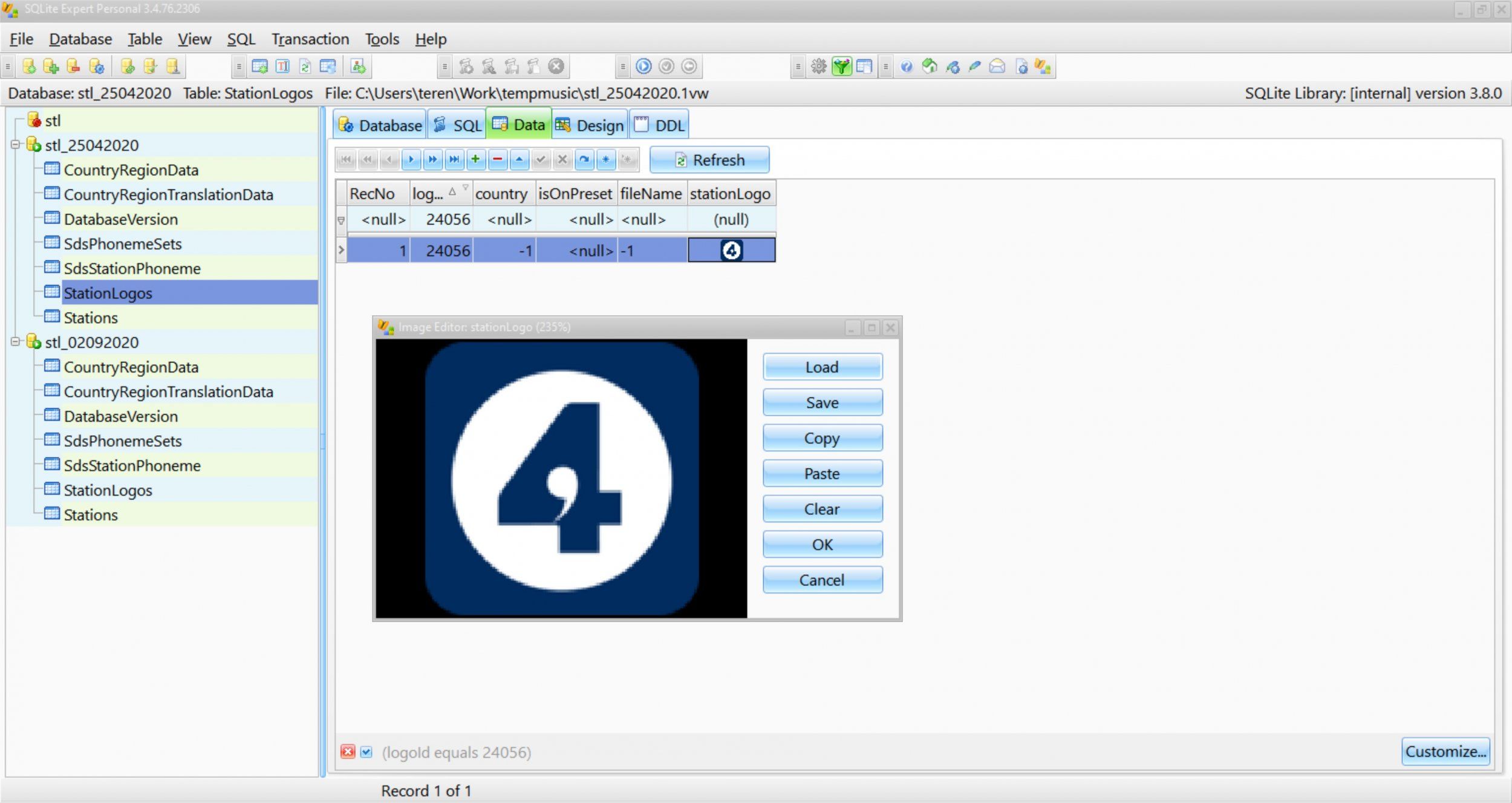

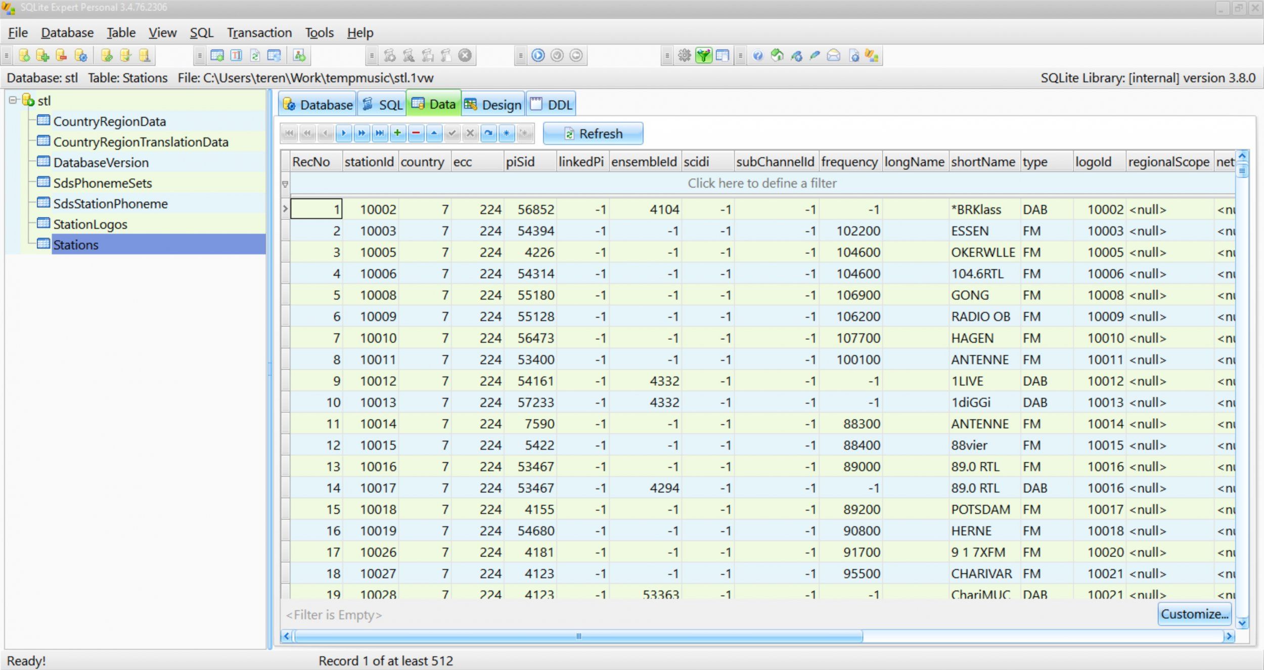

Radio one key tables:
The graphics one with the stations logo table (blob graphic being the last field):
Example blob:
Uses logoId to index into it from this one the Stations table:
You would compare the station table between releases assuming all other fields were correct.
