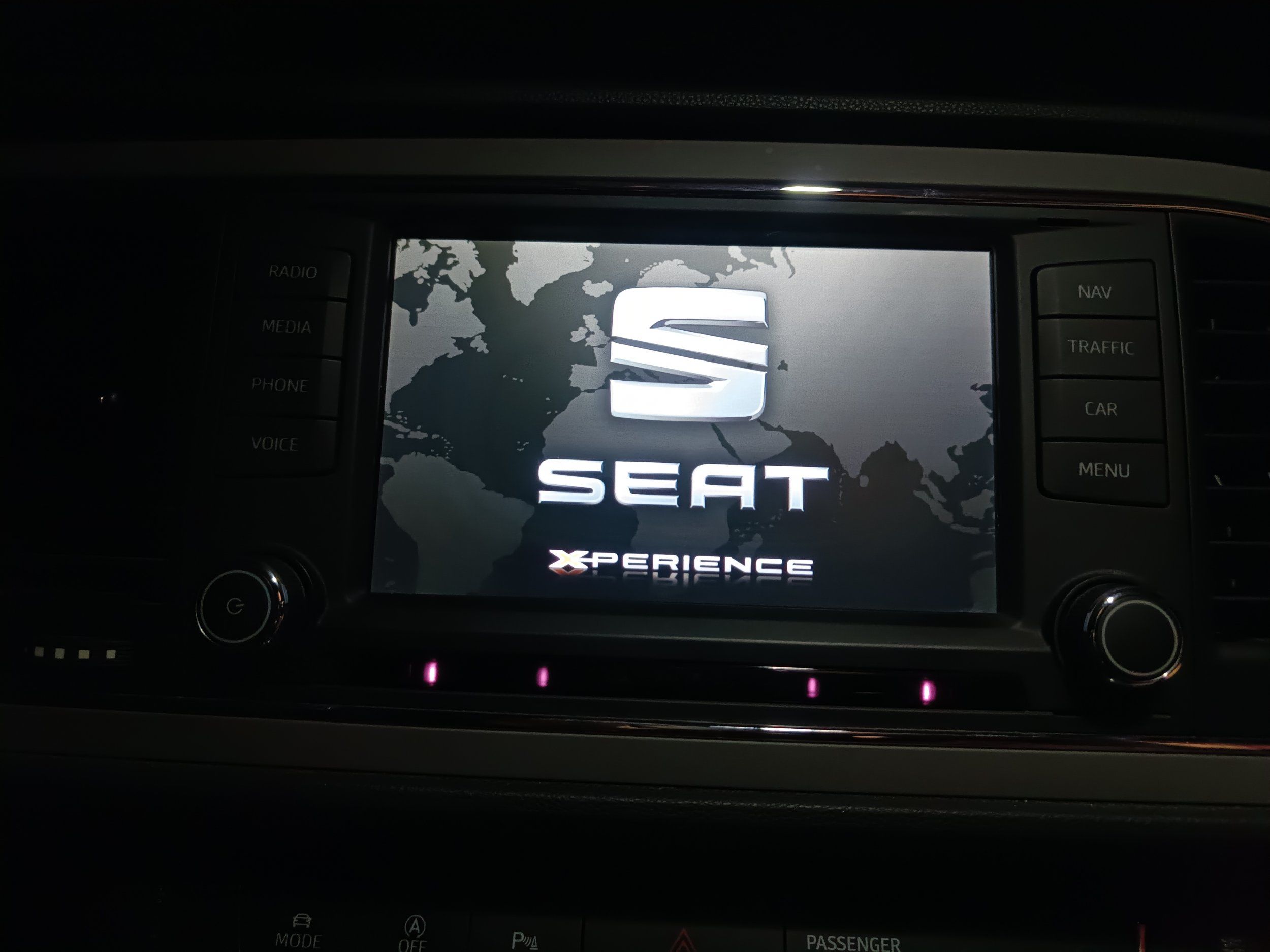

Hi,
I started this update this afternoon from mhi2_er_seg11_s2105 (0319).
During installation, only Gracenote update failed. 20 minutes later, mhi2 reboot and Seat Xperience logo appears on screen.
But 2 hours later... No changes, always Seat Xperience logo 😱
Should I wait ? Turn key ? Cry ?
Regards
Edit: I turned the key (without start the engine) but still the same 😬

Hi,
Regards
Edit 2: 3 hours later and no change... I bricked it ?

Is the installed version changed to 1447 ?. If so it's the screen logos you change but I won't point you in that direction till checked.
This screen appears after 1 reboot and nothing more... The installation is not complete I think...
Should I push navi on/off button ?
I bought the car yesterday 😅
Edit: if I turn the key without start the engine, nothing change... I don't remove the key
Edit 2: if I push navi on/off button, nothing change 🙄
Edit 3: 5 hours now on this screen 😕

6 hours later... Still the same...
I removed the key, lock the car... And screen stays on 😳
I plugged a battery charger for the night... And I pray 😥

It's working 😅😅😅
I just removed radio fuse, wait 15s and put it.
The installation has continued and I fix B201A fault code...
I just wait 6 hours like that 😱
