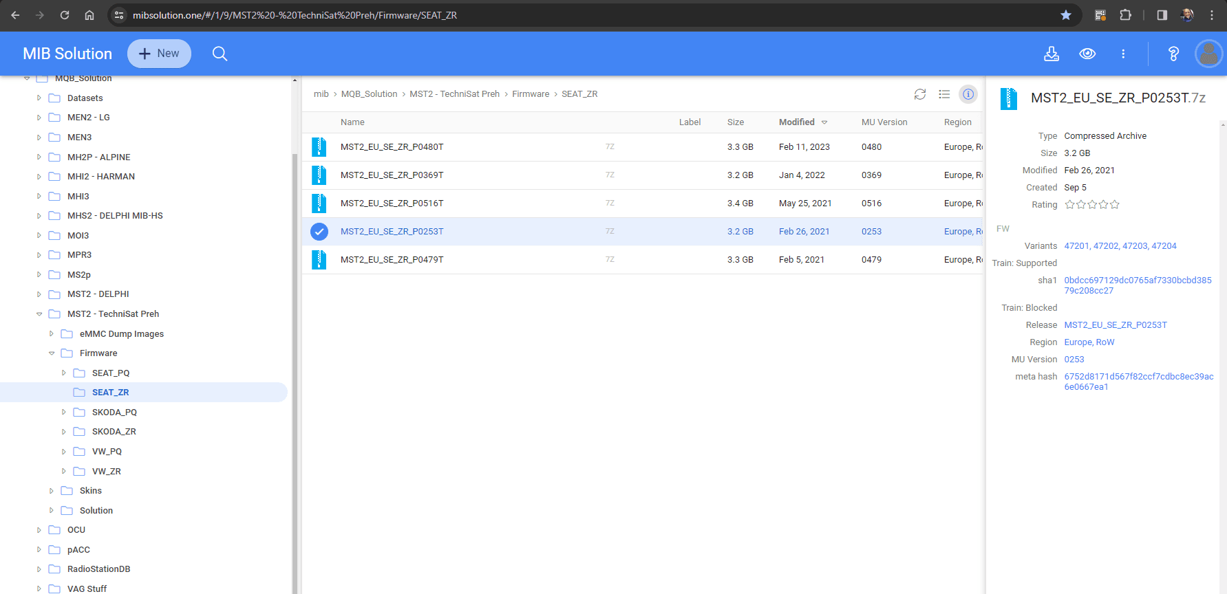

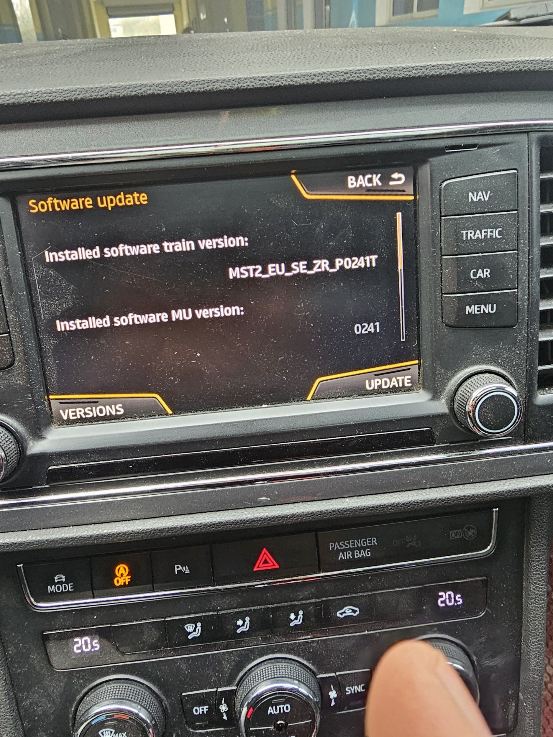

Hey i have seat leon 2016 MST2_EU_SE_ZR_P0241T and i want to update the software, i searched on mibsolution and i couldn't find the right software for me , does anyone have a link for it?
It's there on the mibsolution, I believe.
253 seems like the latest version for you.

What about 516 ?
There are different software branches (they say "trains") for different devices.
Yours is 02xx and you should use updates for your train.
Trying to update to a version for a different software train is not recommended.
Feb 19, 2024
6
So the last one is 253 when i update it i can't go higher?
