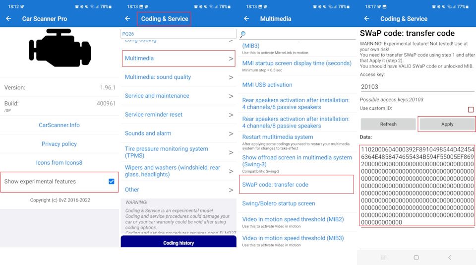

Have a 2016 Leon FR with the 6P0 infotainment system (MST2_EU_SE_ZR_P0253T), and I finally managed to get Full-Link unlocked via OBDeleven and MIB2 Toolbox, only to find its only got MirrorLink, NOT Android-Auto or Carplay... :mad:
Is this something that can be added with a firmware update?
I tried downloading from mibsolution.one, but either the site is seriously bugged or my connection is, but I couldn't download anything.
MIBHelper says that firmware v.0253 would work, but I can't seem to find a good download?
Any help guys?

Well you got 253T so you have it already. Mibhelper is like an AI system pulling files together with text only as good as the text. Pass on what exactly is in 253 when Android Auto / Carplay came along. Mibsolution is having a day off in any case so it seems. The T means it's a legitimate shipping one BTW.
As for trains which you haven't asked about if AA / Carplay isn't in the 2* train then you are a bit stuck since changing trains isn't something you should do. It's in the 5* train I know that.
This I reckon is where you press the menu button (long press) to review enabled and available FEC/Swap codes. If it's not in the list you are a bit stuck on the 2* train. Thats like the Vag goody shop that if you paid you could have these. That's the workaround to enabling what's on the list.
There are mods to get you off trains but frowned at since they can brick yoyr unit. East Yorkshire Retrofit offers a service but you'd have to check whether they have this path. The unit is opened up. So it could be those things came later than 2*... anyone.

Doh! The unit firmware is actually P0245T, I cut and pasted the wrong code.
Hmm, might retry MIBsolution again later and see if I can get 0253 firmware.
Anyone else know if AndroidAuto came on 02XX series units at all?
I think you are on the right track. The Seat and Skoda trains are similar so they did it in Skoda's 253 firmware. You need the Seat one.

Might be an MIB1 issue, as mine is now working fine after unlocking options in OBD11.
Still can't download a firmware update, but this is working for now, enough to get waze up on screen!
Thanks a lot for pointing me in the right direction Tell. ?
Reactions: Tell
