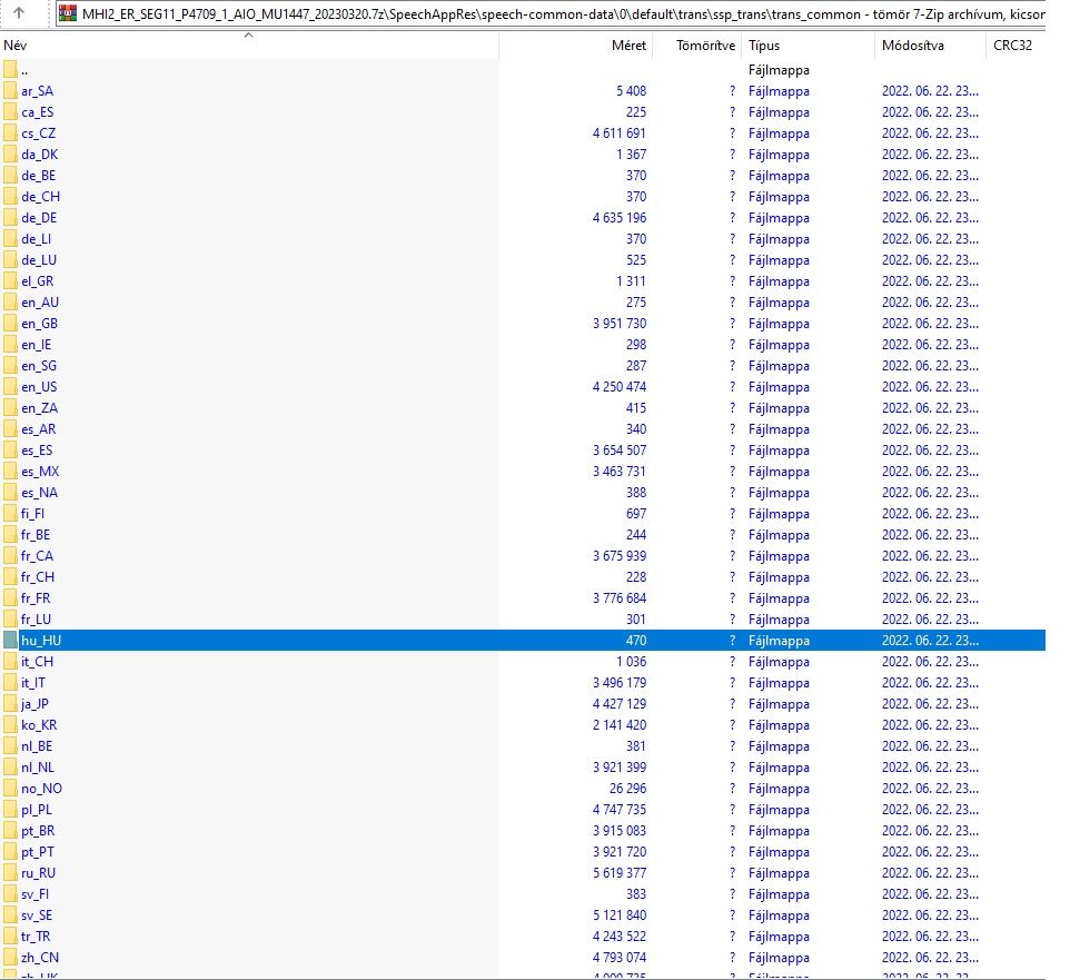

Hello,
Thank you for this information!

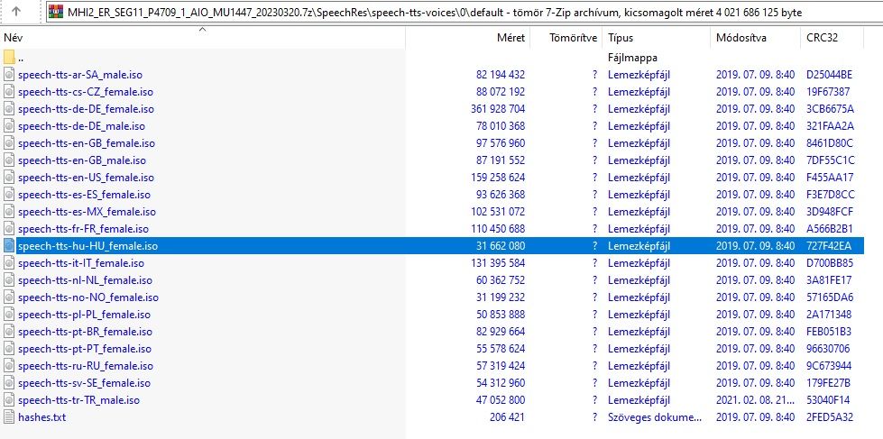

As i searching i found language files in 1447 AIO in \SpeechAppRes\speech-common-data\0\default\trans\ssp_trans\trans_common
Is this what we looking for? In hu_HU folder there is only one file in it, other languages has 15.
Another folder probably Navigation voice and there is Hungarian file so nav speech should work.
MIBsolution is very slow nowadays, but i had these firmwares downloaded and neither contain files in mentioned hu_HU directory:
MHI2_ER_SEG11_P3240_MU0674
MHI2_ER_SEG11_P3302_MU0818
MHI2_ER_SEG11_P4708_MU1409
MHI2_ER_SEG11_P4709_MU1447
As i can check other firmwares too.
It will be good if i check older firmwares too, but i can not find these firmwares anywhere. On MIBSolution the MU0674 is the oldest.
MHI2_ER_SEG11_S0257 MU: 0123
MHI2_ER_SEG11_S2105 MU: 0319
MHI2_ER_SEG11_S2130 MU: 0355
