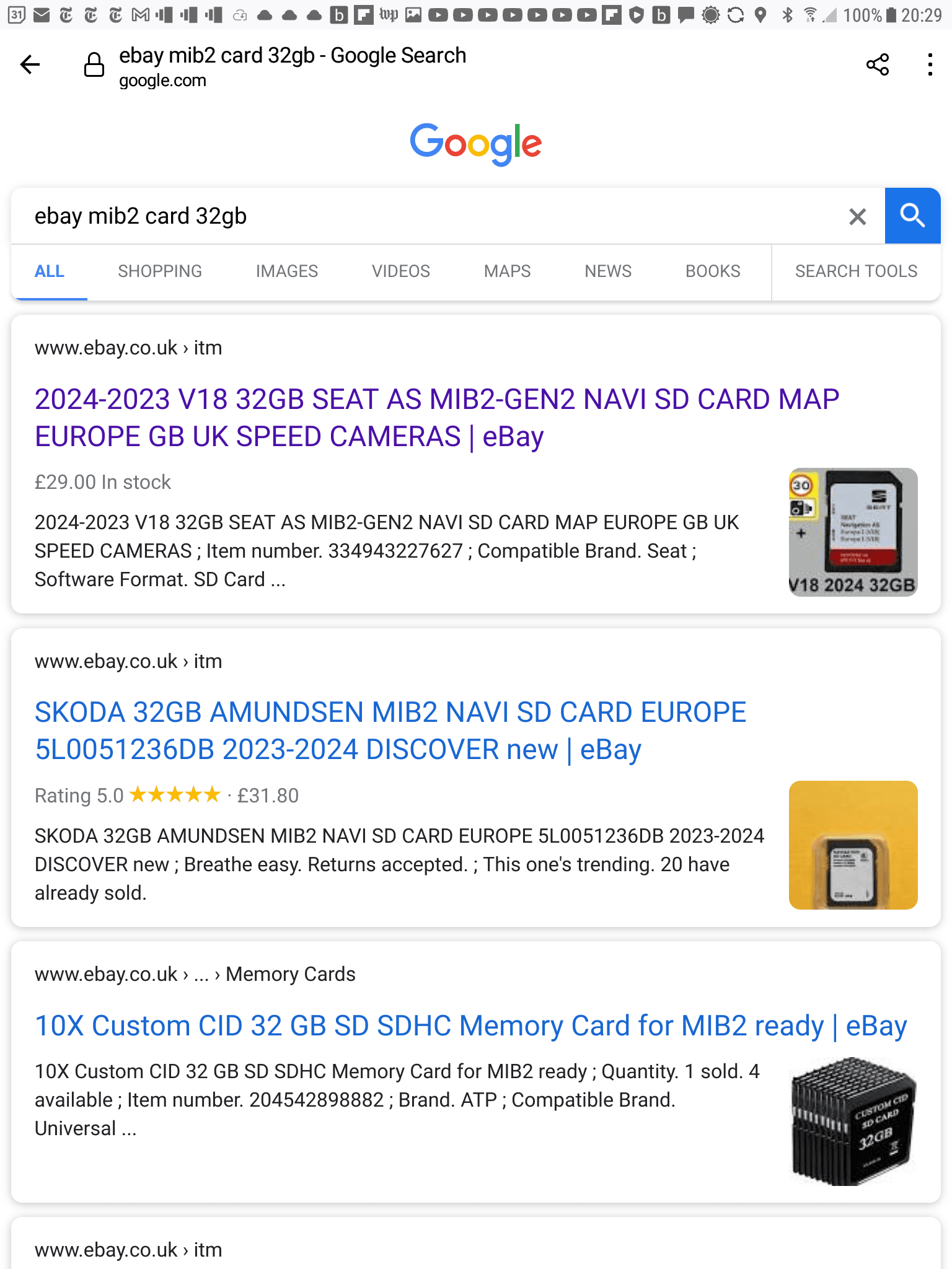

How to figure out the size of the cards that are for sale? (And that they have a suitable CID?)
I'd be happy (happier!) not to have to hack down to size of my MIB1.

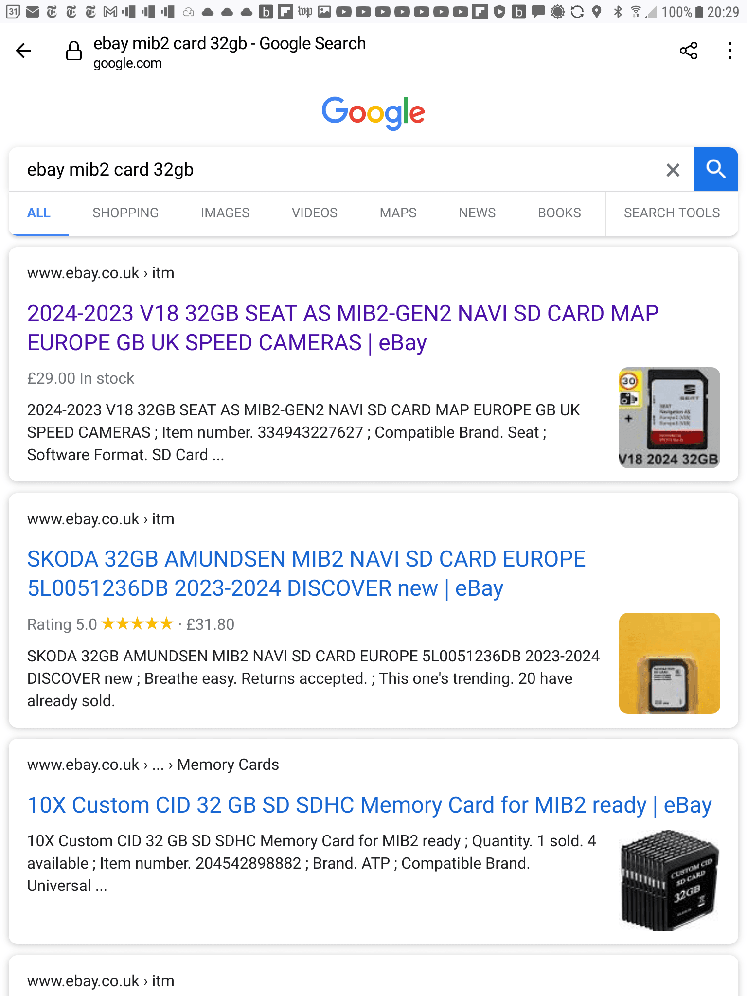

The mib2 one will be 16gb unless they sell them as 32gb.
Any of those you rate with a good customer satisfaction score and say mib2. You can use Skoda or VW as well. On the thread we did in the past verify that the CID was recognised by mib1 so you could put mib1 map files on a mib2 card and it worked but at that stage the wrinkle of upgrading mib1 wasn't known. I suspect the map file linked to has been adjusted to work across units or they didn't bother to enforce mapcare, not that it's specific to the firmware. You can pick up conversations on German forums about it.
If you fancied the 32gb card again any of these with a good customer rating that say mib2 32gb.
These would also be good for mib2 standard where of recent all of Europe doesn't fit on the card.
I've used a Skoda card off eBay and one with a writeable CID card where you clone your existing but a long winded process to do that. Costs more than just buying a Vag card. The CID is just a signature that the unit recognises as a Vag card.

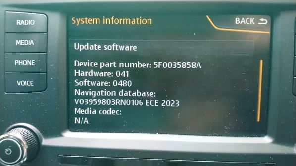

I managed to update our MIB1 Standard from 2014 maps to 2023 :cool: I found some info on a German forum. Here's what I did:
You might need to update your MIB1 to the latest firmware for it to work, I did it a couple of years ago. mib1_5F_480.rar [1.95 GB] (Spanish forum? I still have a Mega URL).
Backup original map SD to PC. [SEAT Navigation AT Europe (V4) 5F0.919.866.F] [4.46GB used of 7.48 GB]
Delete files on SD, probably best not to format it.
Download new map files, unzip on computer. P106_N60S3MIBS2_EU_NT (8V0060866S).7z [6.54 GB, 7.53GB EXPANDED ON PC] (mibsolution.one > Maps > MSTD)
Remove some files so it fits your SD, more than you expect due to cluster size? (Turkey, Ukraine etc). I ran out whilst copying, but I freed up 400 MB (just in case being completely full breaks the Sat Nav).
Change the following in the new DBInfo.txt (I didn't test if you could skip this step):
PartNumber1="V03959803RQ"
PartNumber="V03959803RQ"
TO
PartNumber1="V03959803RN"
PartNumber="V03959803RN"
Copy all to original SD.

Thank you for posting this. It prompted me to have a go and eventually succeed following some problems. First of all I decided to do the software update as my system was also on 425. I was not sure where to find the update file, so I eventually pad £20 for it from 'East Yorkshire Retrofit Solutions Ltd'. The download they provided was copied straight onto an old SD card and the upgrade went without problem. It takes at least half an hour but less than an hour. One additional thing they provide is instructions for OBDeleven which allows you to clear a fault that will show because of a software mismatch. It involves reading a string, entering it in a web site they gave and then programming the result back into the system. This is optional and apparently does not stop the upgrade working. So far I have not noticed any changes other than having to increase the screen brightness (it was on darkest before).
For the map update, I decided to buy a MIB2 V3 card from Ebay for £12 including postage. By the time it arrived I had downloaded the map update from mibsolution.one. I erased the files on the 'new' 16GB card then made my mistake. I used 7ZIP to expand the archive directly onto the SD card (don't do this!). Next I edited the DBInfo.txt file on the SD card to the PartNumber entries above and saved it back to the card. The result was that the system showed the message 'Please insert a data medium with valid navigation data'. No amount of rebooting helped. With more messing about with the DBInfo.txt file I ended up with the 'Checking navigation data...' message stuck on screen. What sorted it was when I created a temporary folder on my PC, expanded the files into that with 7ZIP, edited the DBInfo.txt file in that folder to the entries above and then copied the whole lot onto the SD card. Then the system accepted it. The 16Gb card of course takes the full map set with no need to delete anything.
To answer another question from @Tell, the RDS TMC live traffic is still working with the new map and traffic code group 14 :)

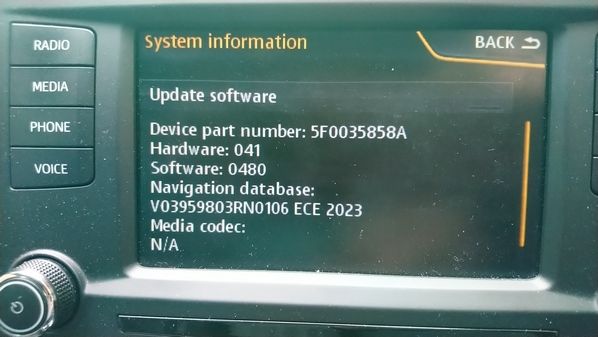

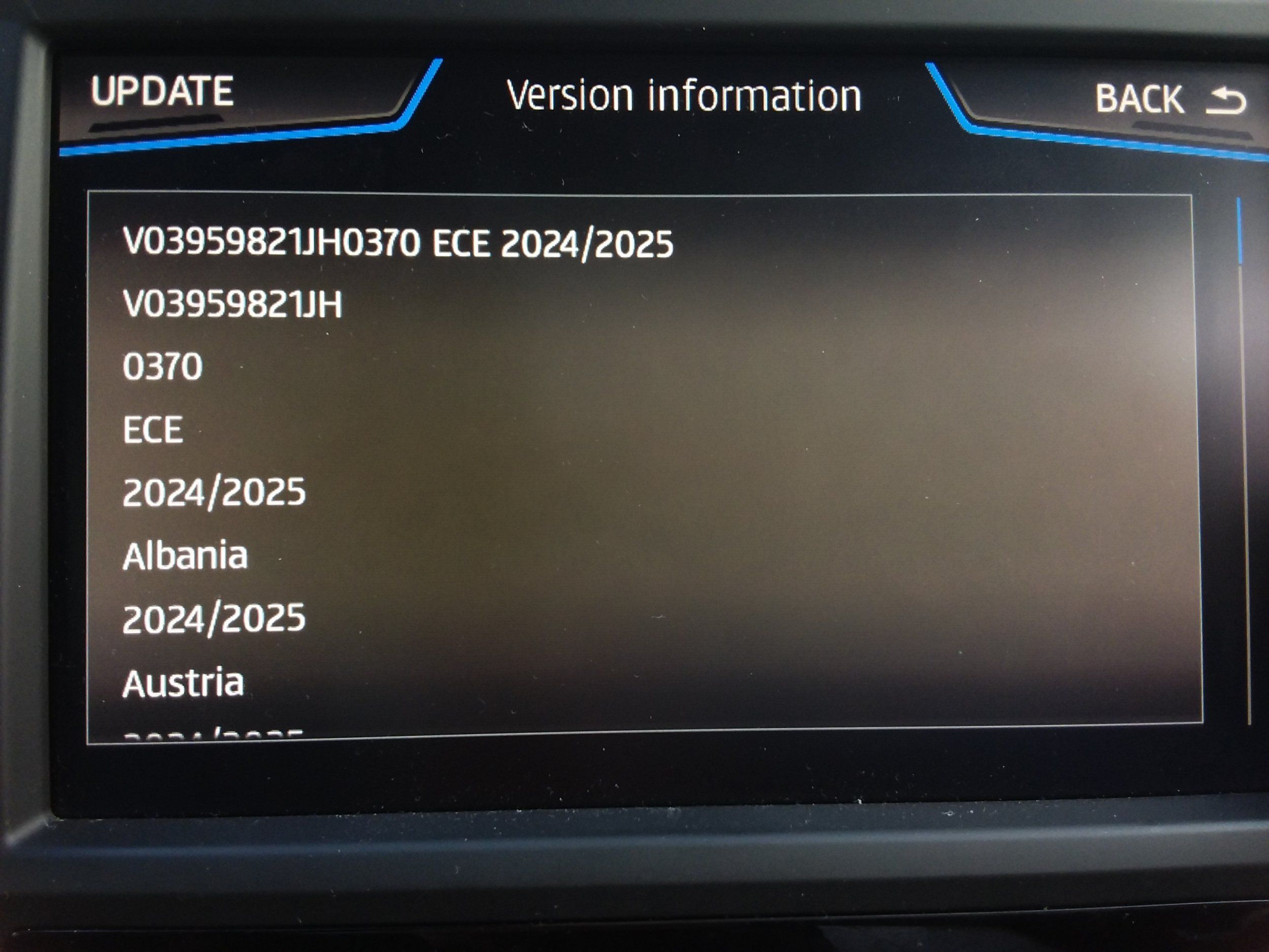

For those that can't wait till June 2024 for mib2 high maps, 2024-2025, a walk on the wild side is available. You do need the Seat life long map FeCs. See the resource about getting them.
The file is the Audi version of the mib2 high which is slimmer than the combined mib1 / 2 file. I used this for version 350. No issues. Audi have always released the file in the combined file and split into mib2 and mib1. We use the mib2 high only one.
It would appear that due to mib3 connect services where monthly updates are generated from source cartography, applying this streamlining to mib2 high means rapid production from the normal freeze date six months before distribution, gives us the files early. My theory.
The files turned up for the EU and Americas only Tuesday / Wednesday of this week.
370 EU 2024-2025.
376 Americas Only 2024-2025.
The both files are available on
login guest, guest
The 370 file that I used came from this site using the mega link
I have not tested the mibsolution.one version for Europe... too slow to download.
If mega times out using a vpn change your IP address and hit refresh. I use Edge for this process.
There is also the 370 map on Google drive link that is said to work:
Drive
Choice of three links for 370. (Thank BooBoo124 on Briskoda for two of them, an Audi driver used the Google drive link, I used the Russian link - those two we know are fine and work). The Google drive one is the easier if access isn't being rationed, failing that mega with the vpn trick and mibsolution.one slower (that one I found problematic). I've checked checked the Russian link I used and the Google Drive link the contents are identical after I remove the two Russian files that don't have a bearing.
The one posted as 376 on Mibsolutions is Americas only and will not cover Australia and New Zealand from the content.
The link for that one is which downloaded better than indirectly via Mibsolutions:
https://mega.nz/file/SEhSCZTA#T8qGZbNC45wEFu0wf36clM3NVP84VDv_UjZ5dUWmur0
Back to the 370 file European file, I used the Russian website to these files. The Google drive one can be used as an alternative and you don't have to play with Mega and a VPN to get the file out.
The one I used, direct link to the file (no Russian or Chrome translation required):
Or the the one flagged up as Drive above.
(the Google drive one and mibsolution is the original with creation dates at the time circa November 2023 inline with freeze dates for the June 2024 release, Russian one had been unzipped and zipped back up with two promotional files)
Since the files are SLA1 signed it is impossible to edit the subdirectories, on this basis the files have not been messed or tampered about with from production, they wouldn't linstall if they had. They are as run off the map production line for Vag. We can assume they aren't beta. There is 0.2gb more in this file than 350. Checking geography, additional roads are present so it is an update.
You just need to get them unzipped and in the root directory on an SD card (or USB) as normal. Distribution may have them set down a level. Metafile in the root, mib1 and mib2 are subdirectories of the root. You do need both. Note the normal Mac instructions of CleanMyDrive. See resource tabbed under Overview. TMC Inrix works as per normal with the code change. Latest maps ✔.
