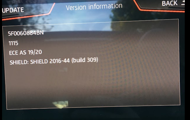

Yet to appear on Seat servers. It will all be the same file !. Skoda and VW the servers still showing the old November 1115 standard release although Skoda now has the equivalent all of Europe VW release. One can expect Seat will release the same at some stage.
Anyhow no problems on the high unit:
