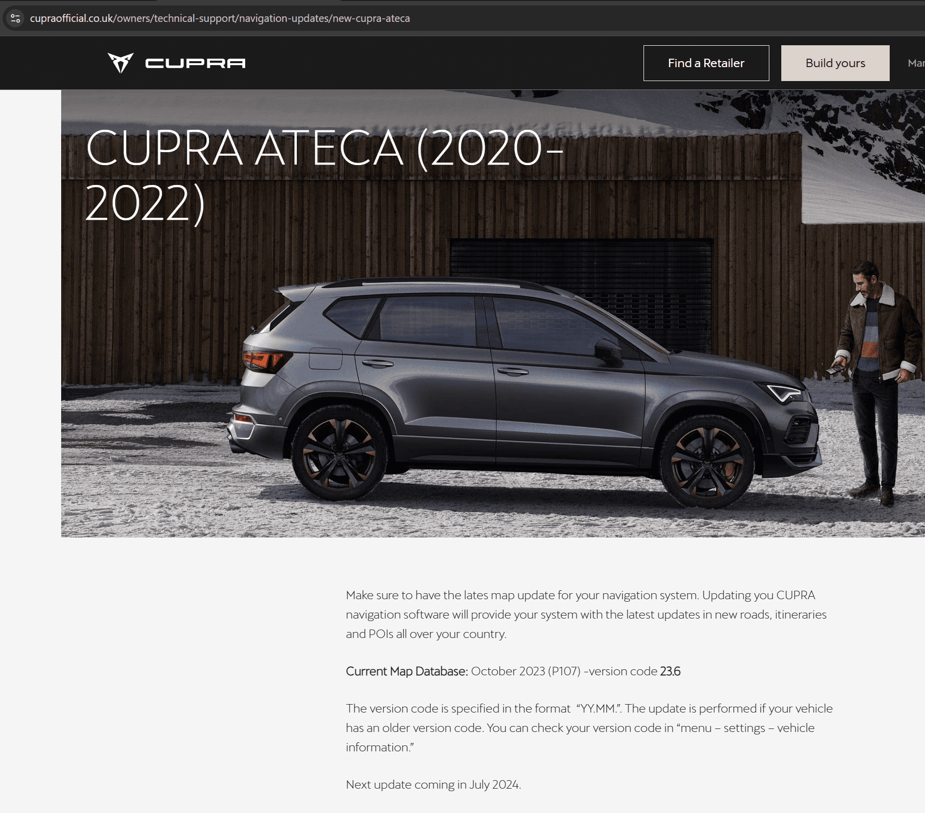

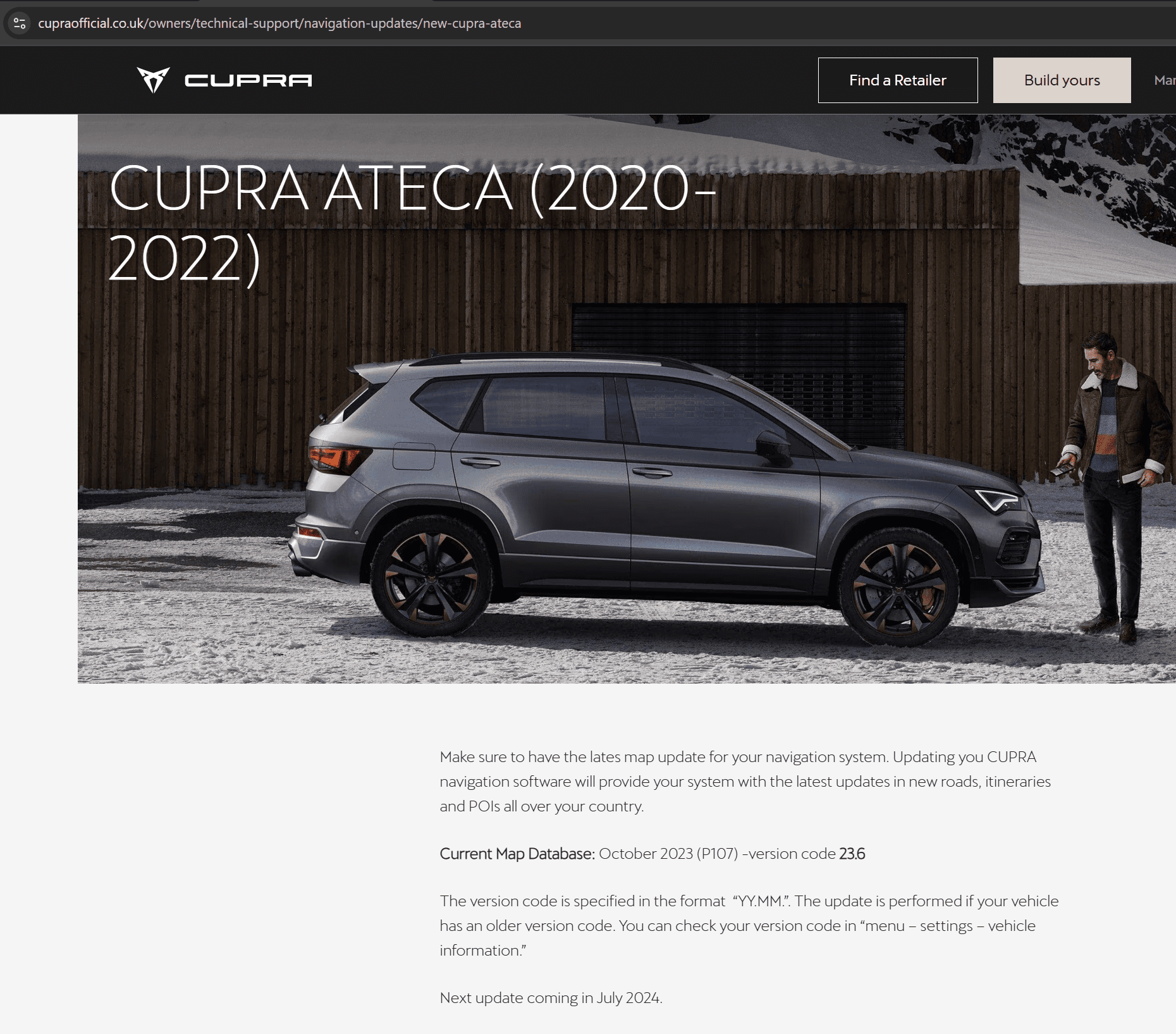

I just wondered where SEAT/CUPRA web pages currently are in terms of navigation updates.
It's sad to see that those pages last updated on 2023.
I'm on version 25.2 in my car, CUPRA says current version is 23.6.
Not just Ateca, it's the same for all models, and same for SEAT models too.
Is it really this hard to keep this up to date, I mean in this time and age of "connected" cars ?
I dare say quit offering built-in navigation if you can't keep up.
It's really pathetic.
