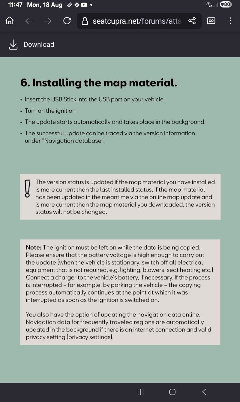

When you update the map, you don't need to do anything no service menu, nothing. Just leave the stick in the port and drive around. The car will do the update automatically as long as it's the newest version.

So if I understand correctly. I just plug the pendrive into the USB port and in the closed yard every 15 minutes after turning on the ignition, it updates itself? do I not have to start the update from the service menu?

That is 6 of the PDF I showed on post 1 of the thread. The third pdf. All brands are the same.
But I've also recommend the old mib2 high trick that I use. Basically once it starts off the update will run on for 20 minutes after the ignition is turned off. So if you do a short journey the update may not finish. You can frig that by keeping the door open, or opening it every 15 minutes. 5 minute buffer. That's just a trick to get it all done rather than waiting. It's got a roll back and resume function built into the update the same as mib2 highs. The sum total of ignition on and those 20 minute periods after ignition is turned off sums to what it needs. Including the roll back ?. Its the roll back you frig to get it done quicker.
People like usbs with the flickering light to show data activity. Its been found that when it does show the map updated the flickering still continues. This may be a function that the maps are fragmented into parts so whilst you got your locality the others are still being installed. If you got one that flickers best to leave it in till it finishes flickering...

There is no flashing pendrive, how long does it usually take? I'll get to it today, just so I know how many times I should go out to turn it on every 15 minutes.
They say 40 minutes. But 2 hours should do it. Why its said put the pen in and leave it there. Will vary on the speed of the USB as well.
The issue is where the unzip isnt correct, not placed correctly etc so you never know what's happening why they like like pen drives with LEDs. Is it sitting there and do nothing is resolved.
