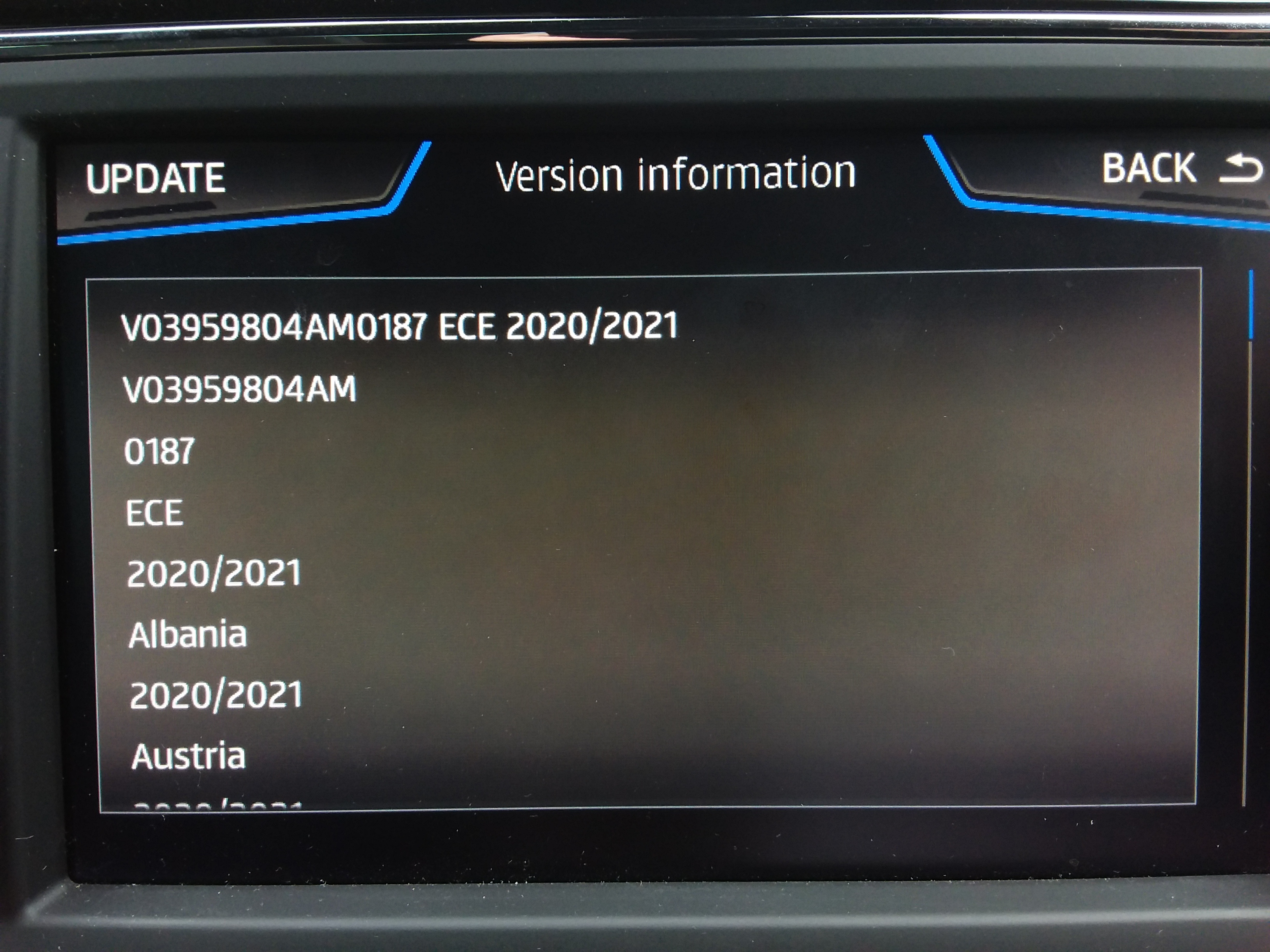

It's the standard Seat map test:
Please follow these steps to check your SEAT Ateca Navigation System: Press the “NAV” Button > Confirm the “Setup” > “Version information” selection on the display.
Check the first text line in "Version information". If the first three digits are 6P0, your system version is the "Navi System - 6P0". If not, your system is the "Navi System Plus".
Then under that you should see your version number. The screen will look a lot like the one I posted above, yours won't say 6P that's a standard, 5F is a mib1 standard. Mine is 0187 as above.

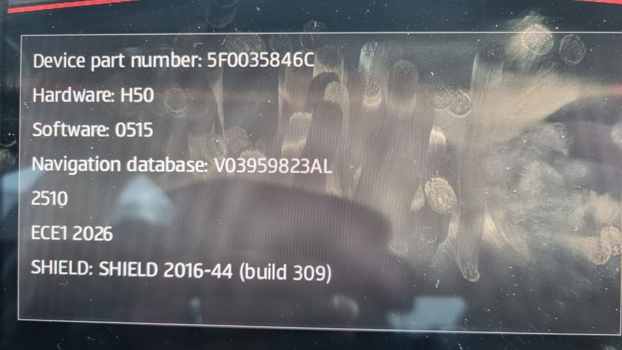

Hi.
I am thinking in updating my maps, if possible but I'm still not sure if it is safe how to do it! I have the original Seat SD card and I have already made an update a couple of years ago, but I don't remember if I only updated MiB2 or if I updated the maps themselves!
The infotainment says numbers like these:
Installed SW Train:MST2_EU_SE_ZR_P0515T
Installed SW MU version: 515
Current Version: MST2_EU_SE_ZR_P0515T (0515)
Update: MST2_EU_SE_ZR_P0515T (0515-1)
Update: MST2_EU_SE_ZR_P0514T (0514-2)
HMI Software: H29.344.66_STD2Nav_EU
Model: GuideModel_29.344.12
Software Base: H29.344.66-201906171929
CGRun Number: H29.344.66-201906171931_STD2Nav_EU_201906172015
Part Number: 5F0035846C
Hardware Version: 5F0035846C
Software Version: H29.344.66_STD2Nav_EU
Can I simply copy the folder `maps` into the root of the sd card and get away with it?
No you need the "workaround". Something new, something old as they say on wedding dresses or something. Read from workaround.
You need the overall.nds file you existing card. That is copied as directed onto the map update. It then thinks you haven't updated the map, but you have. Some bright spark back in 2017 cracked it here and its used across all Seat boards. Fear not if you do loose the original overall.nds file the solution is given on the resource.
The main thing for you if you dont have a Seat 32gb card you have to pick one of the zones. Reason the details within the maps out grew the original design spec. If you want all of Europe then you can buy a Vag 32gb card of ebay say, repeat the process.
So its nearly "simply" but you must do that copy steps:

Ok, I tried once and it didn't work. I copied all overall.nds files from all folders. I'm now restoring an image I created before. I mean, before I started, I created an image of the SD card, so I have an .img file. I'm using Debian. No Windows or Mac.
This time, I'll copy only the mentioned file instead of them all. I'll download the file from Skoda servers also, this time! Will update here after I try again!
