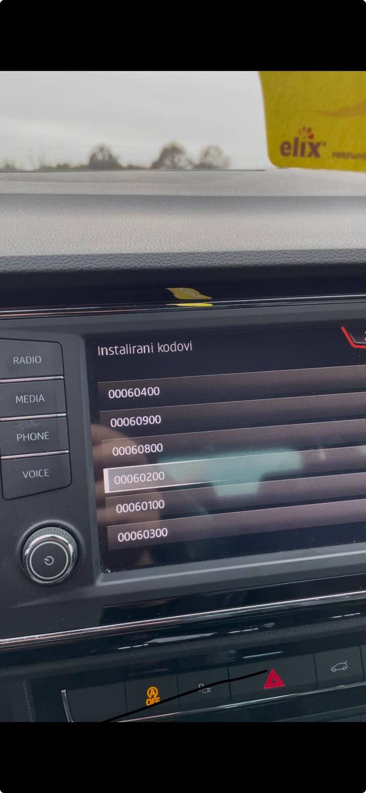

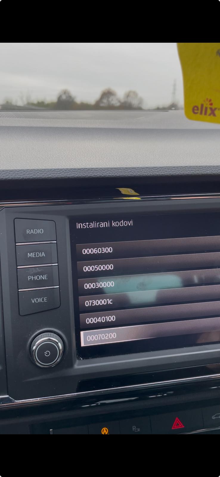

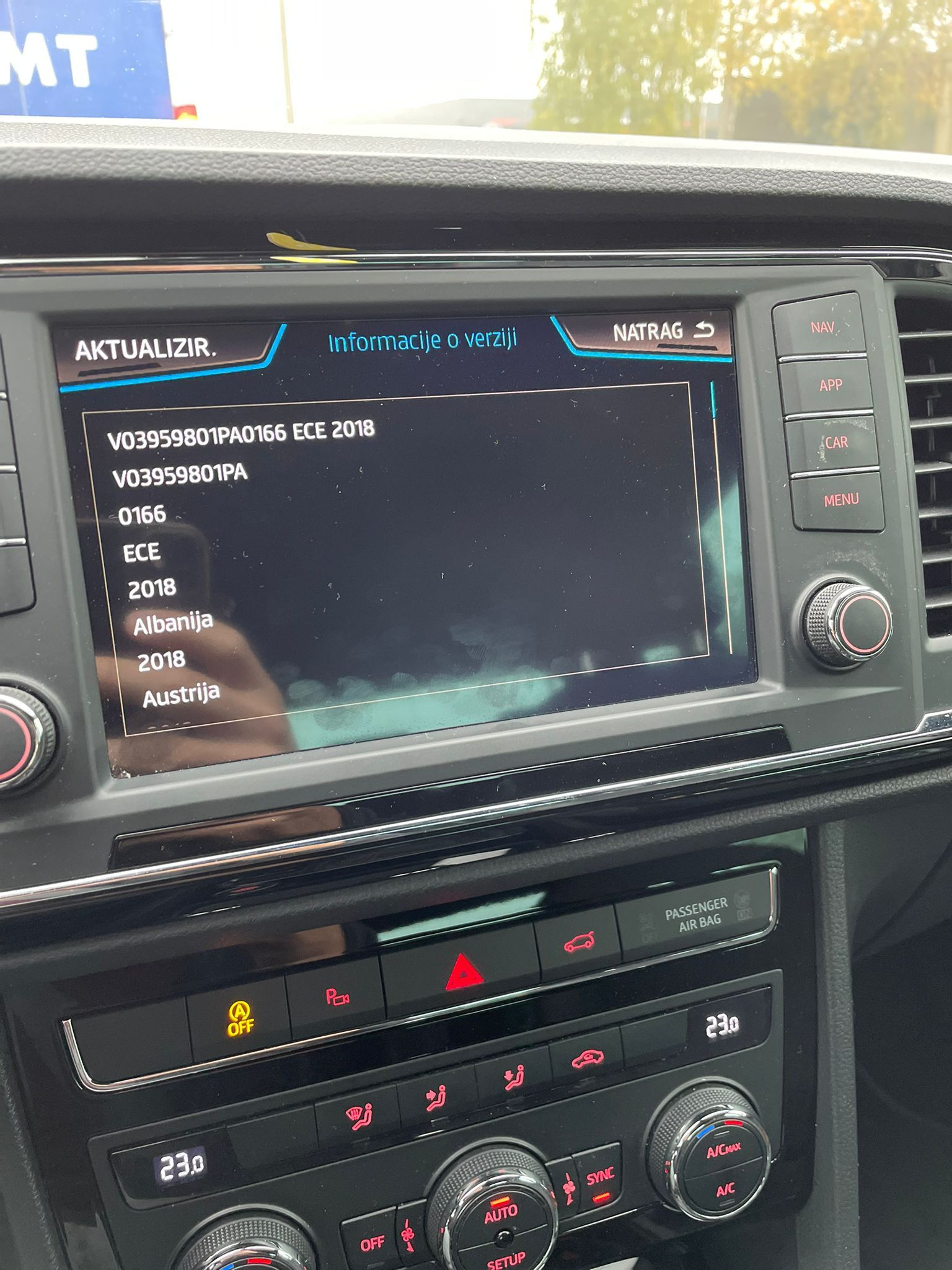

Hi, all. Last month i buy Ateca FR 2018. I mannaged to update the software to the latest version MHI2_ER_SEG11_P4709 but ti cannot/dont know how to update maps.I have maps installed on my device, i dont have sd card. I downloaded the latest version of the maps P390_N60S5MIBH3_EU. The sistem says that the update of the maps are found but it dont update the maps. Can somebody please help me how to do it? Maybe my FEC dont allowing me, or am i downloading the wrong version of the maps? Thanks for your help in advance.

Yes you have the FeC ending with 1c in the picture which from the table in the resource leaves you short by a number of years. It tallies with the age of the car. I constructed this table when it became apparent that one London based retrofitter was selling firmware updates short of lifelong FeCs. Lifelong they finish with ee.

This is from the resource:
There are two DIY solutions available
- update your firmware to 1447 AIO - the AIO stands for all in one and gives you the FeC upgrade
- Mib2 high toolkit
The toolkit did only work with specific firmware releases. You'd have to read up. Someone on the board helpfully wrote the module for mine at the time. This may have changed. The toolkit uses the green menu to interface with the unit to write the FeCs. At the time 1447 was being pushed to me as a solution. Now the 1447AIO is more integrated and has been happily used by a number of people. It is forward compatible with old units but yours isn't so old.
The section in the linked resource starting with the text covers this "Mib2 High / Seat Plus Map Update"
My experience with the Mib2 high toolbox is here:
I think now it's just easier to update to 1447AIO but if your firmware is on the tool box list then that's an option
This is the toolbox it's a Github project denoted by Mr MIBonk
So that's option 2.
Option 1 1447 AIO which is the preferred option by many has it's own thread:
Either will work... 1 more than 2 if the module hasn't been written yet. You can cross check or just move onto 1447... on auto pilot at the minute... looking at the code of your firmware you are on 1447 at the minute I reckon so you just need to leap onto 1447AIO unless you fancy the toolkit solution. That's been written. At the time when the experts were badgering me to move to 1447 and then use the Mib2 Toolkit, the AIO had not been written. Either should work for you. In the end a kind soul wrote the missing bit of code for me to stay on the firmware. IFS root patch.
