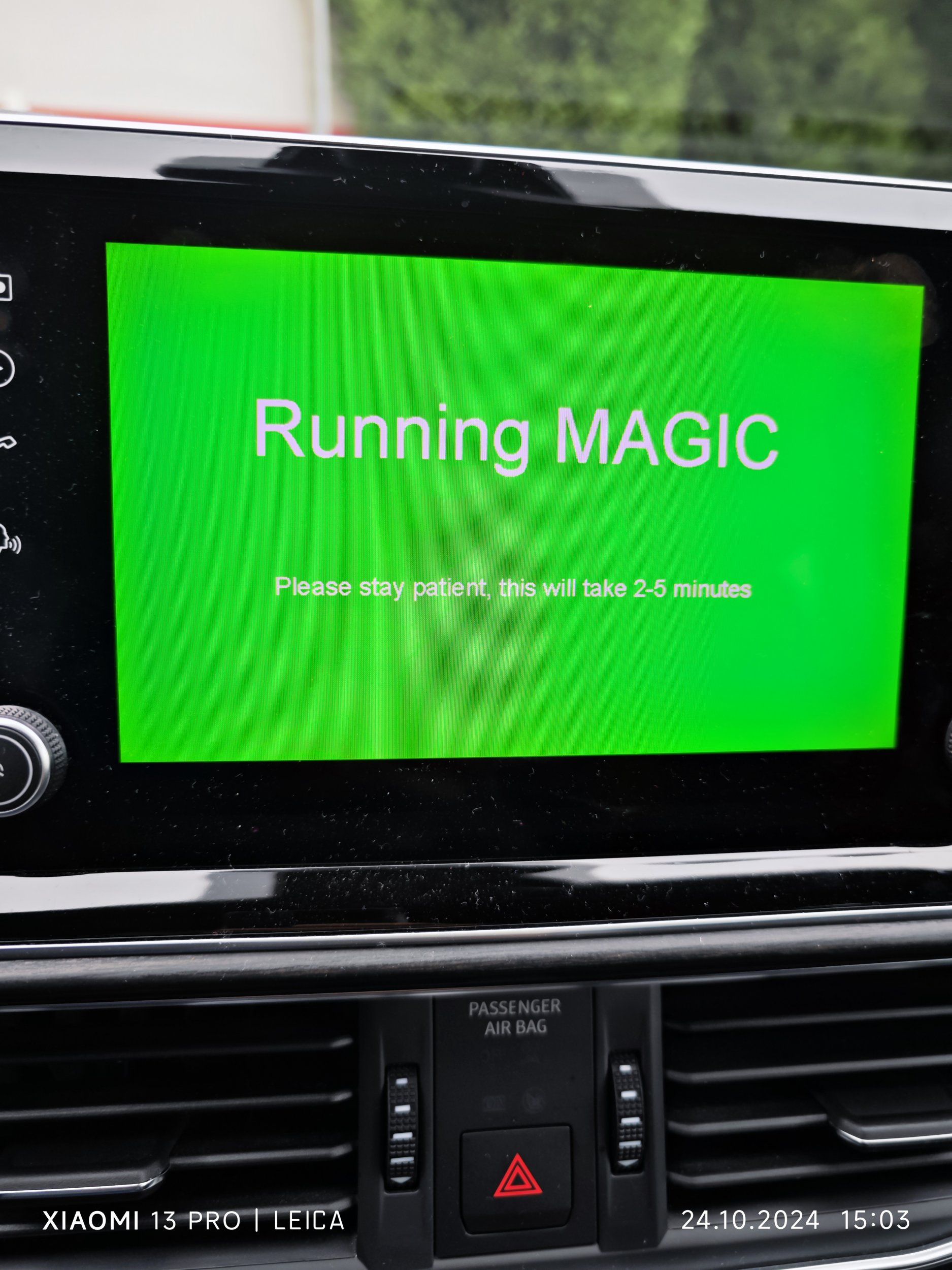

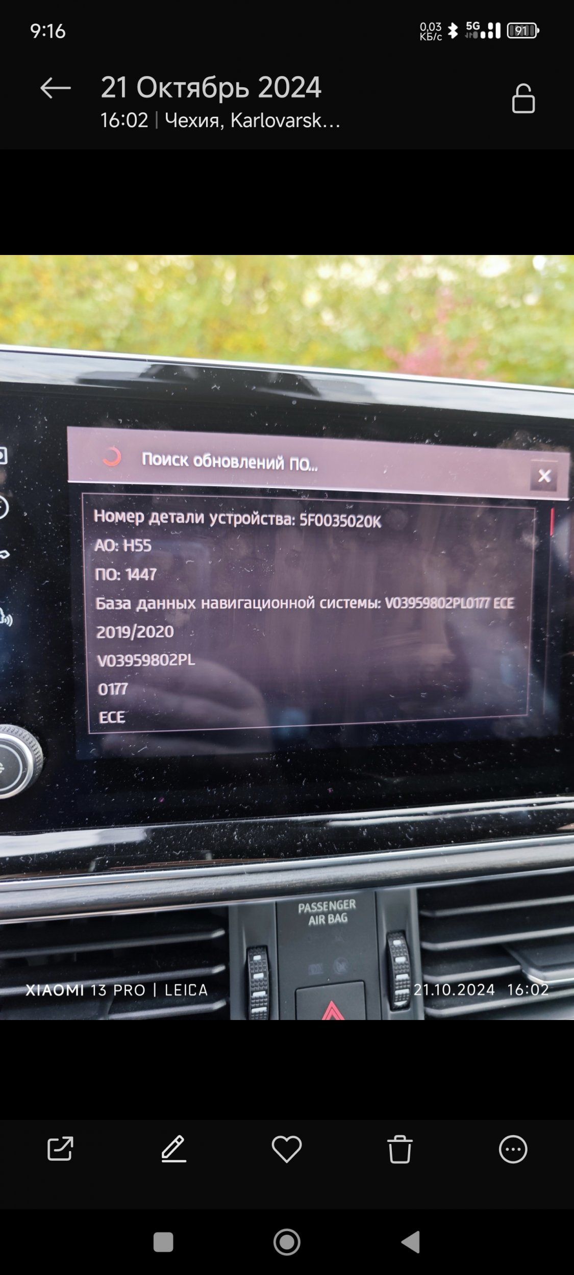

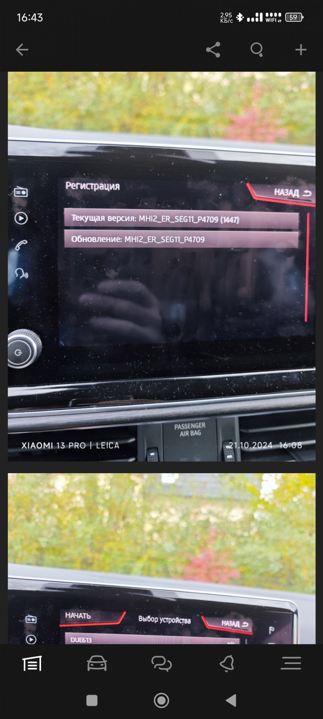

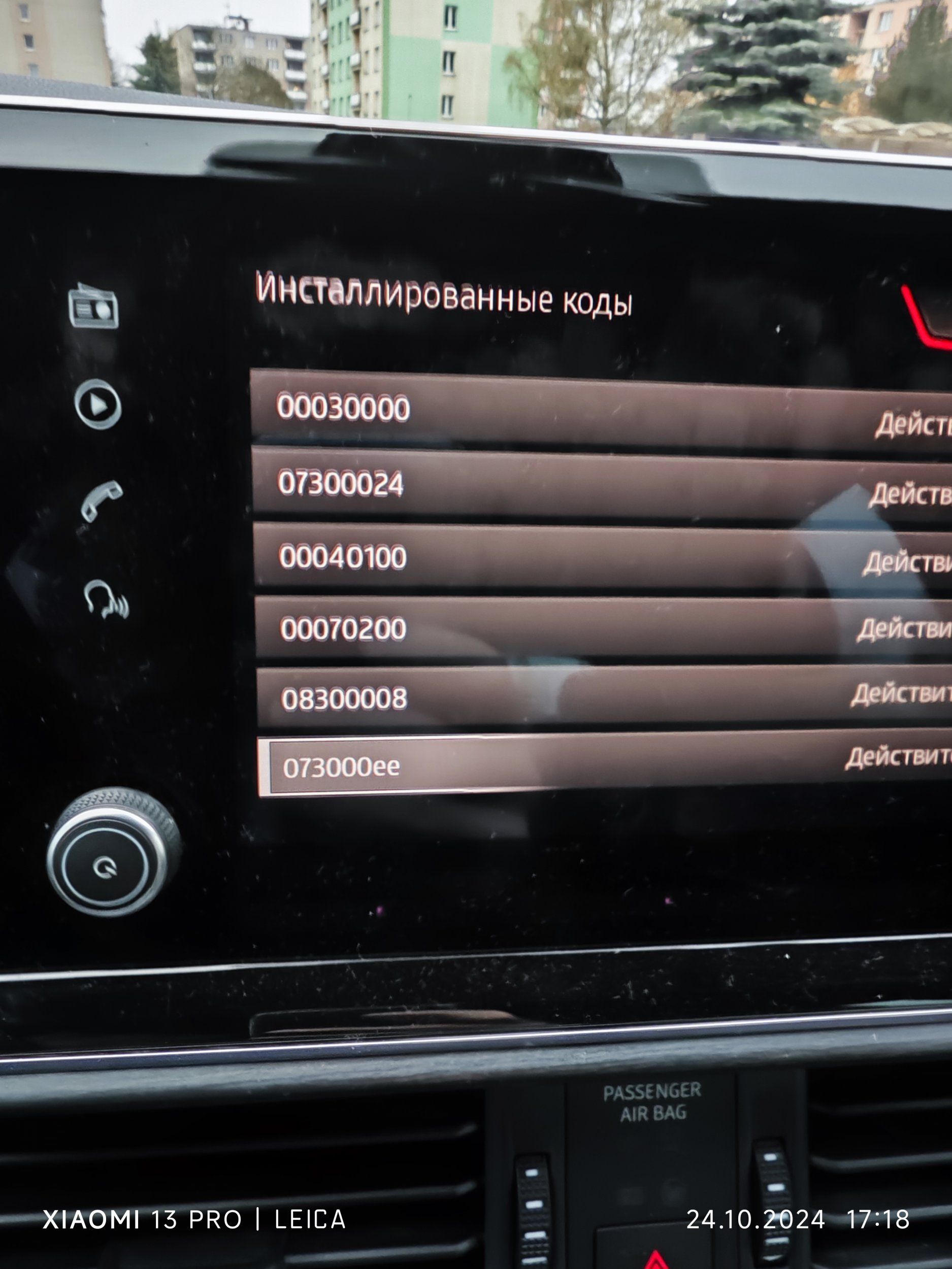

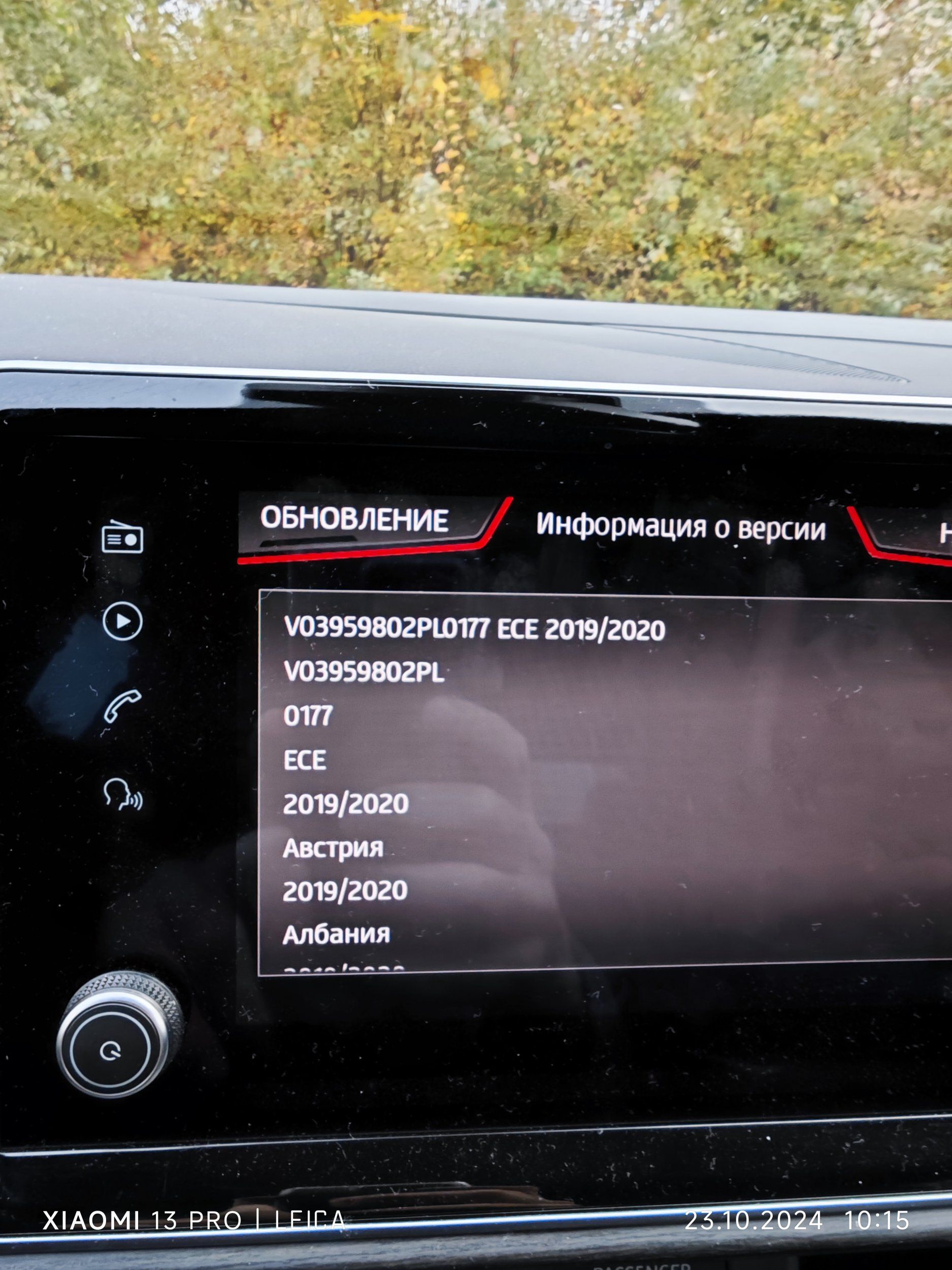

Hello everyone, I need help.I have Seat Navi plus ,installed maps on the disk inside, no memory cards, but there are slots. After installing M.I.B., the menu is green, all navigation maps disappeared, and the patch was not applied, because I forgot to copy it to the patches folder. Later, I copied the patch and it was applied, but there are no maps. Will reinstalling the maps help me or do I need to return everything to its original state?

I just read that I need an old SD card with maps so that my MIB2 high can get the overall.nds file, is this true or will the regular maps from the Seat website be installed? I already have a USB with the maps written to it, I didn't have time to install them, but I checked them in Mib2 high beforehand and there was Y everywhere.
That's is a mib2 high from the screens, map release 177 etc. So no you don't need a special SD card. A Seat Plus is a mib2 high. Basically whatever you have done to the unit it should look like the normal screens, radio etc. With no maps you would see just a blank navigation screen. If it looks like that, no funny screens and everything else is working. I see you got a navigation FeC there then it's just a question of presenting the maps correctly. It can be very fussy since it does an SLA1 signature check and will fail if the maps aren't a clean download. Unzipped 7zip, safest as recommended. You don't need Seat maps. The Vag mib2 high maps will do. That 370 release I posted up. 390 I'm about to post up later today.
However if the unit coming out of whatever you did with "M.I.B" doesn't look like a mib2 high screens as before, normal operation of the buttons then it's something other than this thread you need the firmware thread.

Спасибо всем кто помог, карты установились. Все работает. Все отлично, как появится версия 390, обязательно скачаю и установлю.

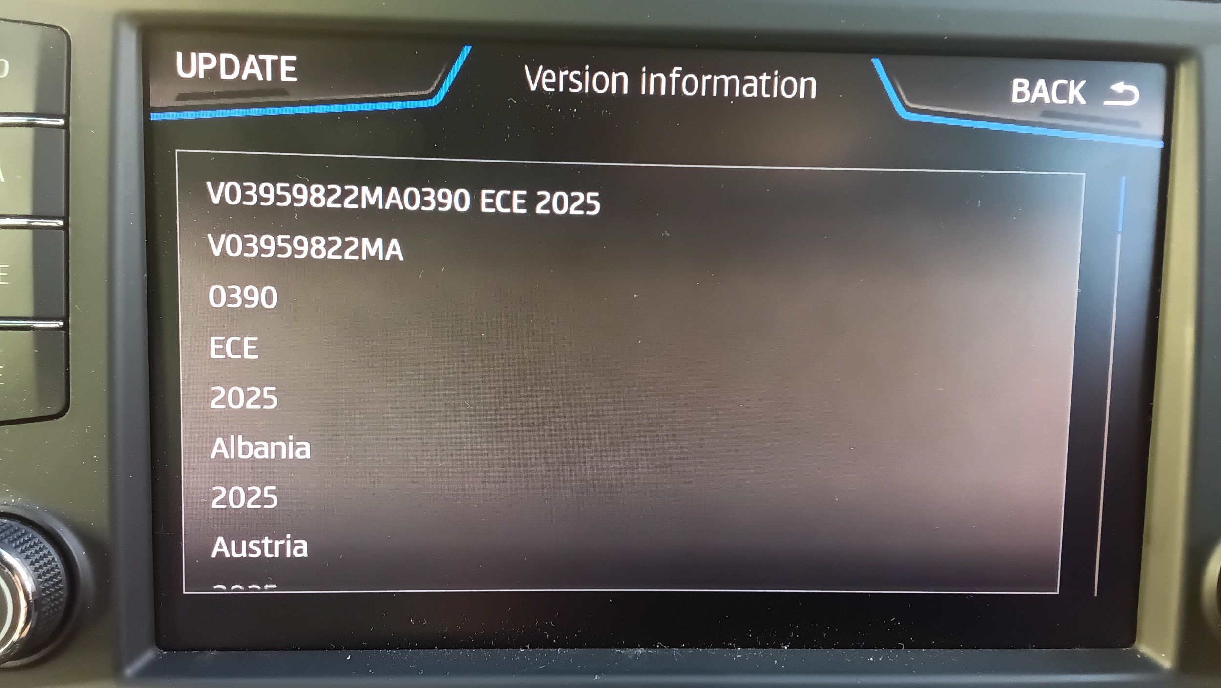

390 Success screen:
