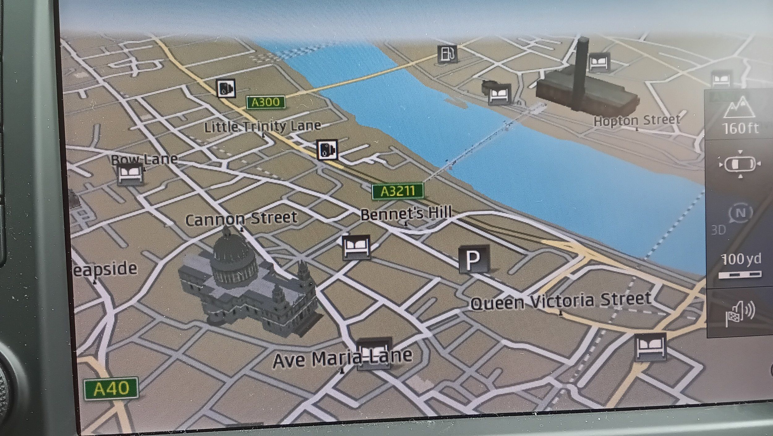

Audi 370

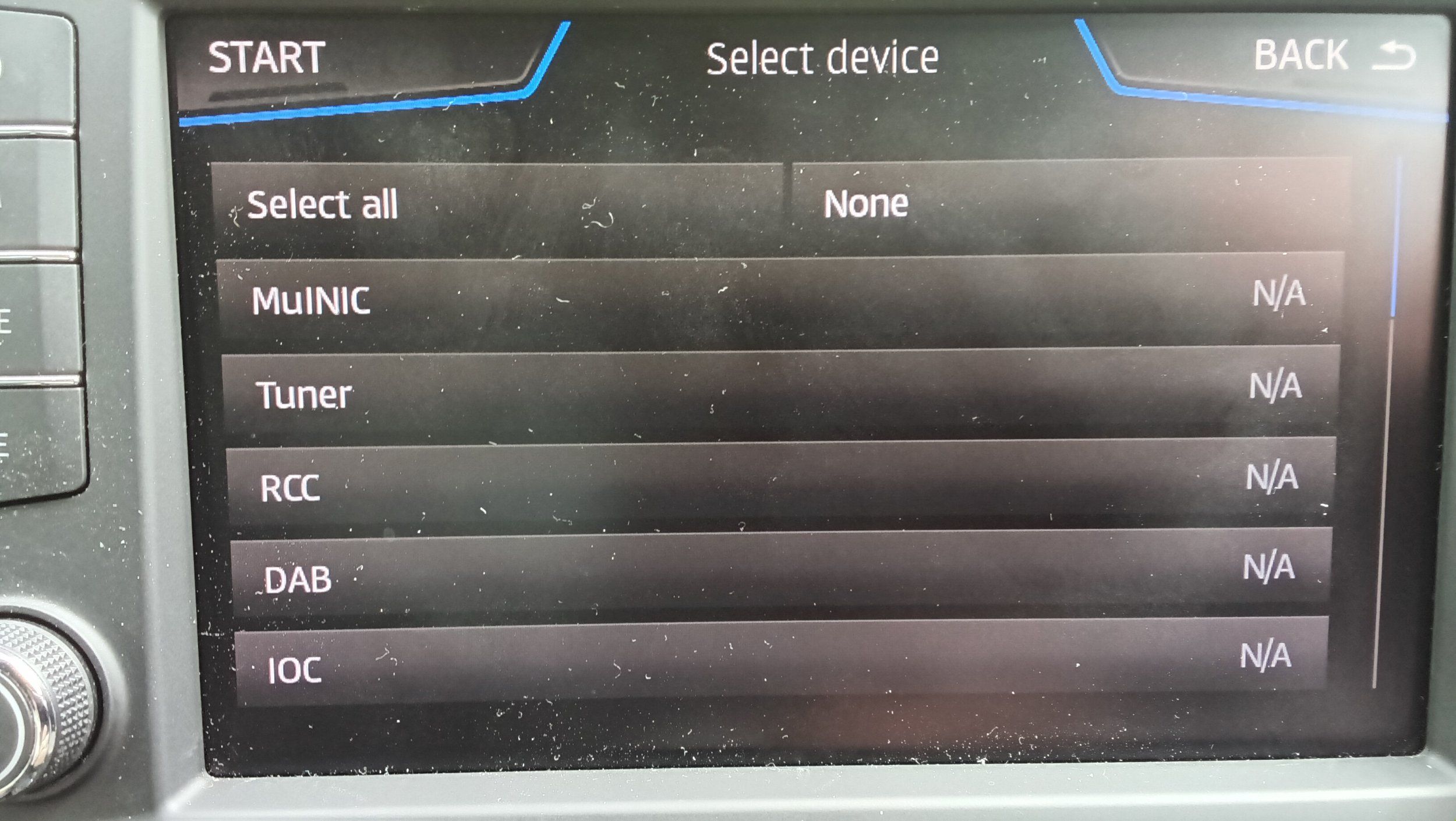

How to nudge it up to VW if on Audi 370. St Paul's and Tate Modern in the Audi 370 file. So 3D was in it.
Swdl update all using manual method (manual download and press start), Select All and Start with the VW 370 upload if you Audi 370 in it and want to overwite with VW 370.
Will edit for each stage. Now a forced update of Audi 370 to VW 370. 40 minutes running.

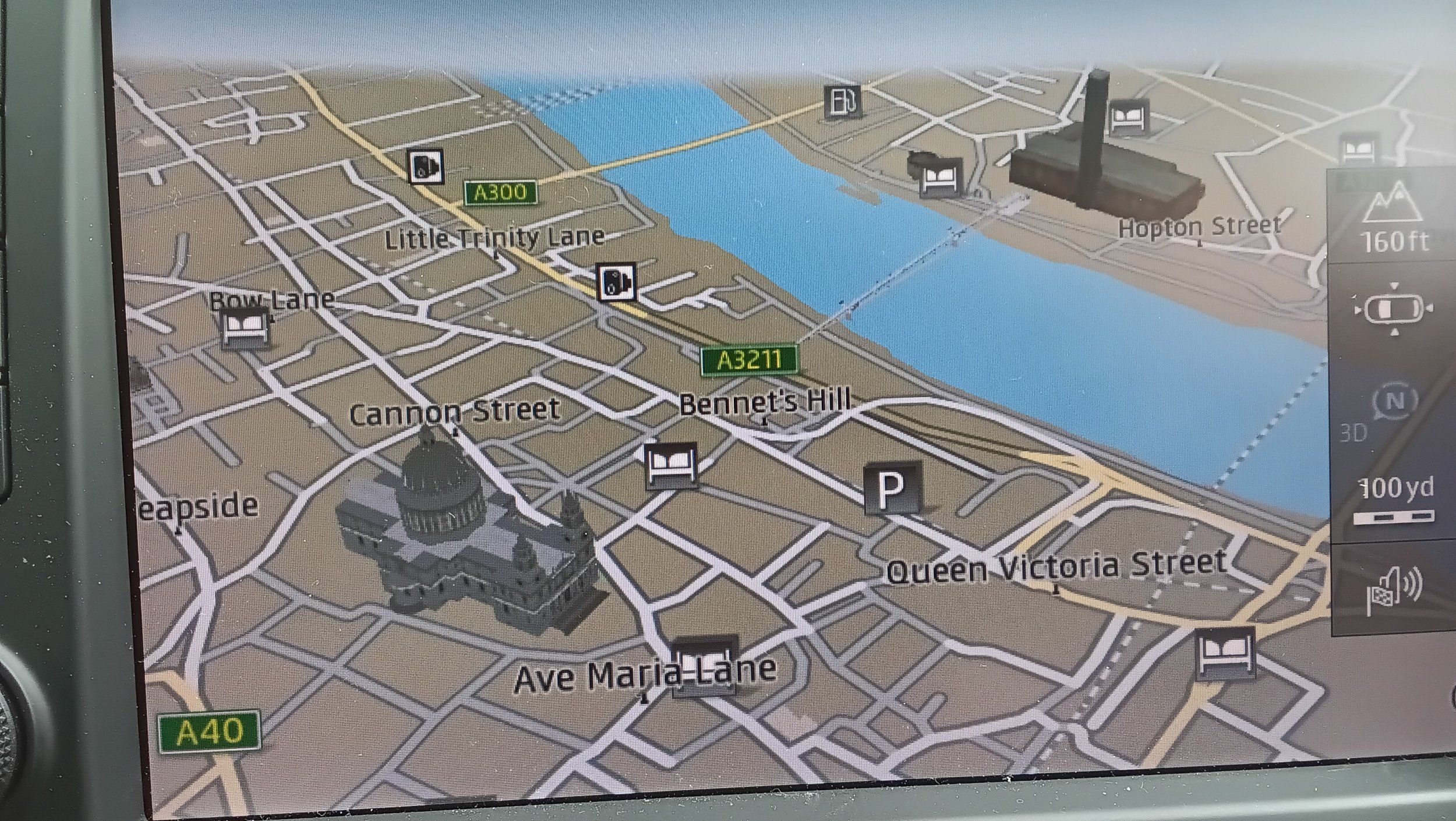

And successfully updated to VW 370 (same release as the Audi one) & 3D the same as before.
Picture soon.
So yes identical, but I put it through completely rather than say I've done file comparisons. It's available to use if your got the navigation FeCs.
