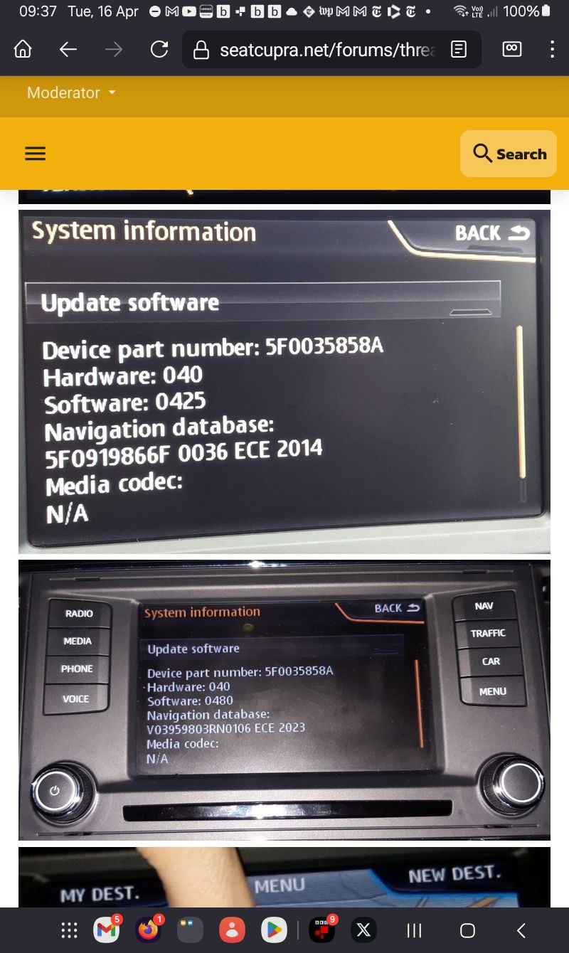

Basically looking at Daz3d screens above the old maps had the 5F part number in it. New maps swapped to an Audi part number.
The instruction was
Change the following in the new DBInfo.txt (I didn't test if you could skip this step):
PartNumber1="V03959803RQ"
PartNumber="V03959803RQ"
TO
PartNumber1="V03959803RN"
PartNumber="V03959803RN"
I'm assuming you can see those V codes in your original file... probably not ?. If you can take the V code and use that.

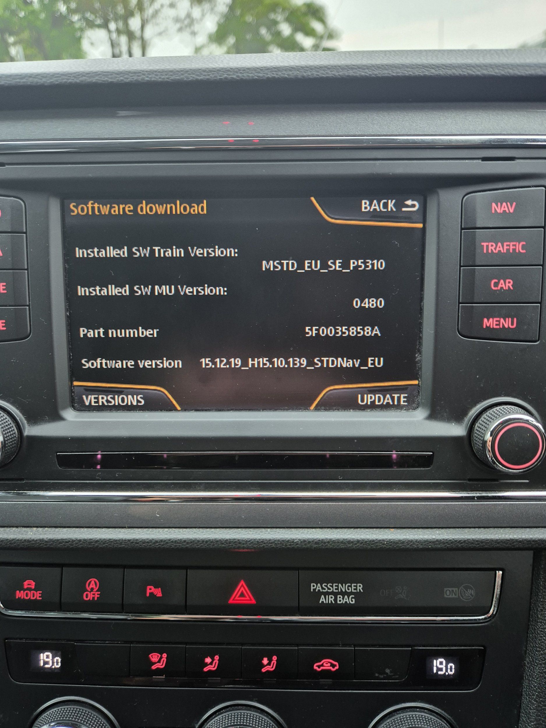

It's probably that the firmware in the "final" release of mib1 makes it happen, release 480 so it works. The release could have fallen into the domain when Seat ceased Mapcare aka made it free which was 2019/2020. That might be why it works.
This is they, use Chrome to download it and login in as guest, guest
It is signed so to me it hasn't been modified. If others with 480 can check this is the version. That would be useful.
Note this text that our friend kindly provided:
"If you're updating from a very early software version, you may need to change the byte 17/18 of the long coding to 01 or the unit will sit on the boot screen and appear broken and unusable. Please do not update if you have no way of carrying out this coding."
So if this is the 480 software laying on mibsolutions and you got old firmware then you may have to do that code change on the long string.
I think these are all the ingredients to make it work.

The firmware can be installed by USB or just a plain old SD card. Presentation is important. Unpack and stick it in the route directory. Don't have anything else on the SD card or USB just the firmware.
It's the East Yorkshire text I quoted above off their site for 480, what it means is there is a chance you need to do that else your unit will hang. Obdeleven Pro you work your way across the string, inspect. If like mib2 it will be your 5f unit, either way it's your infotainment unit. What it means in reality is check that string before you load 480. Adjust if required and then load 480 or perhaps before that fit a long press reboot to check it boots OK after the adjustment then do the 480 update. VCDS tools etc could be used alternatively.
Text:
So that pretty important. Now if your firmware at the minute was the same as the other people on the thread and they got away without it you'd fine. Perhaps they might say. Think @Daz3d shown in the before and after image.
Yes he went from 425 to 480 from picture. So I guess no coding was involved @Daz3d.

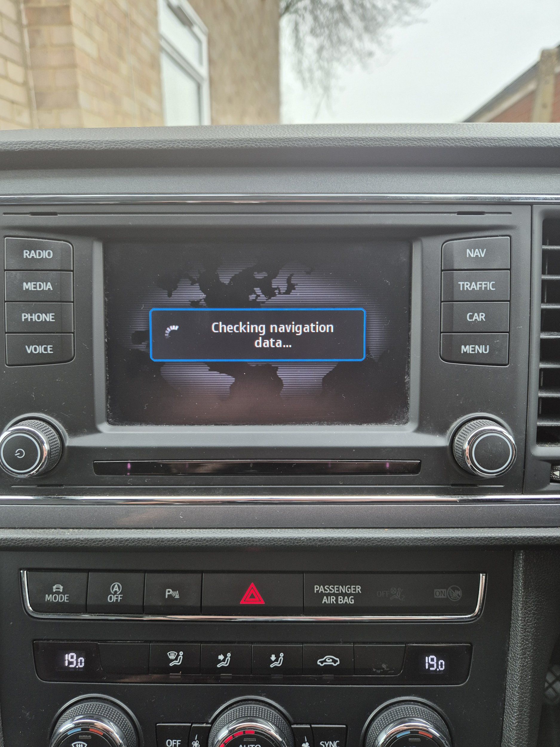

So, updated the firmware fine. A message came up but assume that's the error message that just gets cleared.
Now I put the SD card with new maps (changed the text as mentioned) in after changing the file names and just get the 'checking navigation data' message.
Not a clue where I've gone wrong tbh. Unit works fine bar this message on navigation.
