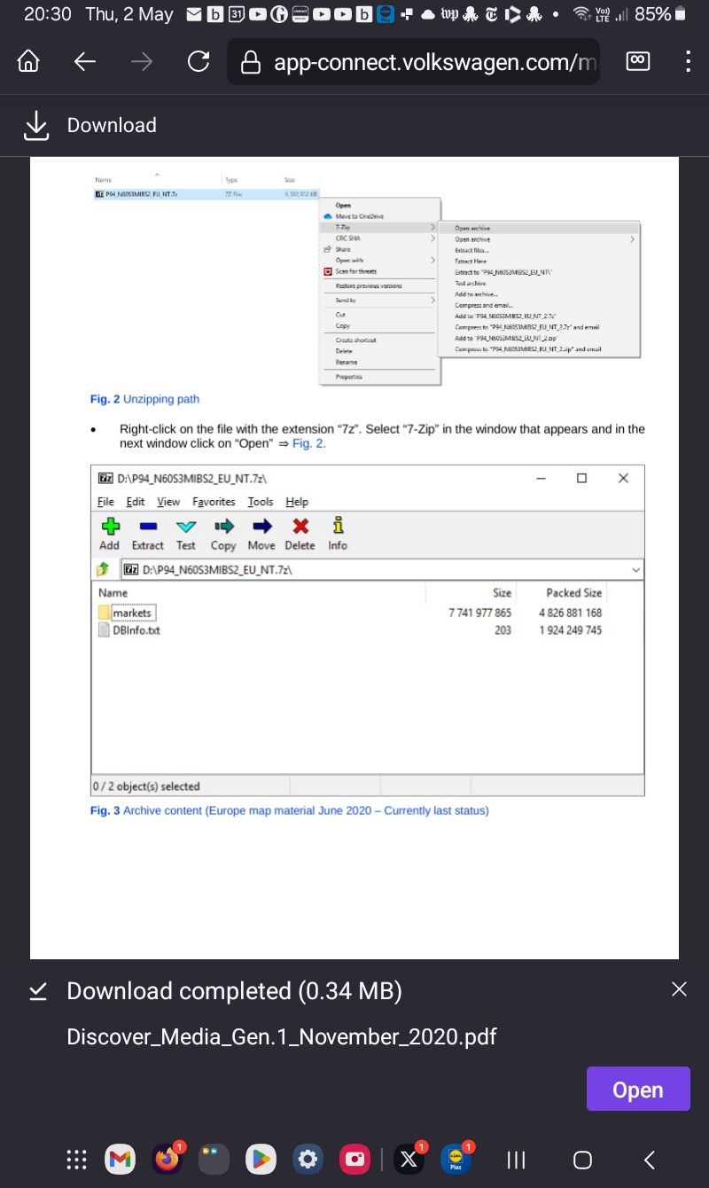

Attached is the pdf of how to do it for a mib1 standard as far as file position. Should be the full route not burried one down against a zipped directory name. Standard mistake.
Full pdf attached. Snap of what it should like the positioning. That inside image. Market is one down from the top. The top aka route has that text file in it.
Obviously the snap below is my screen. See the pdf for a read.
Also you need for force a reboot of the unit everytime you change the SD card else within that 20 minute power up slot it won't re-read the card afresh. The long hold on on/off. Clipping to read only has been said to be good as well.

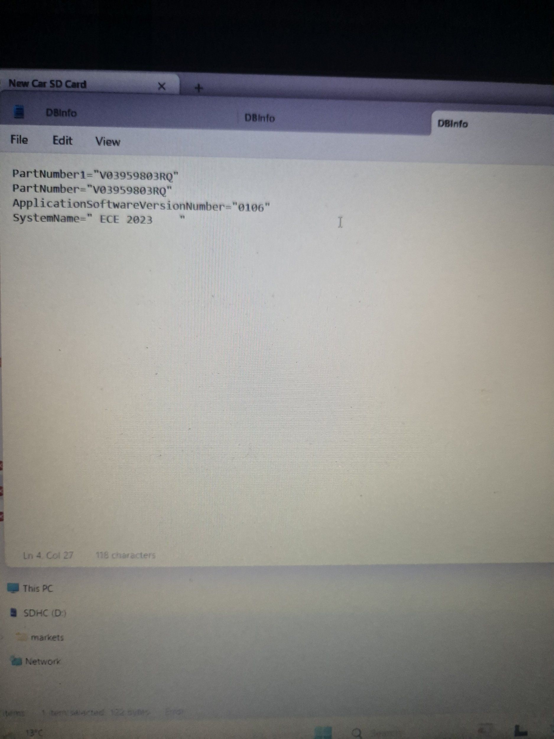

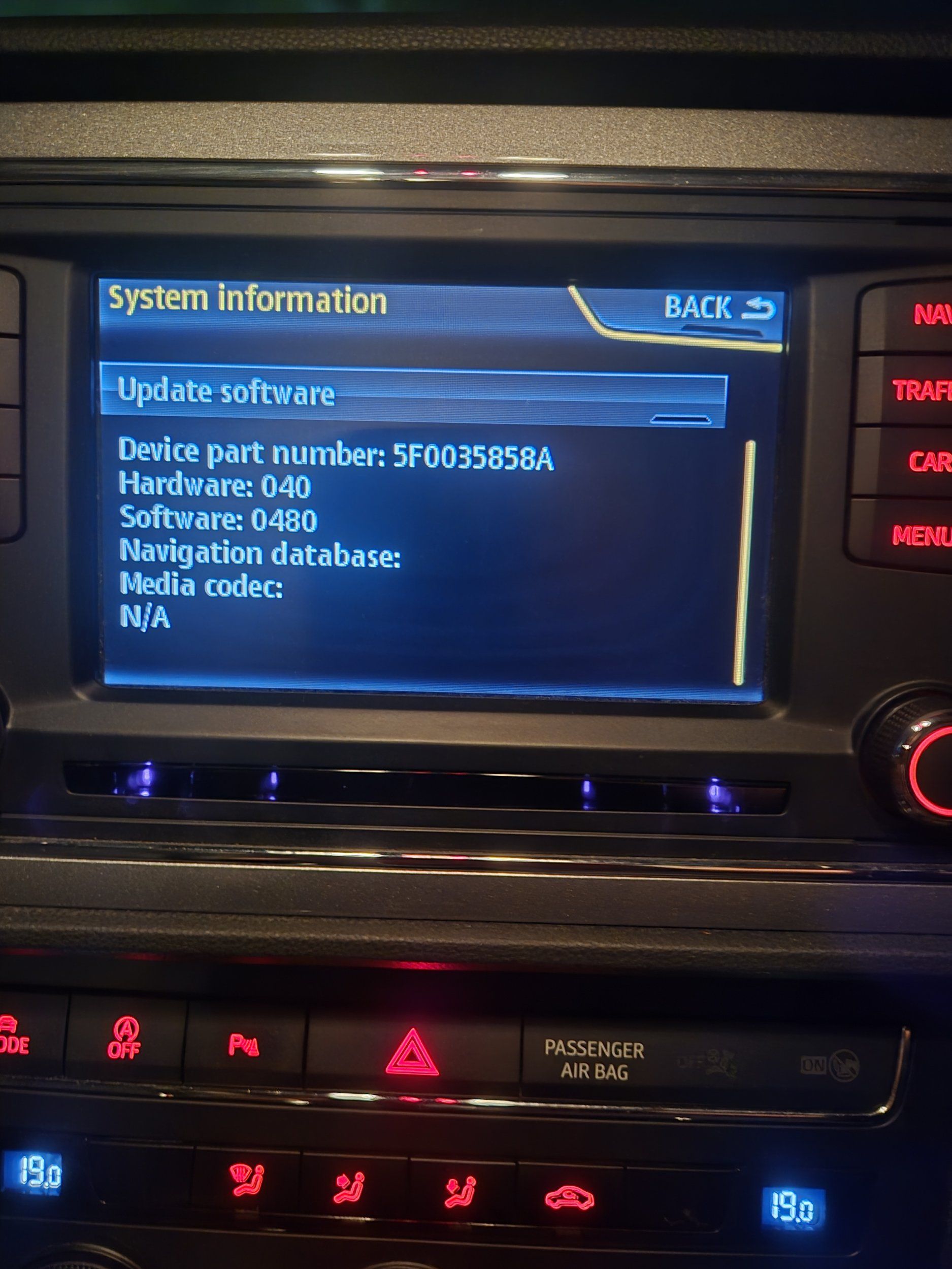

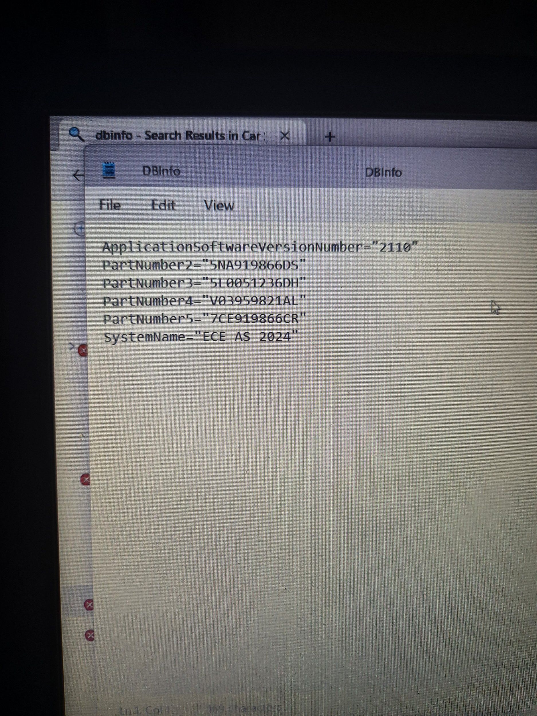

OK, I've tried rebooting also. I have attached two screen shots. The one with more part numbers is the old SD card (bought off ebay, so not for my car maybe?) the other one is the new maps I downloaded.
What should I be changing, if anything? My old card doesn't even have a part number one like the new one?
Other screenshot is the system info which has a part number, am I missing something here. Tried a couple of different things.
The mib2 cards are interchangeable as far as the CID is concerned so one does not expect an issue on that one. Previously before this 2023 map came out the recovery for mib1 where the card was lost was to buy a mib2 card and put the old map file on it. I'm wondering whether you could try an old mib1 map file on it if posters can give you one. It would be good to see whether it showed you can old map.
Note what @Guyelle said
Where the old working file comes in. You need that. Mib2 you can use files before the paired release in the unit. It may be the same so you might not need to drop your hands on the exact paired release or one before or work through all previous partnumbers till you hit on the right one.
Thus an appeal to all mib1 standard people with working maps !. I'd get your hands on an old map. It's the dbinfo.txt file you need from one that works then do the edit on the new maps as outlined.

I'd go down that route of hunting down the old partnumbers published and do @Guyelle edit as suggested. Anchoring before the actual one may do the trick. Also if people with working old mib1 files could share theirs.
OK, that sounds good. Is there any means of knowing the part number or a list of ones I can try? Or just trial and error using the thread?
Secondly, Should I be copying all of them over? For example the card I had bought had Part numbers up to 4 but the new maps only had two entries.
Will also try what Guyelle suggested also.

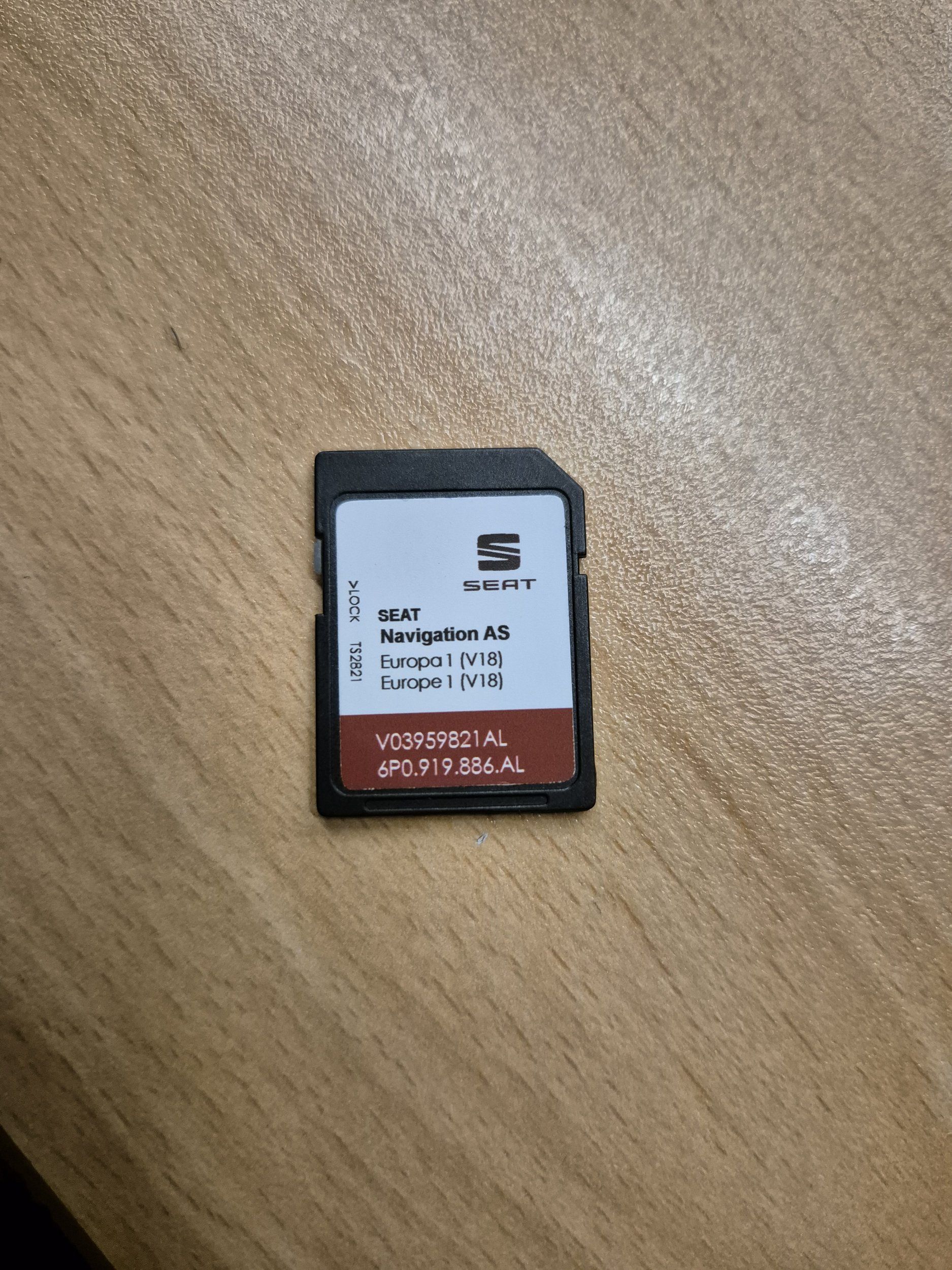

This is the card I have if this is at all useful to anyone who might be able to supply maps etc
Yes they could put the mib1 map on it and test if they have mib1 with the update or give you an old copy of mib1 maps if they have that. A test on another mib1 would test the CID but that should be fine for mib1. Over to the helping hands.

Yeah I updated my firmware and maps without doing any coding with a cable.
To save purchasing any SD cards I backed up the old map data, deleted all files from the V4 SD (not format), used that SD for the firmware update, then copied the old maps back (before I found the newer maps). I don't recommend that though as it'll cause more wear.
When copying the newer maps I extracted them to my PC first, modified the DBInfo slightly then deleted some Turkey & Ukraine stuff so it would fit and not fail randomly whilst copying.
Later I got a cheap cable and with coding I was able to clear the hidden error that shows when using diagnostics and then also got the TMC traffic info working again.
This is the SD that came with our 2014 car, I've shared it here unzipped which might save time (there might be a download as zip option somewhere). The Mega desktop app etc has been fine to use for me.
(I may have to delete this in future to save cloud space, so back it up and also sign up to save it directly to a free MEGA account).

DbInfo.txt:
PartNumber1="8V0919866B "
PartNumber2="5G0919866F "
PartNumber3="5E0051236C "
PartNumber4="5F0919866F "
PartNumber="8V0919866B "
ApplicationSoftwareVersionNumber="0036"
SystemName=" ECE 2014 "

DbInfo.txt:

It should happily work with the errors. It's a perfectionist thing to get rid of them after.
You could try the mega file first since that's a test of whether your car works with that map release. If it does then 2023 update should. You go back to your 2023 release and put in @Daz3d last file in place of the dbinfo.txt. The edit being done for you. You just slot it in but ofcourse that's dependent on whether that first unmodified file works in your car. Why I said do that first to test it.

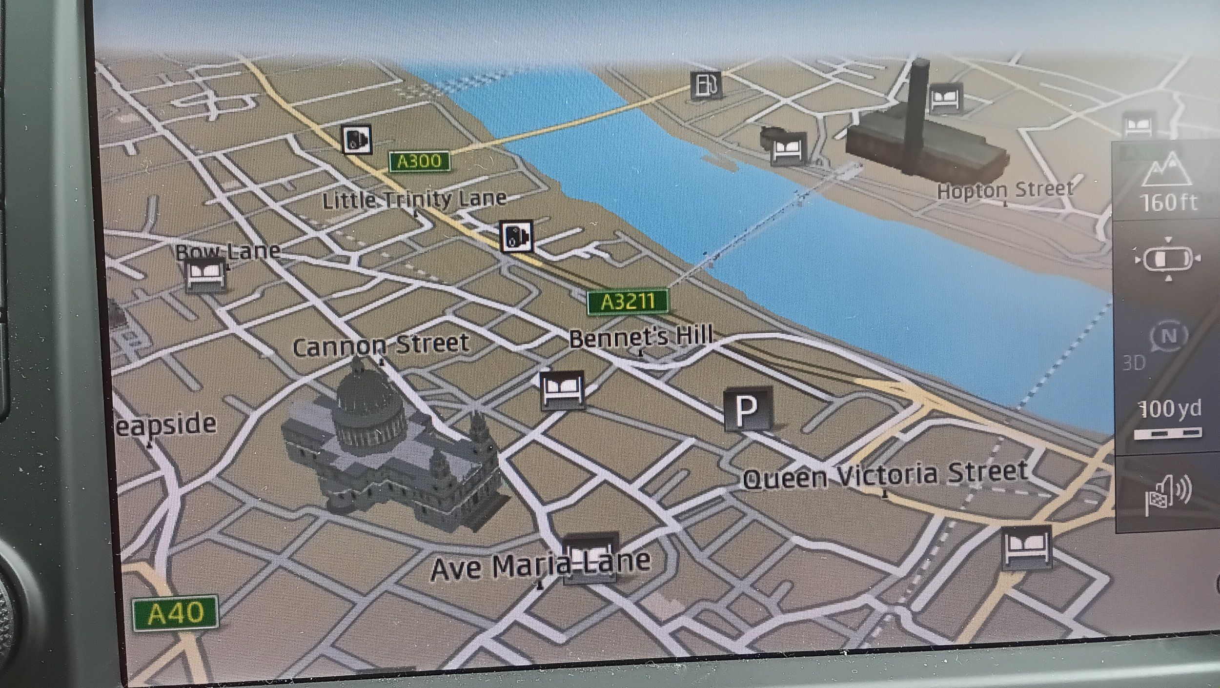

3D files, well on the Audi one I've seen a cathedral that wasn't there before. It's a joy when you see them.
I stopped installing the VW release since SWDL showed the release codes in the entities were the same which meant no work to do. Rather than sit about in the car my checks said it was fine. I did look at the file contents between the Audi v VW and they looked identical. Possibly mib1 high version name of the 3D you found missing. The mib2 high 3D was covered.
Recommend you install and look for London Bridge etc. If it doesnt work you can, using SWDL restore your old version, there is always the Audi version ?. You do manual install and run your fingers across the menu, with the door open, or open and close every 15 minutes...

Audi 370
How to nudge it up to VW if on Audi 370. St Paul's and Tate Modern in the Audi 370 file. So 3D was in it.

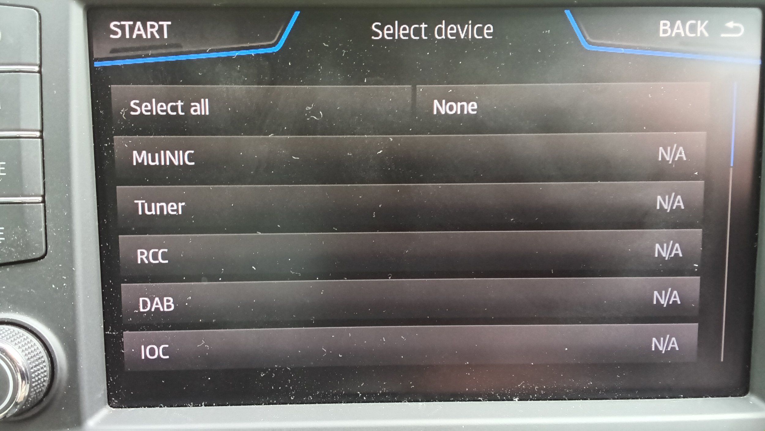

Swdl update all using manual method (manual download and press start), Select All and Start with the VW 370 upload if you Audi 370 in it and want to overwite with VW 370.
Will edit for each stage. Now a forced update of Audi 370 to VW 370. 40 minutes running.
And successfully updated to VW 370 (same release as the Audi one) & 3D the same as before.
So yes identical, but I put it through completely rather than say I've done file comparisons. It's available to use if your got the navigation FeCs.
