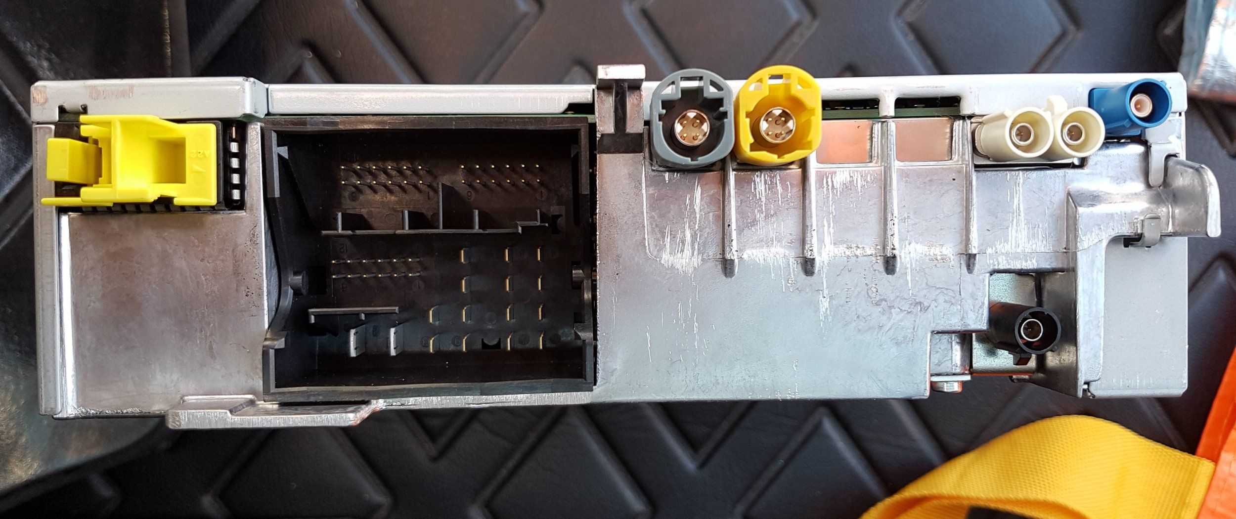

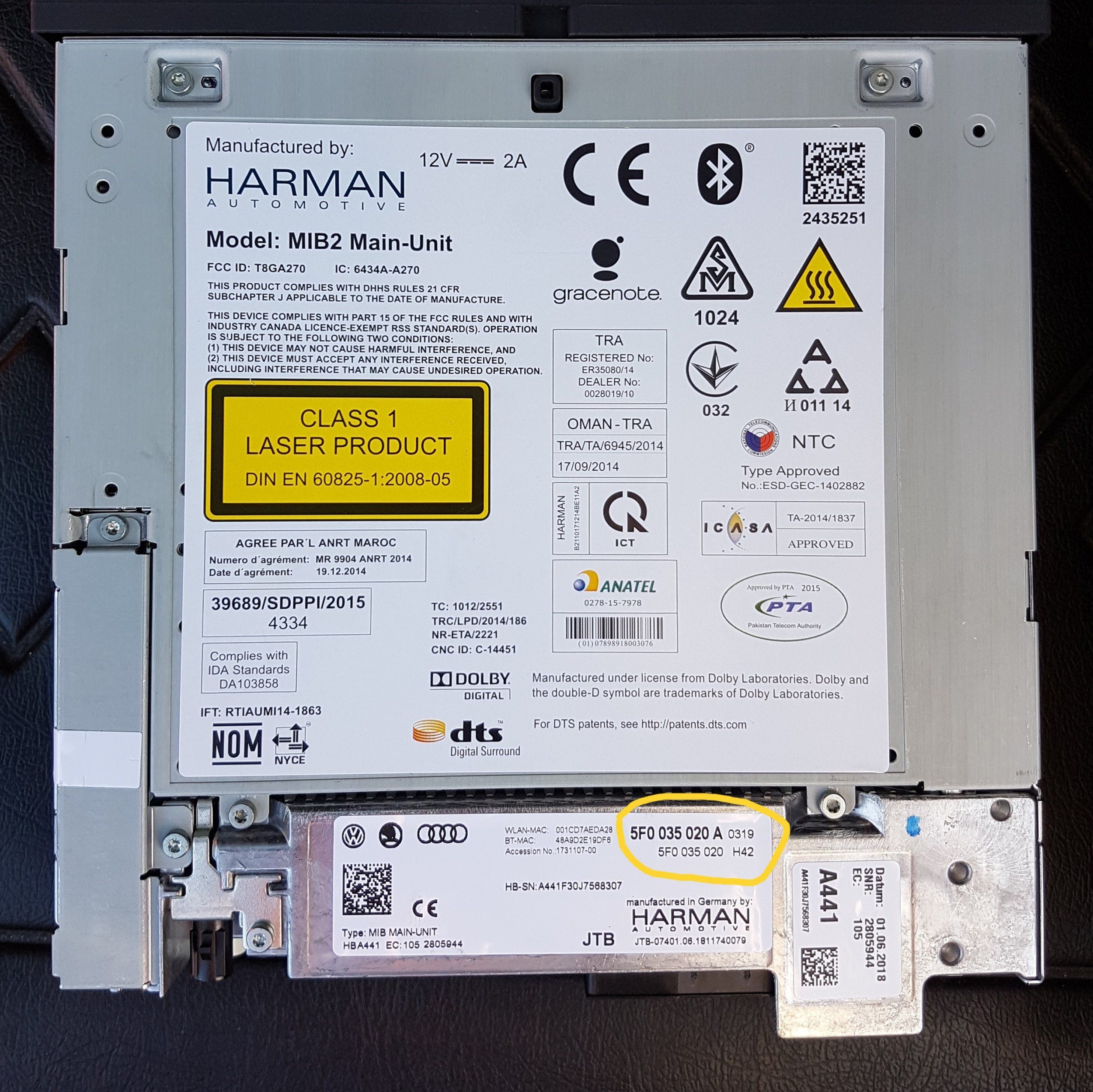

Say if I wanted to fit a MIB2 High to replace my MIB2 standard, what’s the part number I should be looking at?
I looked online I can see two different part numbers but not sure which is the better/most recent one.
Just curious to see how much the units are going for out of curiosity

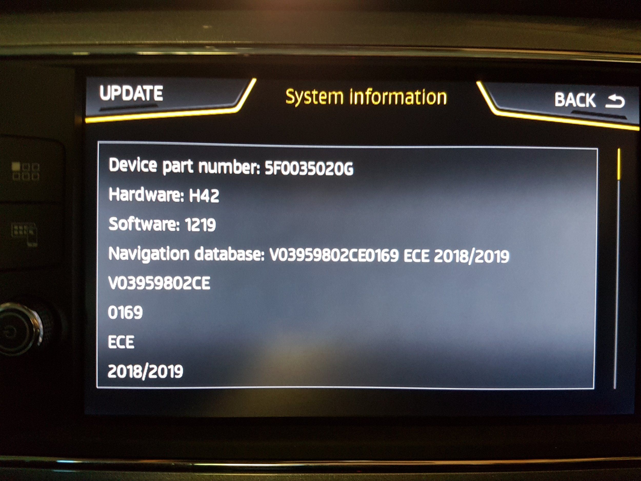

This is my MIB2 High unit, the numbers in the yellow ring are, part number 5F0 035 020 A (the A changed to a G after I did a software update), 0319 is the original software version, H42 is the hardware version.
