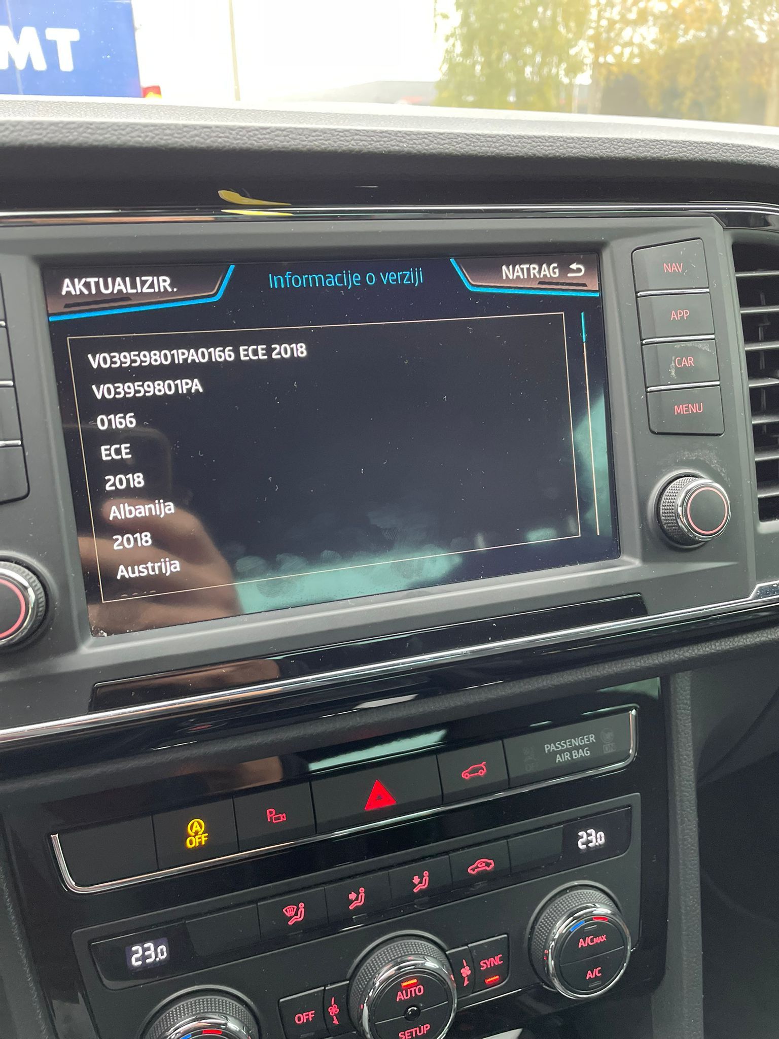

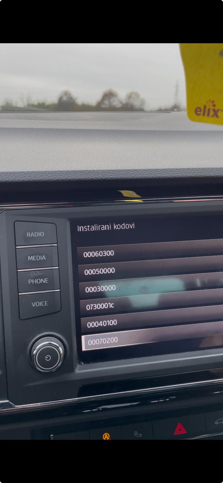

Hi, all. Last month i buy Ateca FR 2018. I mannaged to update the software to the latest version MHI2_ER_SEG11_P4709 but ti cannot/dont know how to update maps.I have maps installed on my device, i dont have sd card. I downloaded the latest version of the maps P390_N60S5MIBH3_EU. The sistem says that the update of the maps are found but it dont update the maps. Can somebody please help me how to do it? Maybe my FEC dont allowing me, or am i downloading the wrong version of the maps? Thanks for your help in advance.
The FEC for the maps is the one starting 073000, not sure what your one means, @Tell will know i'm sure!

Yes I've just covered it here in another post he did. So we are all good.

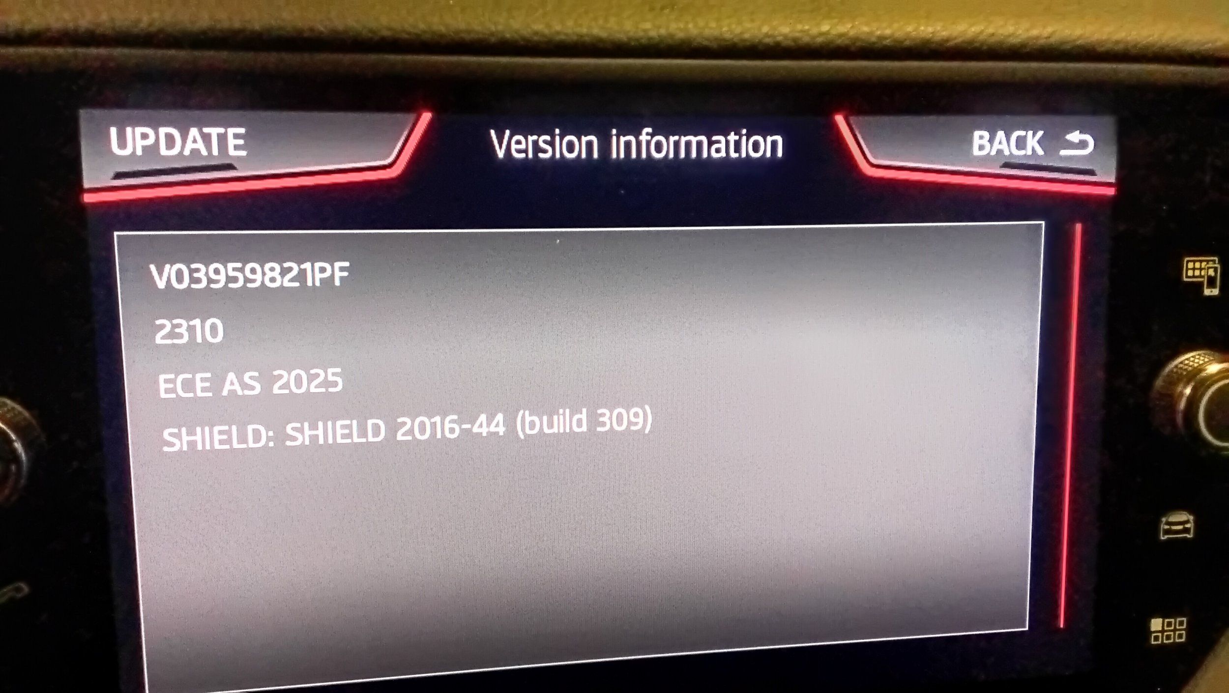

Normal success screen. All Europe.
