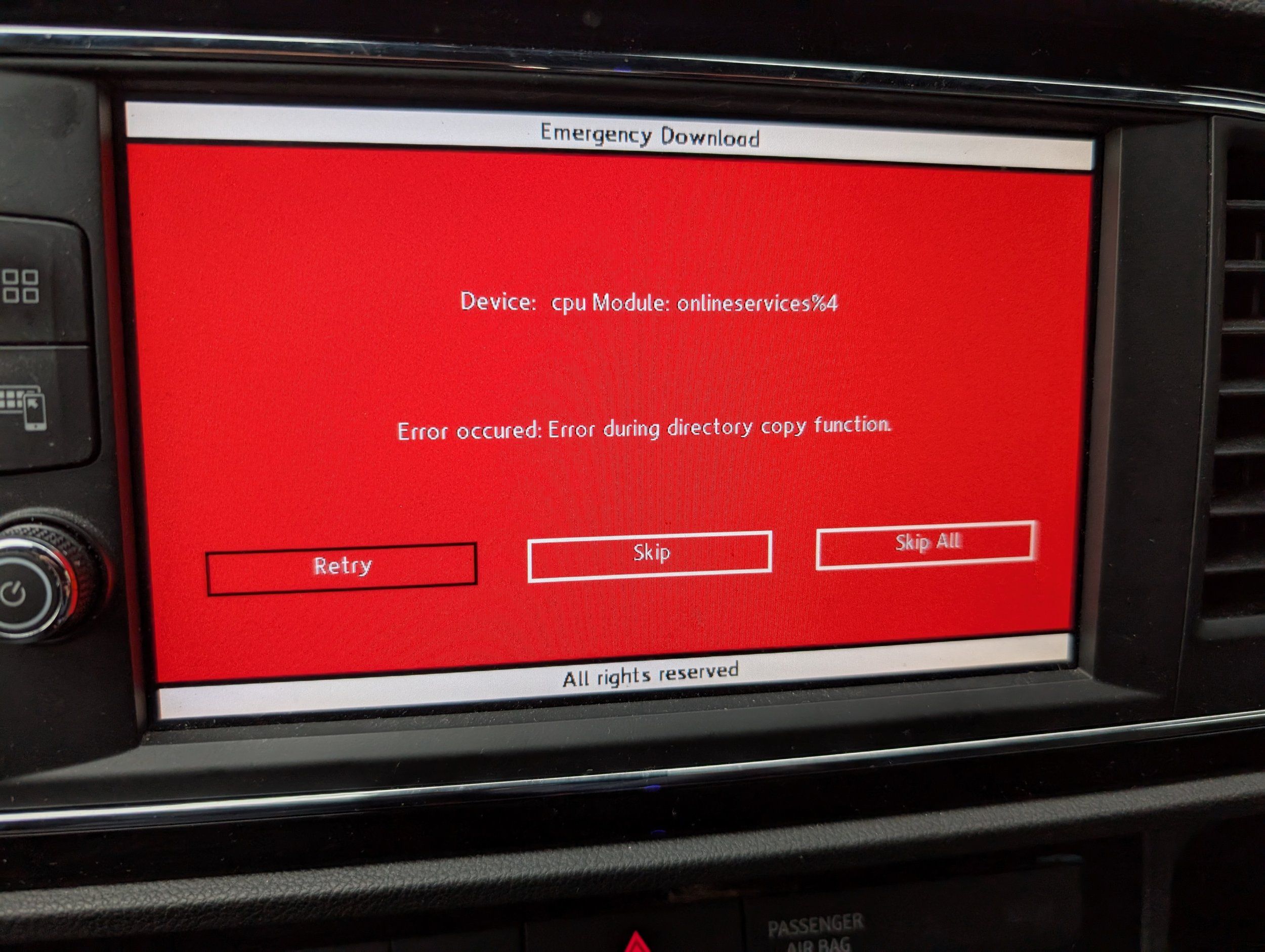

when you try something and it goes wrong...?
Safe updating maps but not firmware if you dont know what you are doing. Mapcard you take a copy of it. The SSD ones (mib2 high) if you force it via SWDL and don't have valid Navigation FeC for the map, like the life long navigation fec, then it's shows up for 30 seconds then closes down and says the map isn't activated.
Those are the only two things that can go wrong. Former you use you SD map image required for work arounds, mib1 and mib2, the latter you loose your SSD map image. Was in that one till I found the old release prior to getting the FeCs updated. Restoring the old release brought back the map.
At that time the secret of navigation FeCs wasn't known to the board or me. 7 years ago. Had to do the learning curve after a London based retrofitter was mis-selling firmware updates with maps for life.. yeah a year only, they must have known. Effected two of us. I'll credit myself with working out the Seat table after seeing the Audi one. Different codes. Using @Walone FeC working and mine when it stopped. Pictures of before and after running FeC changes are very useful.
Those are the golden rules.
