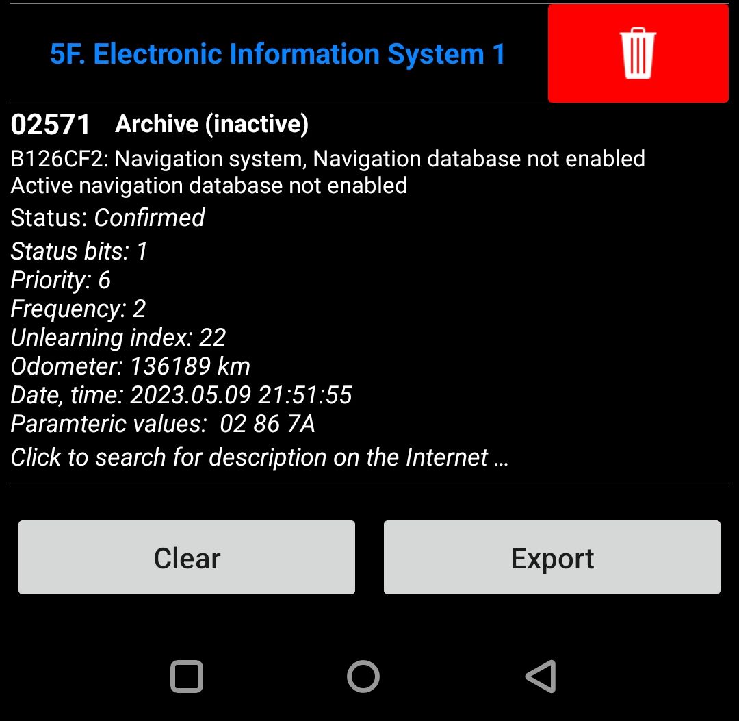

Don't worry about it, nobody does. It's a side effect of the "workaround". They have been generated for five years now. A normal coding clear for errors doesn't touch them. It's suppose to be due to more than one navigation FeC getting created.
There are tool boxes that can fix it but then they are meddling with the firmware and the standard toolbox only works with specific firmware releases. To avoid it you need to amend the standard navigation FeC so it's a lifetime one. Pushed out into infinity. A Hex coded. Again to do that the firmware release has to be specific to what the tool can touch. There are public domain tools but not worth it.
Retrofitters sell their service to keep people happy who have a scanner and find the error but the vast majority don't even know. Suspect Exciter (Stephan) who devised the workaround knew it gave the error message but discounted it, so didn't mention it. It was subsequent that it became apparent that you found the error code and that double entry of the navigation FeC explained it. The workaround causes the unit to generate the navigation FeC for the release and you keep the old one. Least that's my understanding of what is going on. I wouldn't bother. Going down the mib2 standard toolbox route is likely to be tricky. On the matching firmware thread to mib2 there is no practical knowledge that I've seen of that toolbox so you are on your own.

That's why you can't clear it, since it will return until the duplicate navigation FeC's are taken out. Clearing the error doesn't remove the duplicate navigation FeCs. Similar to the high unit where you get an SVM when you change the maps.
Today Seat cars generate so many errors dealers don't look at the error report unless they are looking for an issue, doing some trouble shooting. The car gets returned with all the error they created in routine service. So you know they aren't clearing the errors these days. I always do an error check and clear before putting ours in for service, then checking after.
On a general one we thought it was SVM (serial version management) but that error isn't that so doing the SVM fix doesn't do it. The only way of clearing them is using a toolbox to tackle the excess navigation FeCs and that has it's own set of risks and as said I've not come across anybody on the board who is up to speed with standard Mib2 toolbox in this area - it comes up on the firmware thread linked above.
Like the high toolbox it only works with specific firmware releases so you may have to upgrade or downgrade your firmware before you could use it with the risks that entails. The toolbox goes in the green menu then you can run routines. Basically the mib2 toolbox for the standard and high uses a backdoor method to evade the SLA1 signature check so the program gets into the Mib2 unit. This then gives retrofitter tools as if you had the unit on a work bench connected to a PC via a USB but they have put those programs into the unit instead. Clever stuff.
With the tools you can then write your own FeCs, delete FeCs and clear errors. Conversation should be on that link. You tend to only do it once and need hand holding, How I got the Skoda high navigation FeC on my unit when VAG excluded Seat from the update on one serial release. The other one for the high unit is to do a total firmware update to 1447AIO (all in one) that gives you the complete set of FeCs enabling everything avoiding the toolbox, it calls the toolbox in the background. Mib2 highs can jump trains, mib2 standard unit can't and that's the rub for getting the mib2 standard toolbox in the unit. Those AIO firmware versions for the Mib2 high are available for other VAG brands. Developed by Telegram hobbyists. I find Audi folk on other boards looking for map updates after doing their own AIO type of update to the firmware. Basically the hobbyists took the final release of the mib2 high firmware, grafted on the mib2 toolbox across the brands. It will also update the Gracenotes album artwork library now, so they are offering updates beyond VAG.

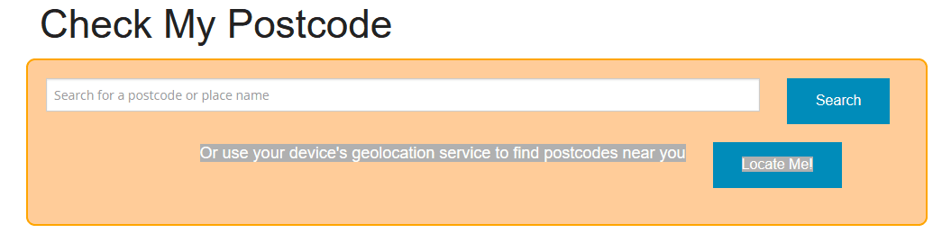

Another check is to look for the the postcode in the postcode directory:
That is the gold standard if it isn't in there then it's not a recognised postcode.
This is where you have a postcode but you suspect the road isn't drawn or missing.
Type:
Tap "locate me" based on the geo position of the device. Based on the centroids of the postcode it will show you where the postcodes are on an OpenStreet map. You zoom in and look around. The postcode centroids are generated when the postcode is first registered for geo location purposes. x,y coordinate.
Giving you mapping development secrets now. You then compare with the OS planning maps that are commercial but often found on LA sites (aligned to the land registry maps). Those maps are not used by the map developers since it's costs them. That's the problem they don't validate against statuary data. Development plans and plans on estate agent sites for new developments give the developers plans and roads. These will work through into the OS planning maps. The house number clues are on those planning maps as well, so you can house number digital maps without even going there by cross checking the postcode directory and the planning maps. Here Maps take in the house numbers as well. TomTom doesn't. LA house number roads mark up on the maps the house numbers - where the house numbers come from and house names.
Those are the little secrets of finding missing data from the digital maps of TomTom, HereMaps, Google Maps etc. You then tell them it's missing or in Here Maps case draw it in. Google are weird at taking changes so I don't bother with them now. Then they can get huffy since they have no way of validating it till a car passes by. They do use digital GPS phone tracks which they have access to so in some instances they know something is going on there. I have had access to map developers data in the past and saw all of their tools. Another is they analyse each others data and that's how map faults get generated across the mapping systems. You get the bollard in the road one. The planning map shows the bollard so it's no through but gets drawn as a through road. Many housing estates they stop rat runs by only allowing one access road. You find that looking at sat maps they digitise on the developers roads that dont' turn into the actual estate roads. Building stores etc. Here again because they wont look at sales brochures of estates or official planning maps (the gold standard) they get it wrong.

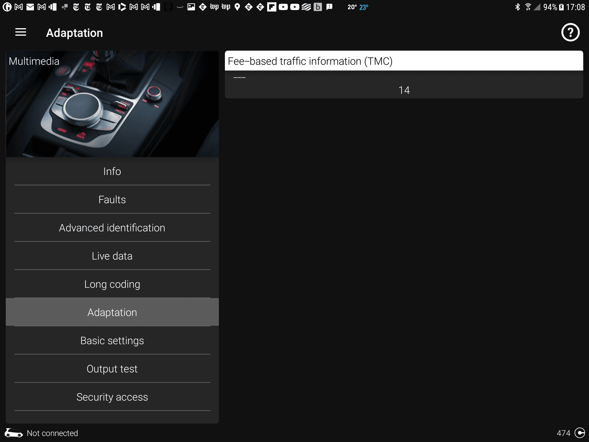

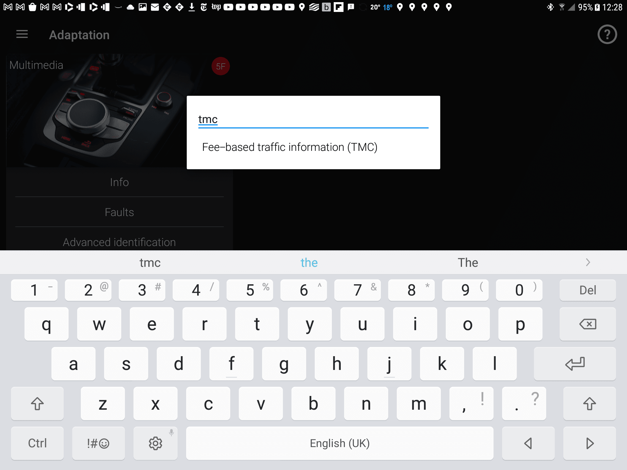

For mib2 high and mib1 the quick fix is to change the Fee based identifier from 15 to 14 (nb start point may be differenton other than Seat or Skoda, 3 for VW). That's the code for the other UK based TMC FM provider ITIS/INRIX RDS.
I've been encouraging techie people on the Briskoda board in the solution. One guy found it by looking at the mib2 high map files which bunch the providers.
So the solution in Obdeleven 5f unit, Adaptions.
You do the long hold on / off reboot.

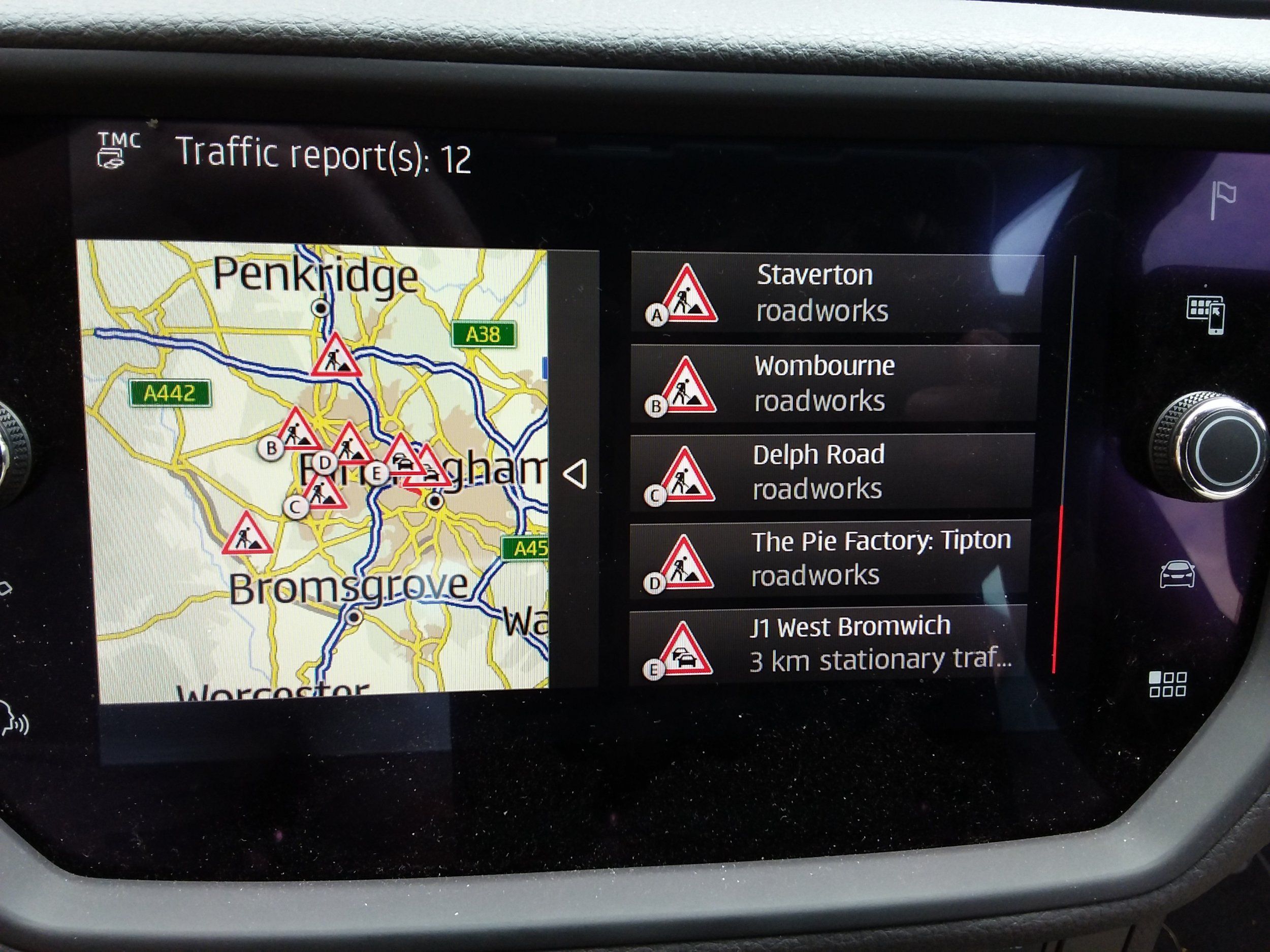

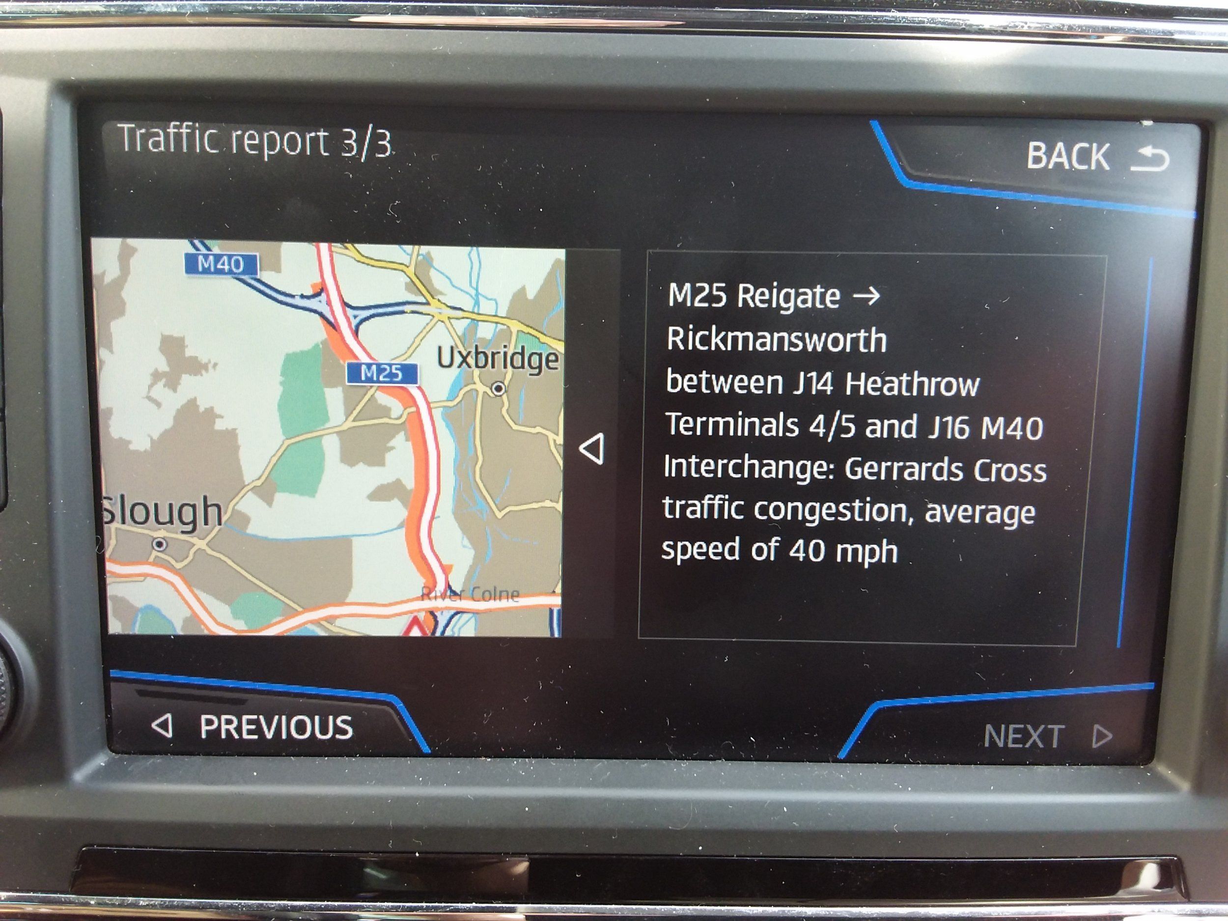

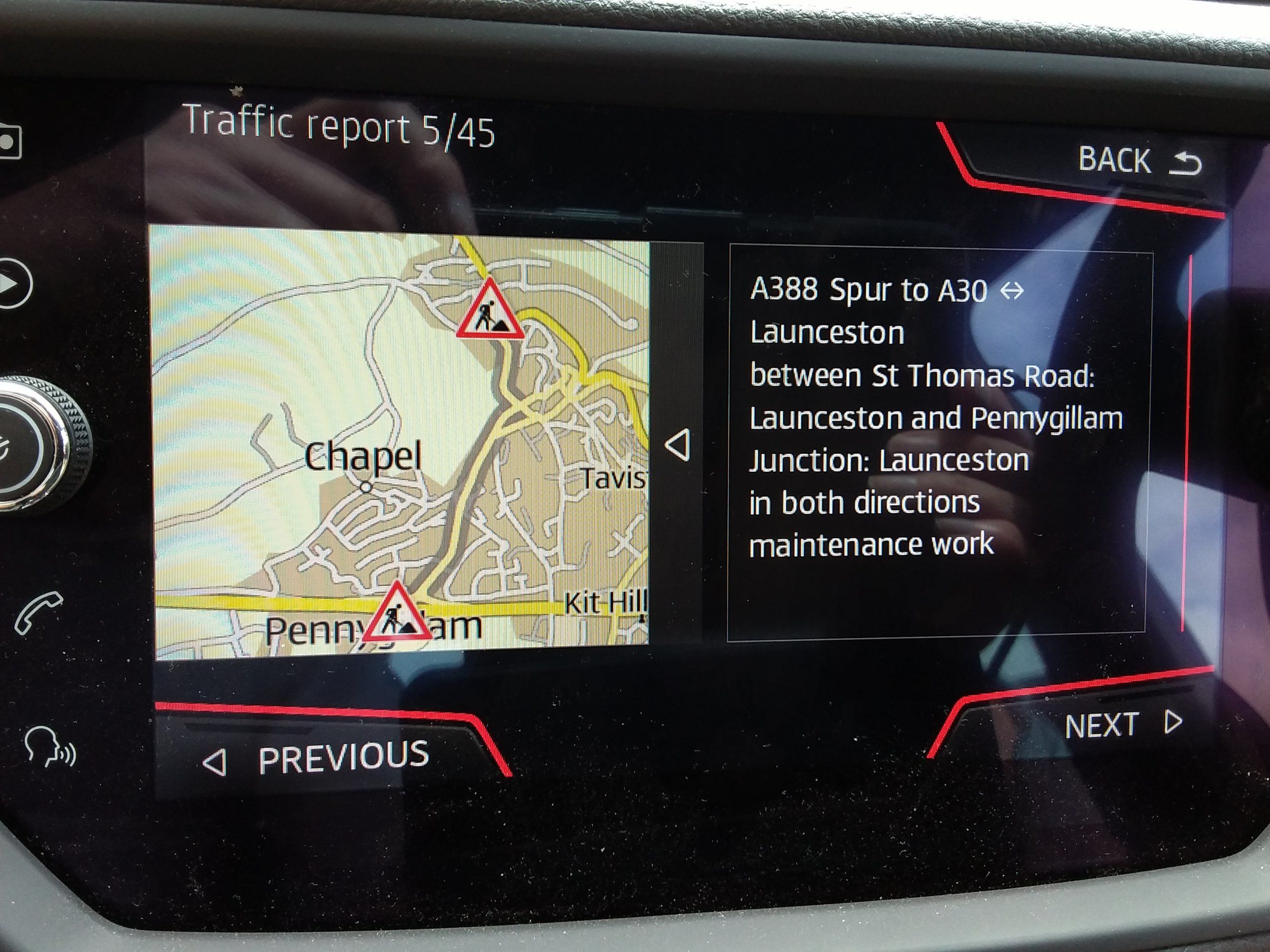

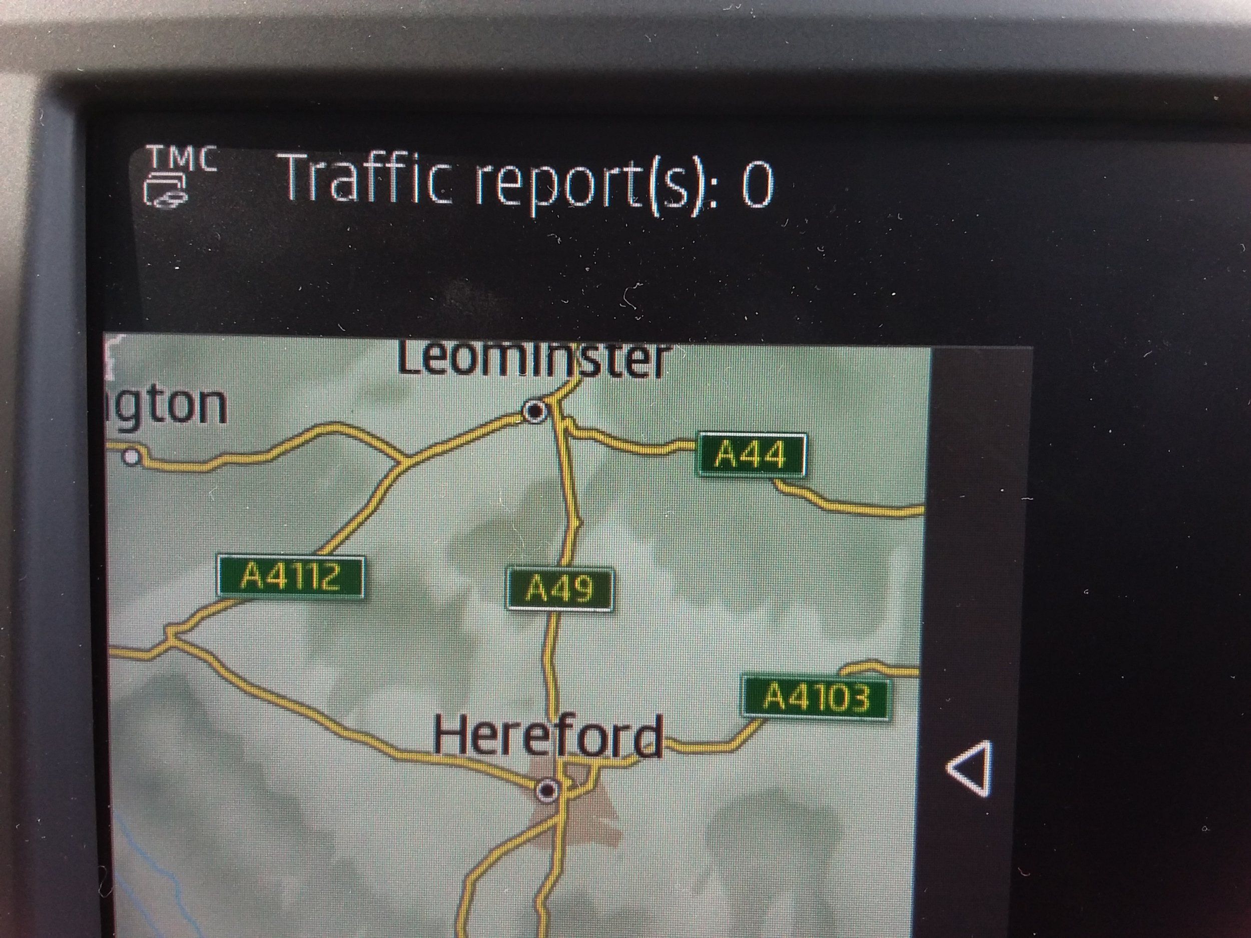

The cross now goes since you are picking up the other TMC provider:
Indeed back in business again:
The online solution had been found on the TT board so the mib2 high RDS one washed out of this. The codes if you have that. Online mib2 never got to Seat.
32783 is online traffic permitted + Trafficmaster RDS TMC
32782 is online traffic permitted + ITIS/INRIX RDS TMC
15 is NO online traffic, Trafficmaster RDS TMC
14 is NO online traffic, ITIS/INRIX RDS TMC
So 14 for Seat mib2 high (Seat Plus units), same code for Mib1. Here Maps accommodate the graphics on the maps... designed for it.👌
This swaps the TMC provider for the UK, all international TMC providers remain as set, except Finland and Hungary which are dropped. Thus the change is good for the UK and abroad, except Finland and Hungary.
Coding or Toolbox
The changes can be made with Obdeleven or VCDS as a coding solution. Obdeleven shown above or with the mib2 high toolbox. Two toolboxes / kits for the mib2 high (pass on terminology)

Hi Tell, Thanks for info. Could this update be done through other software like VCDS, for example?
Tell
Full Member
The mib2 high one yes (the unit Seat call Seat Plus). Easy enough for someone familier with VCDS to find the Fee Based Traffic Information line. It's factory set at 15. Needs changing to 14 then a long reboot. I've had conversations with @Walone in the past since one retrofitter in the UK had set it up wrong. Out of the box it's blank or something. Walone has VCDS and was correcting it that way.
Edit. In an edit above the mib2 high toolbox can be used as an alternative. It goes into the "green menu". People familiar with that can do it that way.

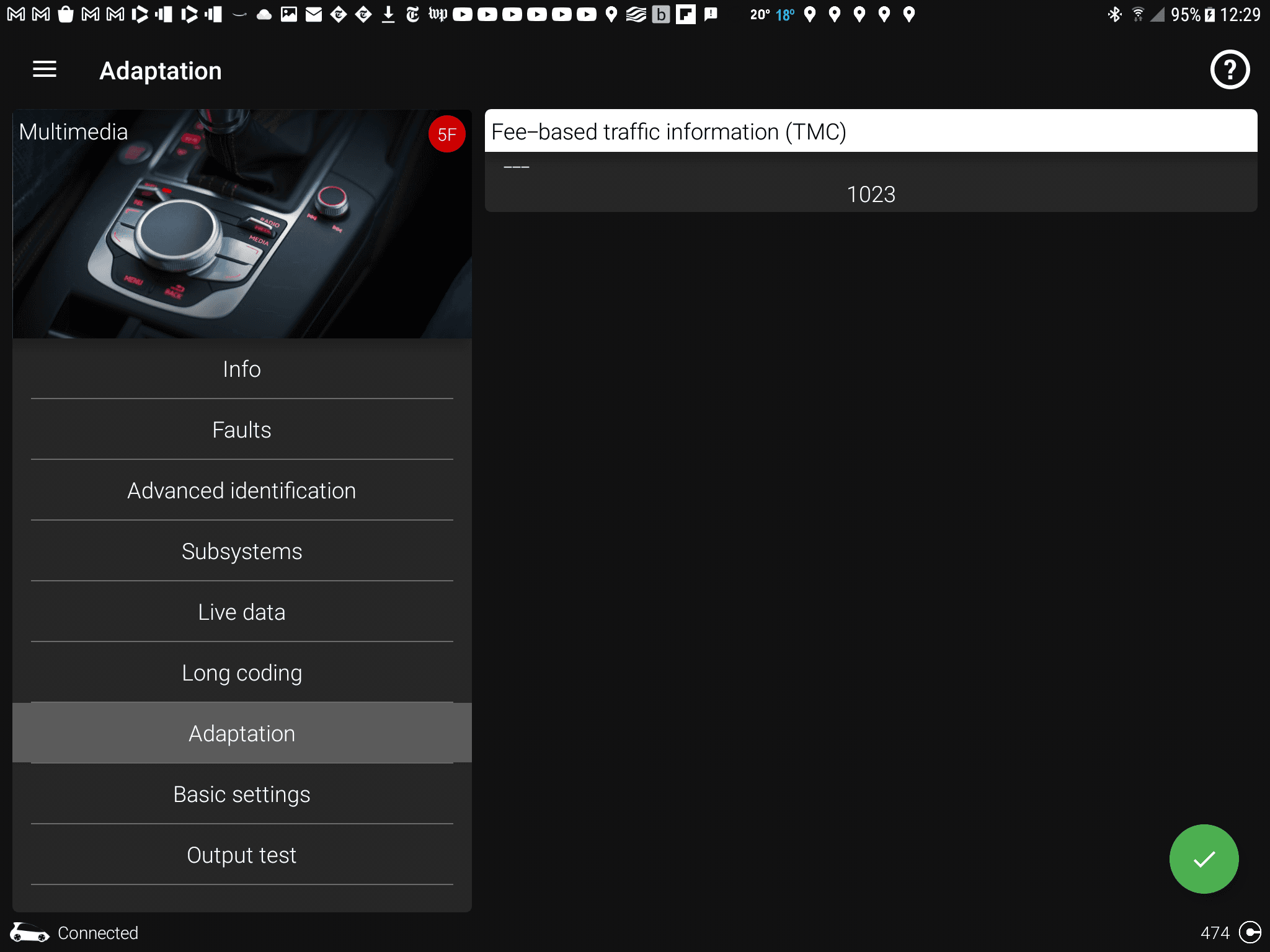

a. If you have VCDS / Obdeleven Pro coding device and want TMC to work across as many European providers as possible plus the UK Inrix service then change the TMC fee based code to 1023 via coding and use the module in the zip files: DiscoverMedia2_EU_AS_1430_V12_TMC_Update.7z
b. If you don't have VCDS / Obdeleven Pro coding device and want TMC to work in the UK with Inrix service but aren't so bothered about all Europe TMC providers use the module: DiscoverMedia2_EU_AS_1430_V12_TMC_Update_V2.7z This option assumes the current TMC fee based setting is set to 15. Default.

4. This step is optional if on a. Configure FEE BASED TRAFFIC INFO is set to 1023 using VCDS/OBD11. If b. ignore the step.
Example in Obdeleven, 5f unit, Adaptations, search under TMC:
Change to 1023, save and reboot the unit:

Example results with it working:
