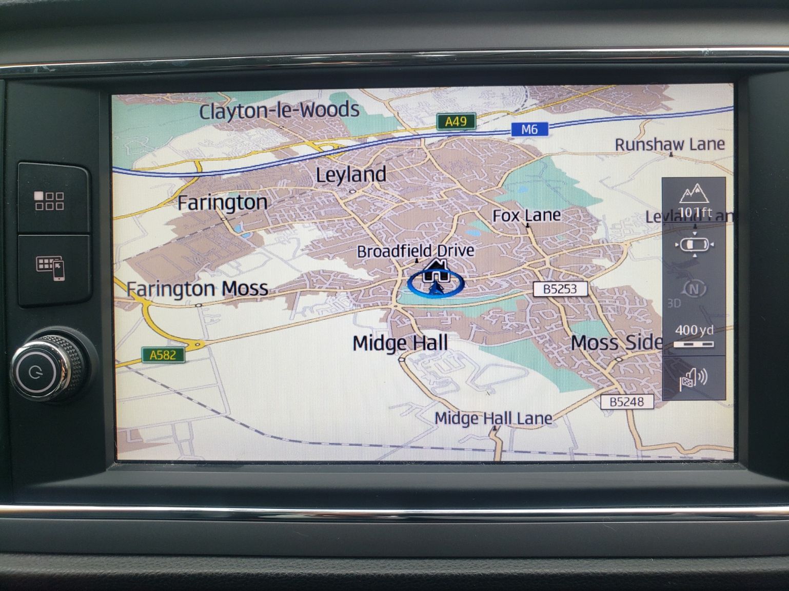

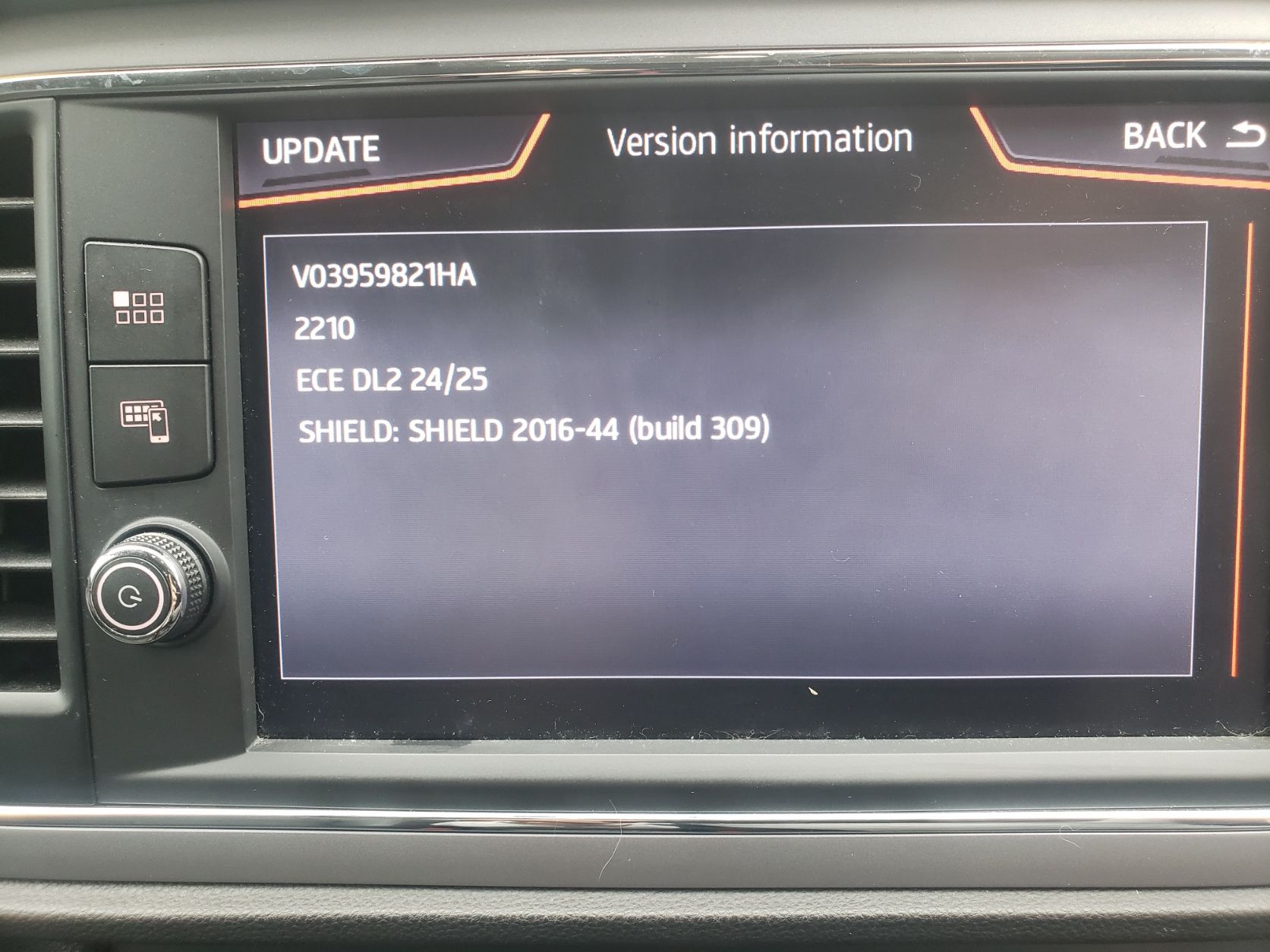

Just a quick heads up for anyone planning to update their MIB2 maps.
The latest mapping on the Seat update portal (https://www.seat.co.uk/owners/about-my-car/map-updates/leon-6p0) is the 2023/2024 version 2010.
However, if you go onto the Volkswagen update portal, (https://app-connect.volkswagen.com/mapupdates/en/download/#download) the later 2024/2025 version 2210 is available.
I've downloaded this version this evening, and after swapping the Overall.NDS from the original working maps into the new 2210 as documented in other threads, I can confirm that the 2210 version is working 100% in the Seat MIB2 (mines a 2019 Leon).
Hope this info helps someone get the latest available maps.

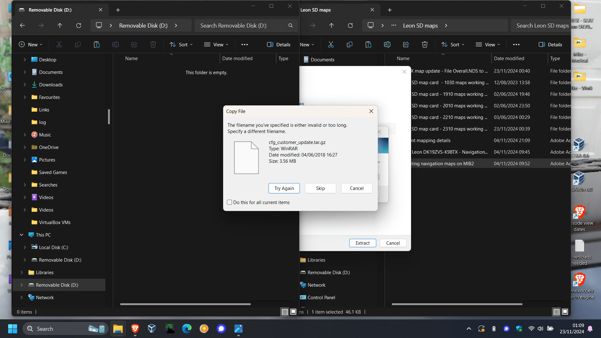

And even with the overall.nds workaround, it isn't recognised by the nav unit..... back to the older maps for now
It's showing an error on two files for file length that can't be written to the card as in screenshots, any ideas?

Will have a look in the morning to see whether they have changed their map provider to Here Maps, then you'd get it back, with TomTom you don't, it's hardwired onto Traffic Master. It's set up for a suite of TMC providers and Traffic Master doesn't broadcast in the UK now. It's the suite it's fixed on, mib2 high it's kitted out for Inrix by changing the providern group, TomTom implementation for the mib2 standard it isn't. Limited implementation of TMC on the mib2 standard when they moved to TomTom from HereMaps. They just did the bear minimum. 15 to 14 if you have mib1 or mib2 high on a Seat for Inrix.
