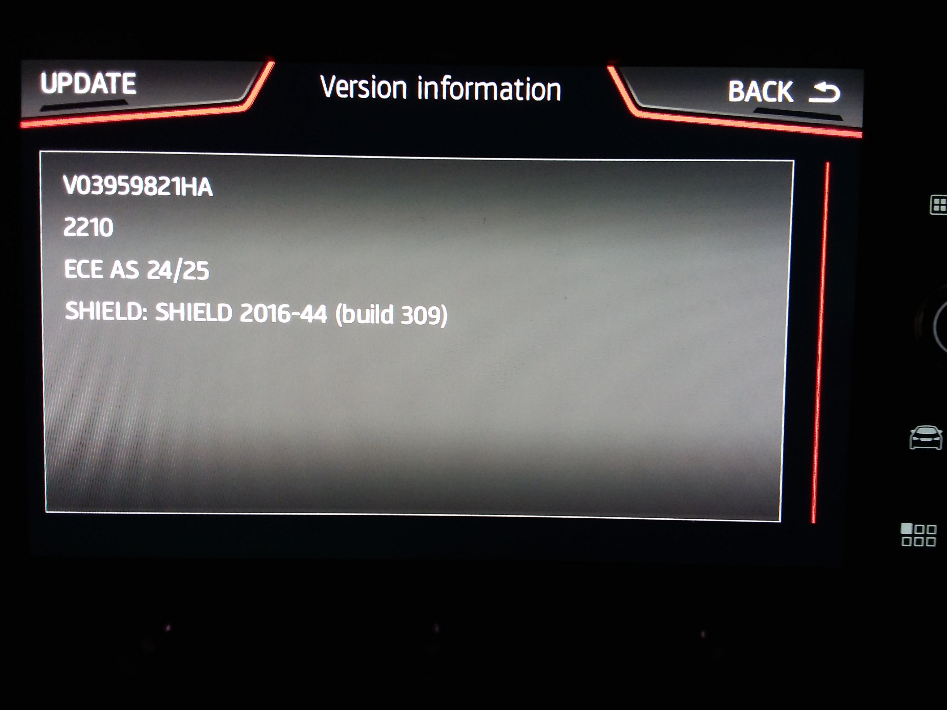

Result - well done!
Is that with a bigger SD card?
It was, I used a MIB2 v6 card I bought on eBay. 😊
As for the old part number, it's weird because V03959803RN doesn't seem like a SEAT part number, looks like an Audi one. I'd have thought there would need to be a '5F' or 'F' part number. 🤷‍♂️ Oh well, sorted now.
They are standard multi platform releases and just throw up the part number from the file based on the firmware in the unit. So it goes Seat part number 4 etc but how it protects the updates in mib1 from not having mapcare is to look at whether the part number has changed. If you change it. Naughty boy, you don't have mapcare, no maps shown. Edit it in yourself as post 2820 above, good boy.🎉
Well I've edited it into the resource on the basis we now have the universal solution for mib1 sd based map updates, taken over six years. Mib2 standard Exciter sorted it out within a year. Think the PCP guys were onto their new cars with mib2 so the mib1 trail went dead.

I thought any genuine card worked with any mib2 ? The cid was to use any sd card.
I always just copied new map data over the old one.
Tell
Full Member
Any card with a genuine VAG CID on it which will be Genuine VAG cards or SD card where the CID can be written and you write it. Few of those about and you need the card reader on the motherboard, Linux etc. I did that once. Repeated what Exciter did, the originator of the workaround. It's on the thread.
It's in fact cheaper to buy a Vag mapcard card, Seat, Skoda, VW etc than buy a rewritable SD CID card and clone your existing card. Those cards are pricey. You can always do what you did hack the firmware but that's more problematic. Less hassle way is to buy a 32gb Vag card off ebay, use the workaround and it's done.

Basically for mib1 it goes like this, from your old map file read:
PartNumber1="your old part number"
PartNumber="your old part number"
Edit the the new map file two parameters too:
Obviously your your old part number is your old part number. Use the notepad editor if Windows.
Thanks.
When editing the DBInfo.txt from the P106...7z do I add in the PartNumber2, PartNumber3 & PartNumber4 settings from my old SD card?
When I've made the changes & put the new file on the 16GB SD card, do I just put the SD card into the car and switch on the ignition / start the car? Will I see new messages / how long will it take? Anything else?
Tell
Full Member
Thanks.
Take a copy of your original mib1 card. It's just part number 1 of your old card you use. Leave part numbers 2 - 4 as is on the new map. Seems the unit is fooled to think you have not swapped maps cards. It's anchored on the part number 1 (the Audi part numbern). That seems to be what it's doing. Edit with notepad you don't want word processor characters added as well.
Put the card in and you should be fine. I always say force a reboot of the unit on mib2s by holding in the On/off button till you see the splash screen again. If swapping map cards in quick succession it will still hold elements of what it's read from the card before and reject reading the new map correctly. That's always good to do on these card based systems if it's not getting the 20 minutes power off cycle when switching maps.
