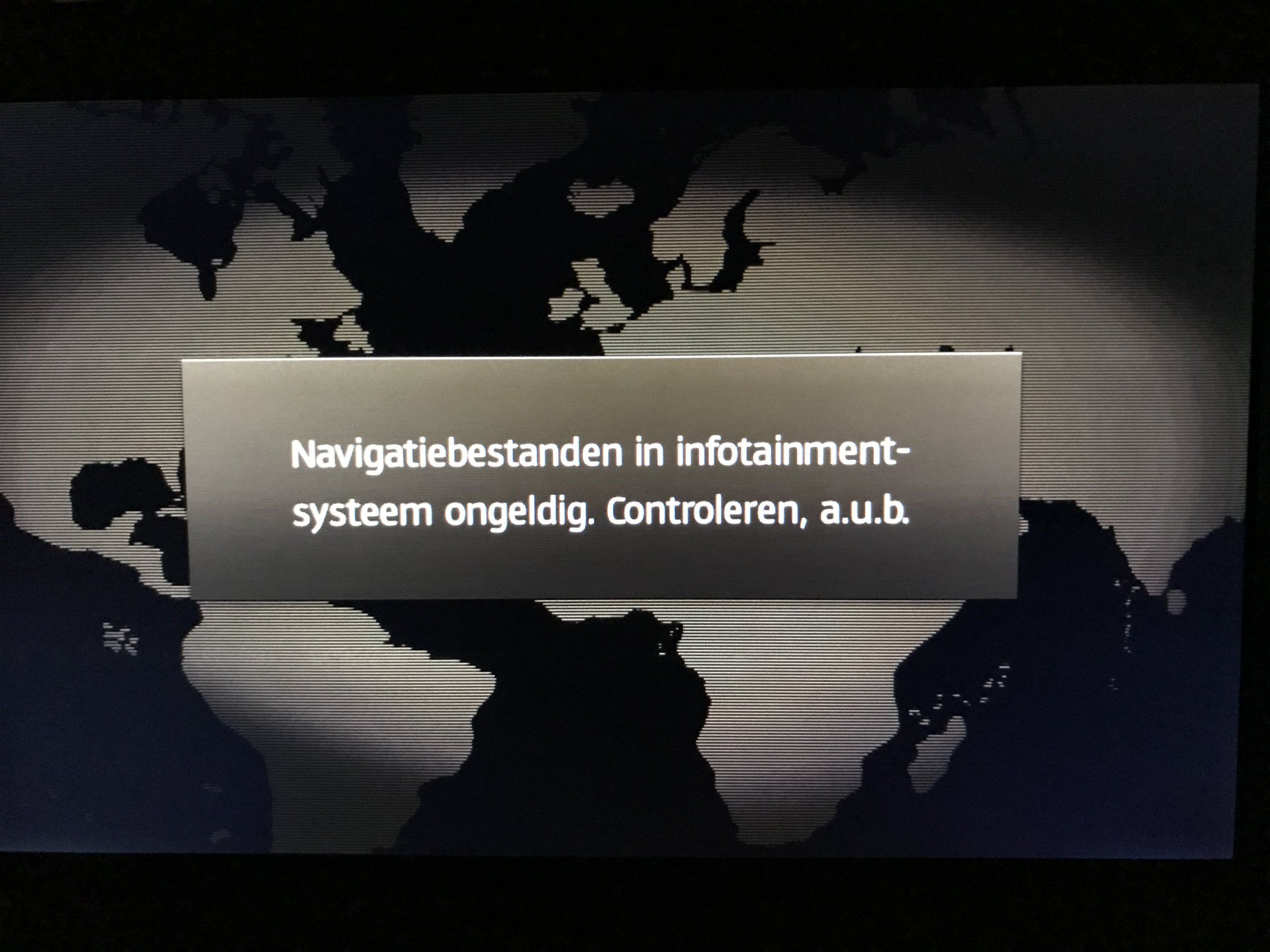

The message is: "Navigation files in the infotainment system are invalid. Please check"
The SATNAV says the map is not authorised. I will take a picture. Give me 5 minutes
Normally 30 seconds if you dont have valid navigation FeC after putting in a destination.

As mentioned before, please share your log file. It will show the status of the unit.
Currently your FECs are not valid —> no navigation.
jpmedia implied that you changed FW again? If so why?
Did you patch again?
What changed between the working and now not working post?
