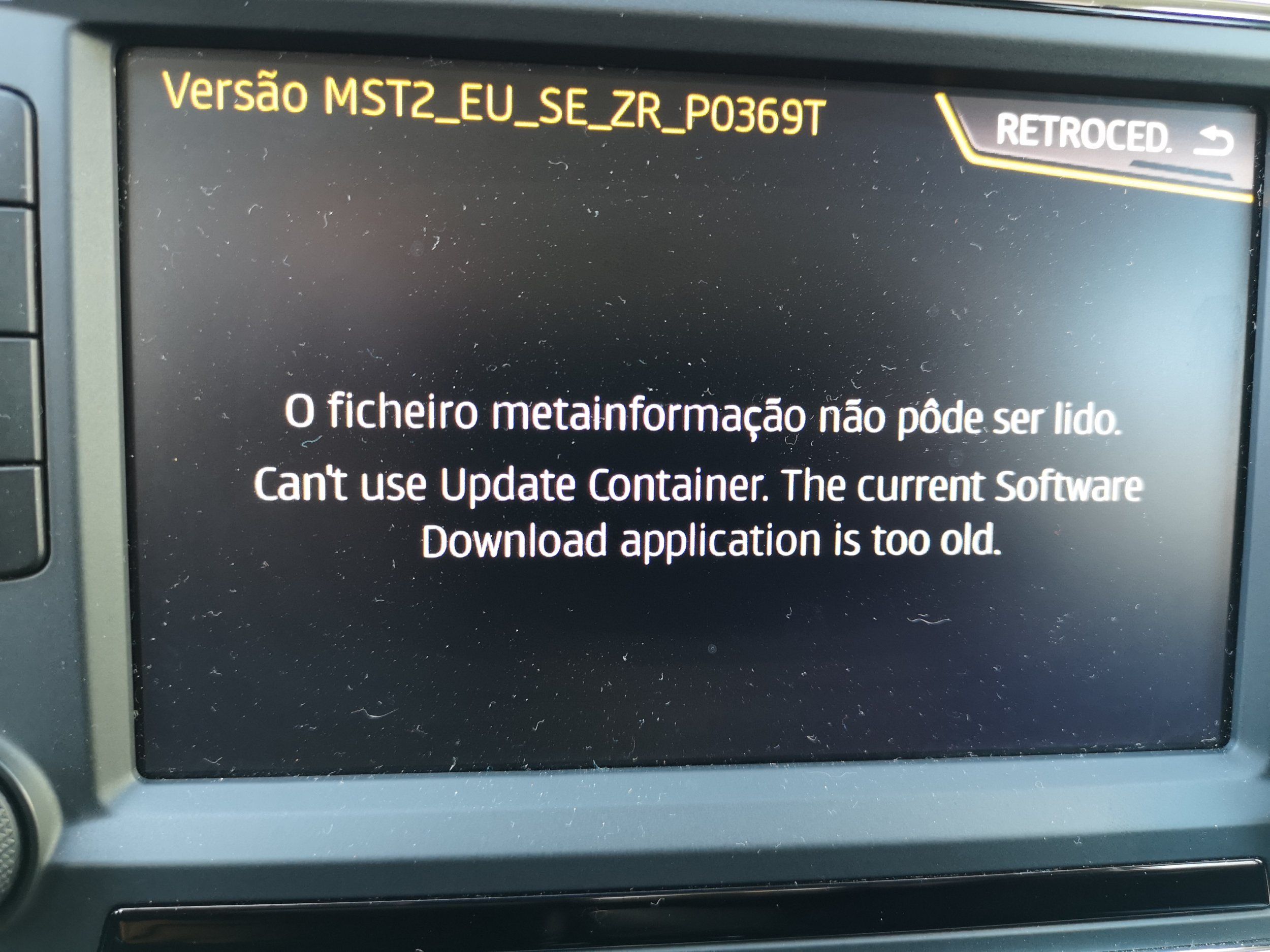

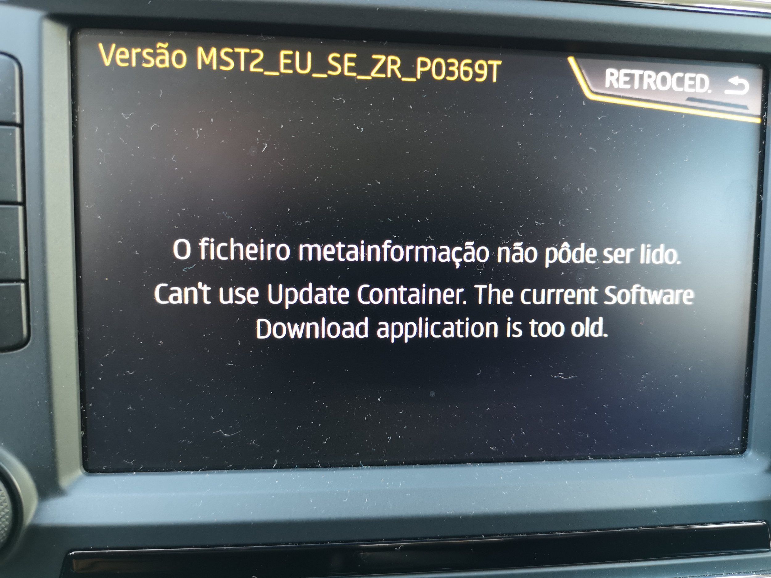

Hi,
Just have a MIB 2 with the following settings
SW TRAIN : MST2_EU_SE_ZR_P0346T
MAIN UNIT SW : 0346
NUMBER: 5QA035846A
No expert in this kind of jobs....so a newbie, but already updated main unit twice.
Looking for the best advice in order to get Full Link unlocked and activated...if i have to update to another version and patch, if i can patch with this version strait away and with what tools, what do i need to accomplishe that...any advice would be much appreciated.
By the way...some advice no keeping the engine running, some advice that car must be without engine running... any reasons for that?
greetings from portugal
update to 0369 , then use patch without cp off you can get all for free on mibsolution one
Strait forward? And do you recommend engine running or just ignition on?
Just to figure it out
First MST2_EU_SE_ZR_P0369T firmware
Second SE_ZR_P0369T_FEC_ALL_CID_OFF_CP_OFF_SPORT_FIXED patch
Both files from mibsolution
Sorry about bothering
Just an aditional question... Do i have to make modifications in mibsolution one SE_ZR_P0369T_FEC_ALL_CID_OFF_CP_OFF_SPORT_FIXED patch or it's just uncompress and install?
Cheers

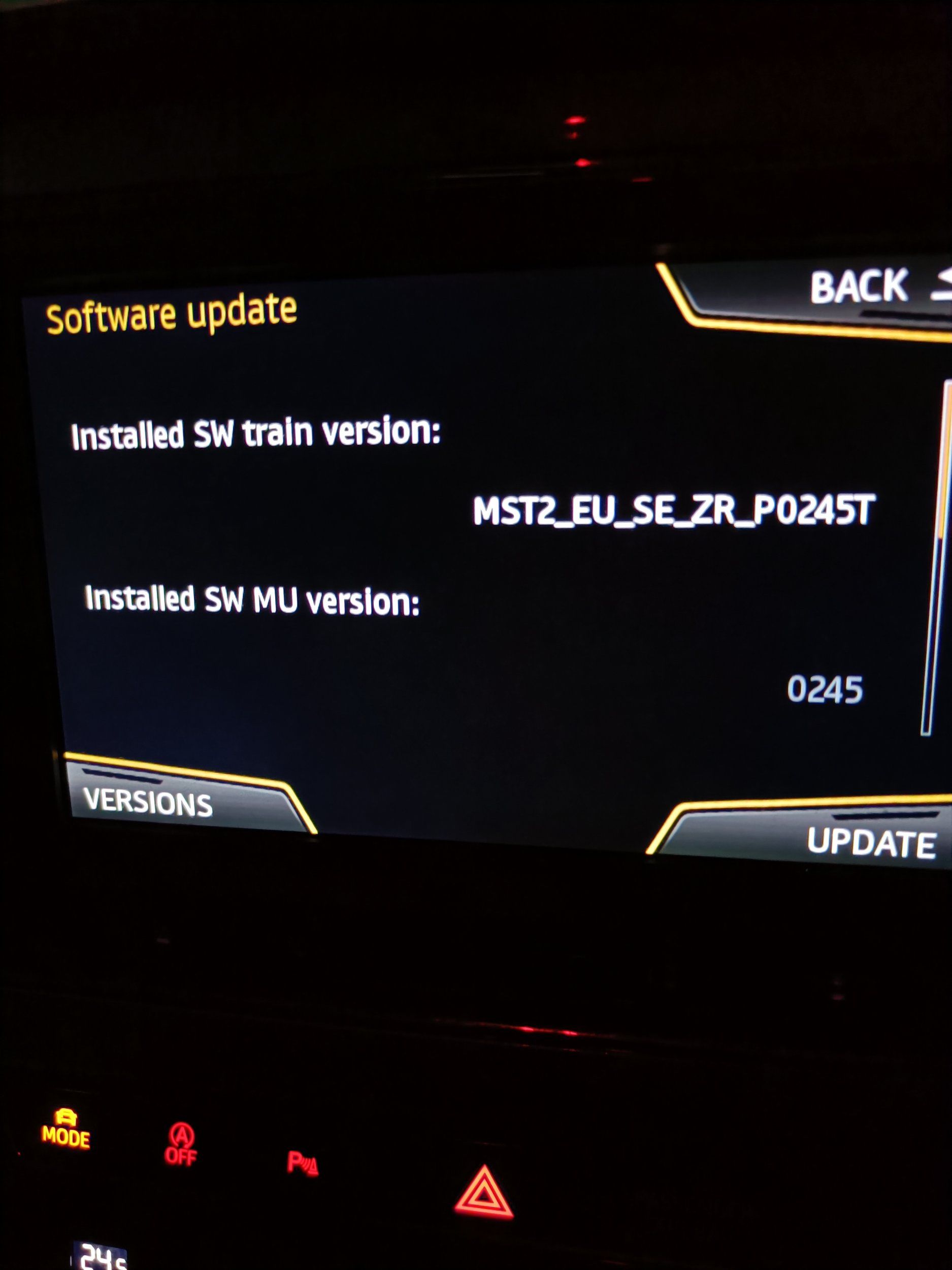

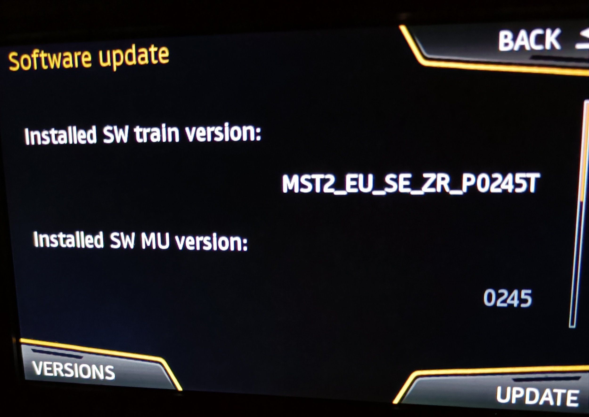

Can someone advise me on what version I can upgrade to. Here is my current software:
