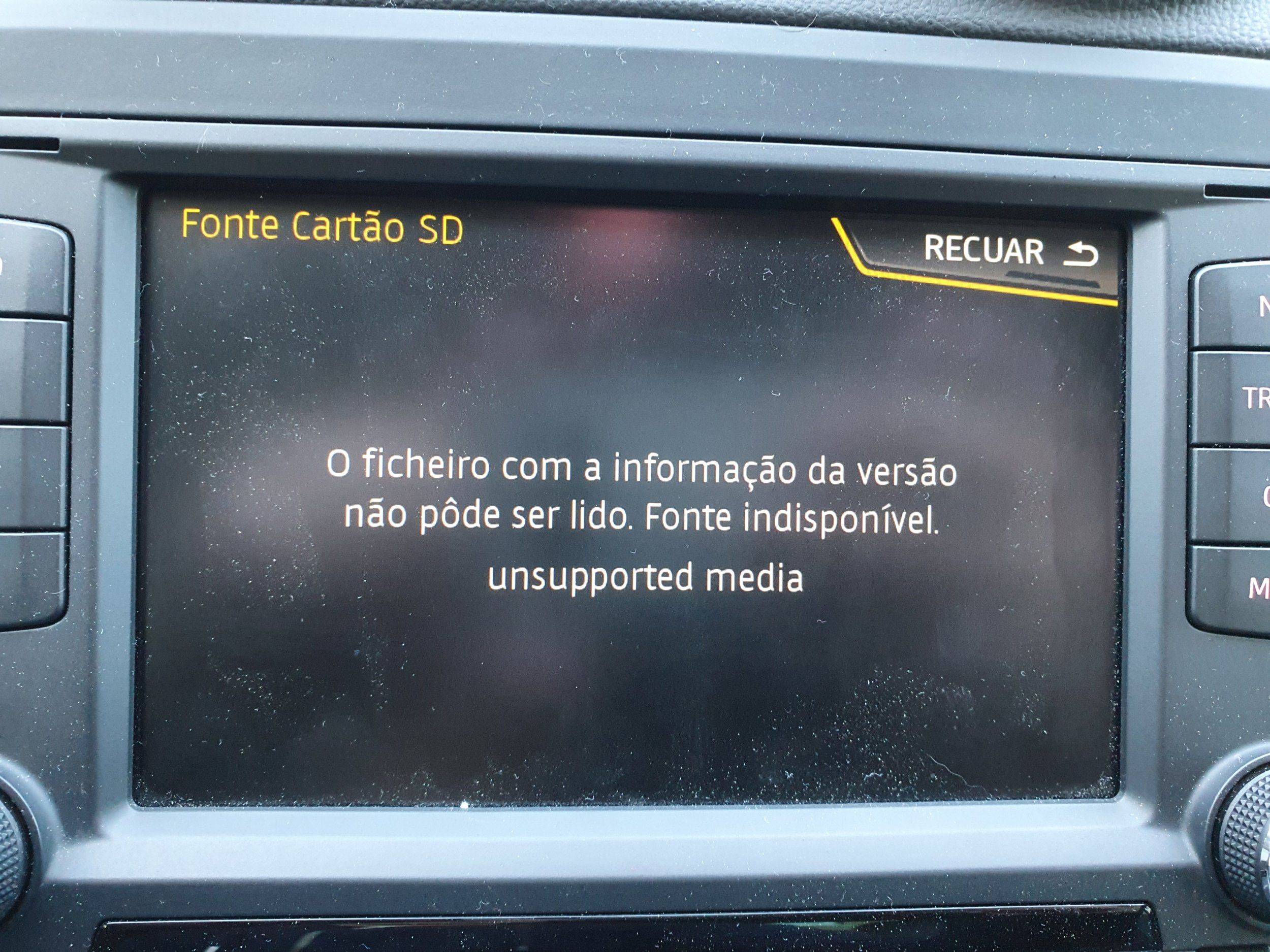

Hello guys someone can help me?
I have Ibiza, my infotainment is
MST2_EU_SE_ZR_P0245T, and i want to update.. i put my SD Card with update, but it show me this Message:
Obrigado, mas diga-me, meu carro é MST2_EU_SE_ZR_P0245T.
Qual devo instalar primeiro?

Sorry, but i dont have 253.. i have 252

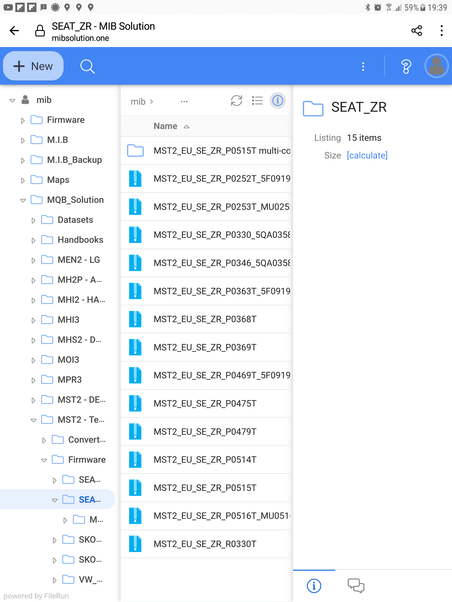

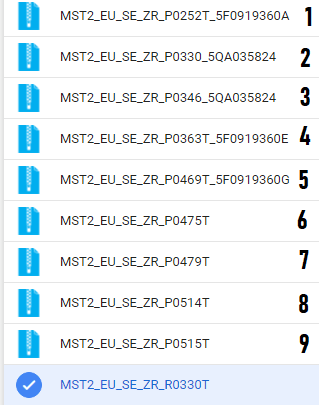

This is the order I should install right? Why can't I go from 0245 to 0515 .. ?
Can i install direct 0515 version?
I currently have: MST2_EU_SE_ZR_P0245T
I saw this video and the guy updated it straight to 0330...?

You cant instal 515 you are on the 2** train, you can't jump trains.
253 is the last version according to the experts that created the database

Normaly you can go up to 0346, but take care when you go from 02xx to 03xx, you can brick your device. So it's prefer to keep 0253...
