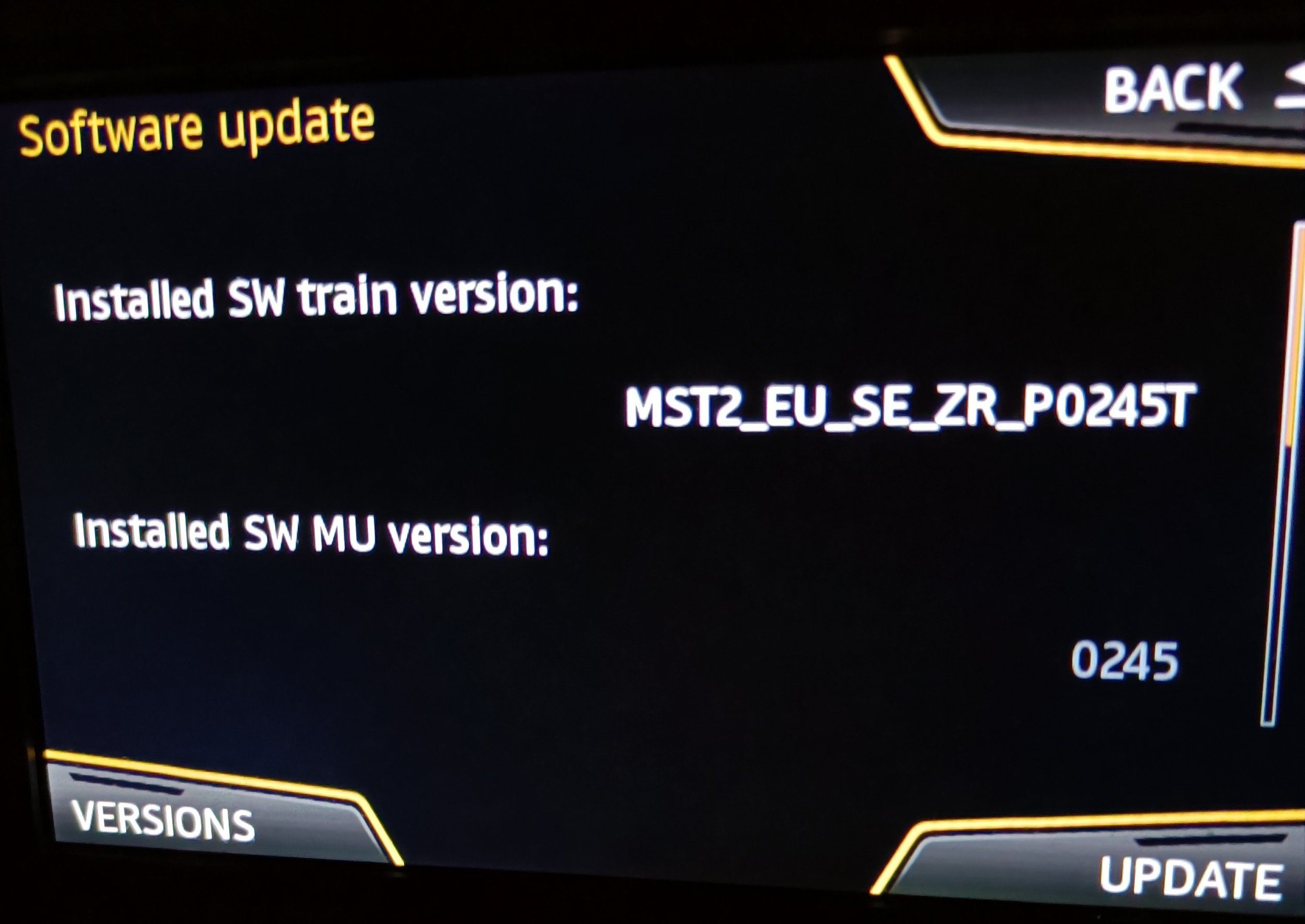

Can someone advise me on what version I can upgrade to. Here is my current software:
Reckon 253 on the link
Guest, guest is the password to open that link. Second one down after the directory. Sufficient greater than what you are on, you can't go on the non 2 series yourself.

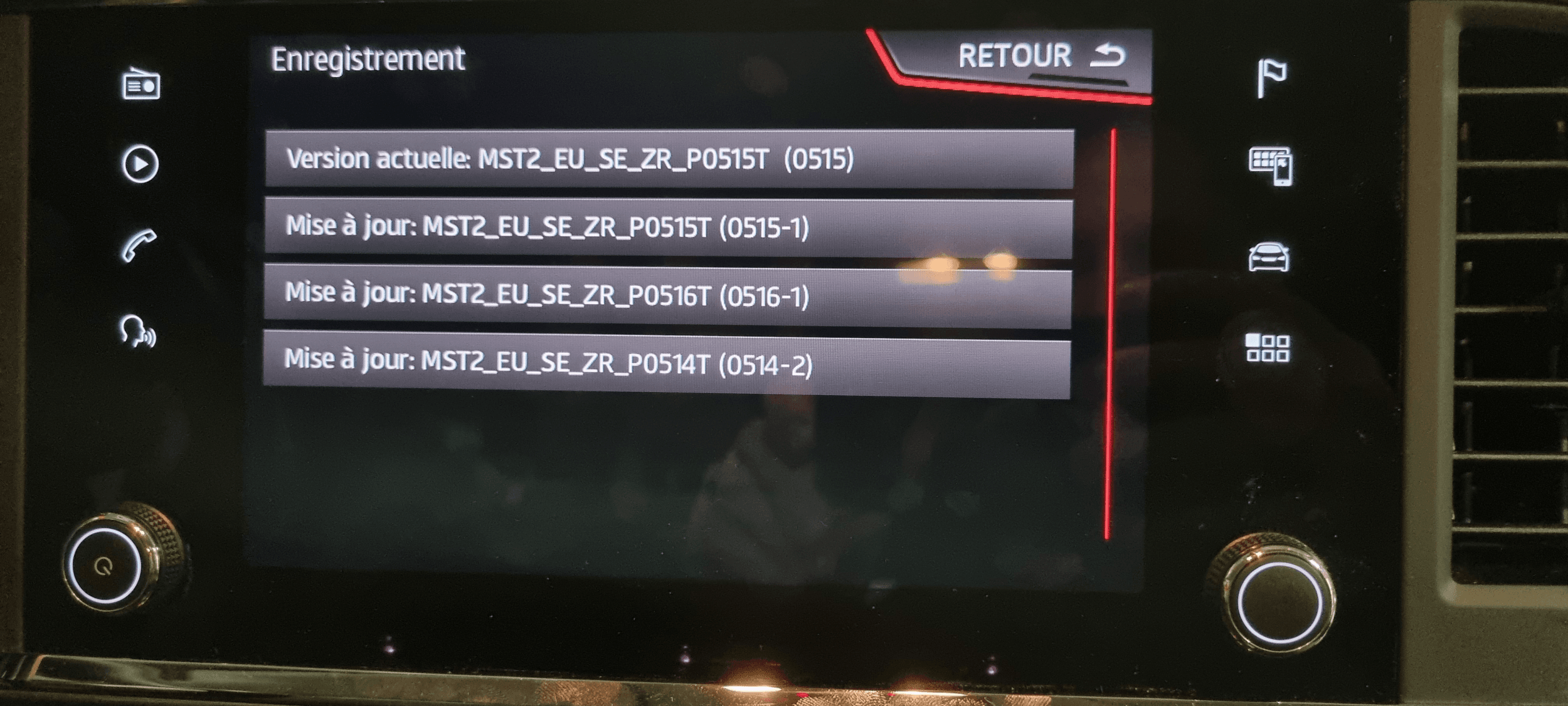

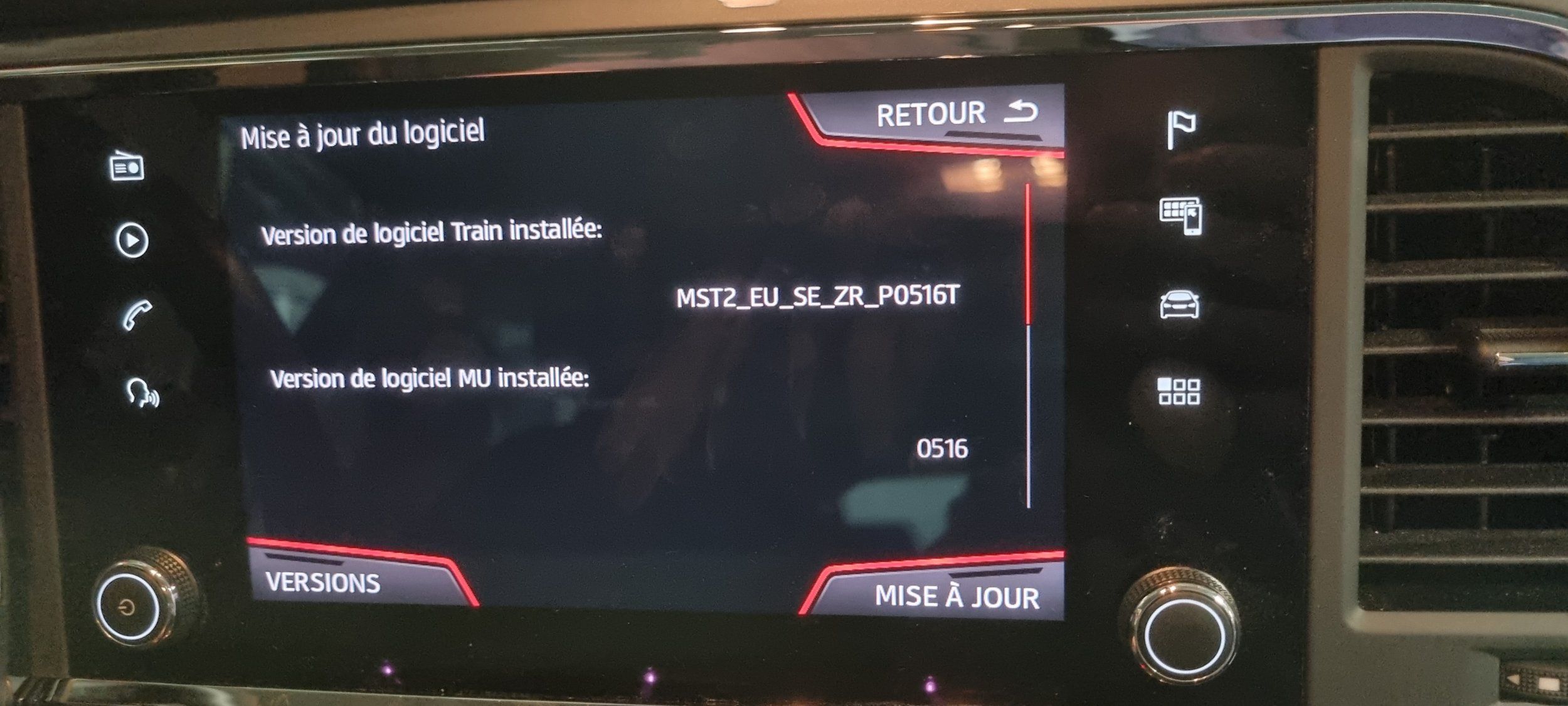

Hello,
I'm trying to revert to 515 from 516 also, but I don't understand how.

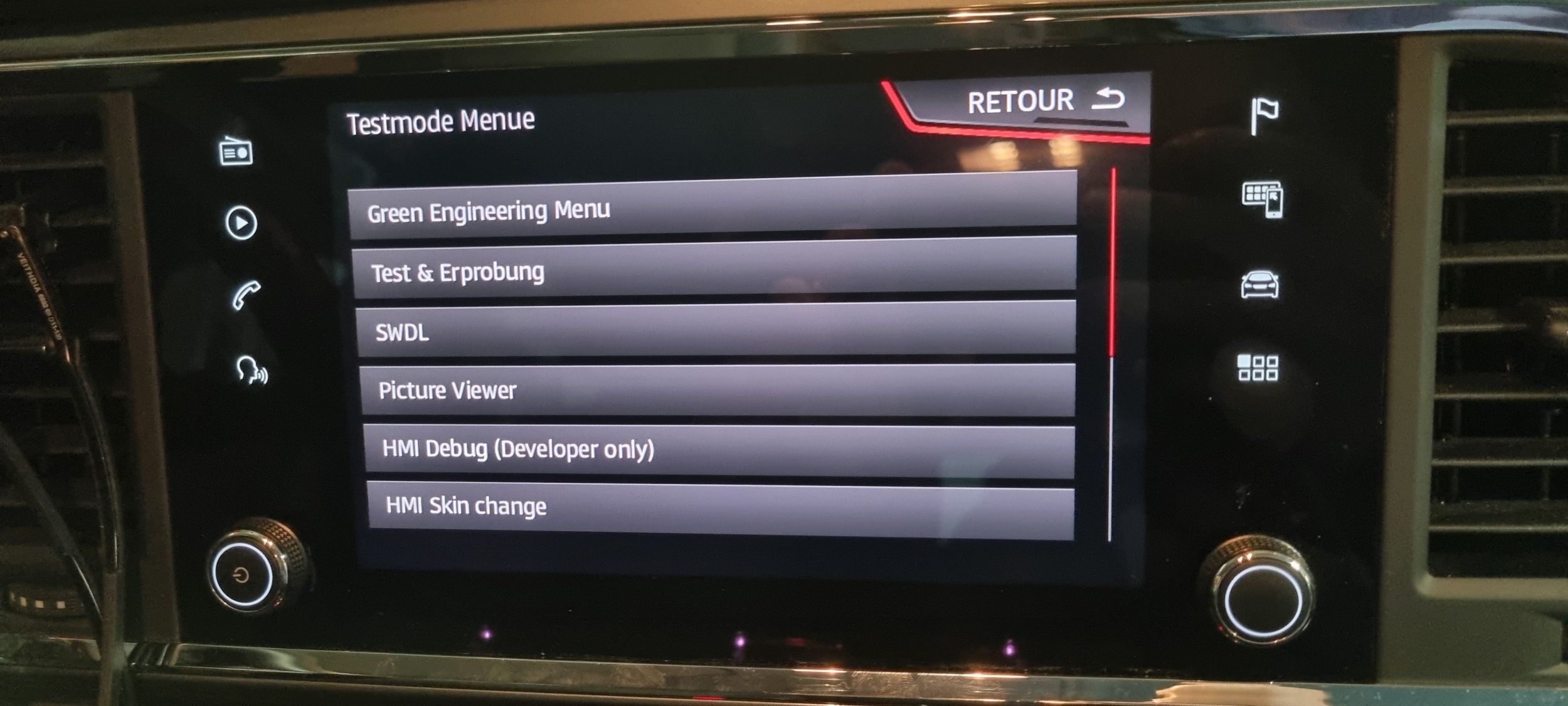

My upgrade button is grey, even if i use SWDL menu. Here is what I'm doing :
I push SWDL button

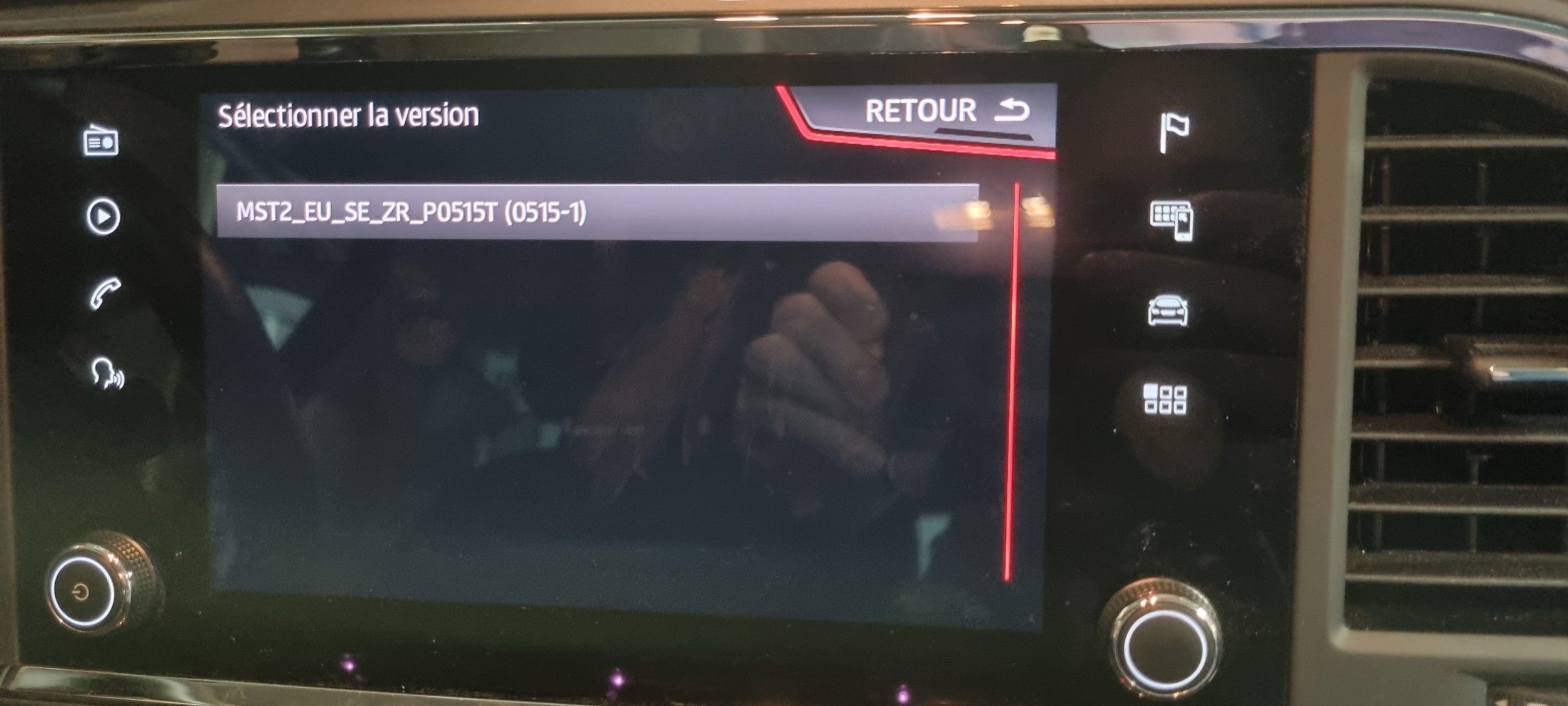

Then "Start Download", it shows this screen :
And push "Update" (at the bottom right)

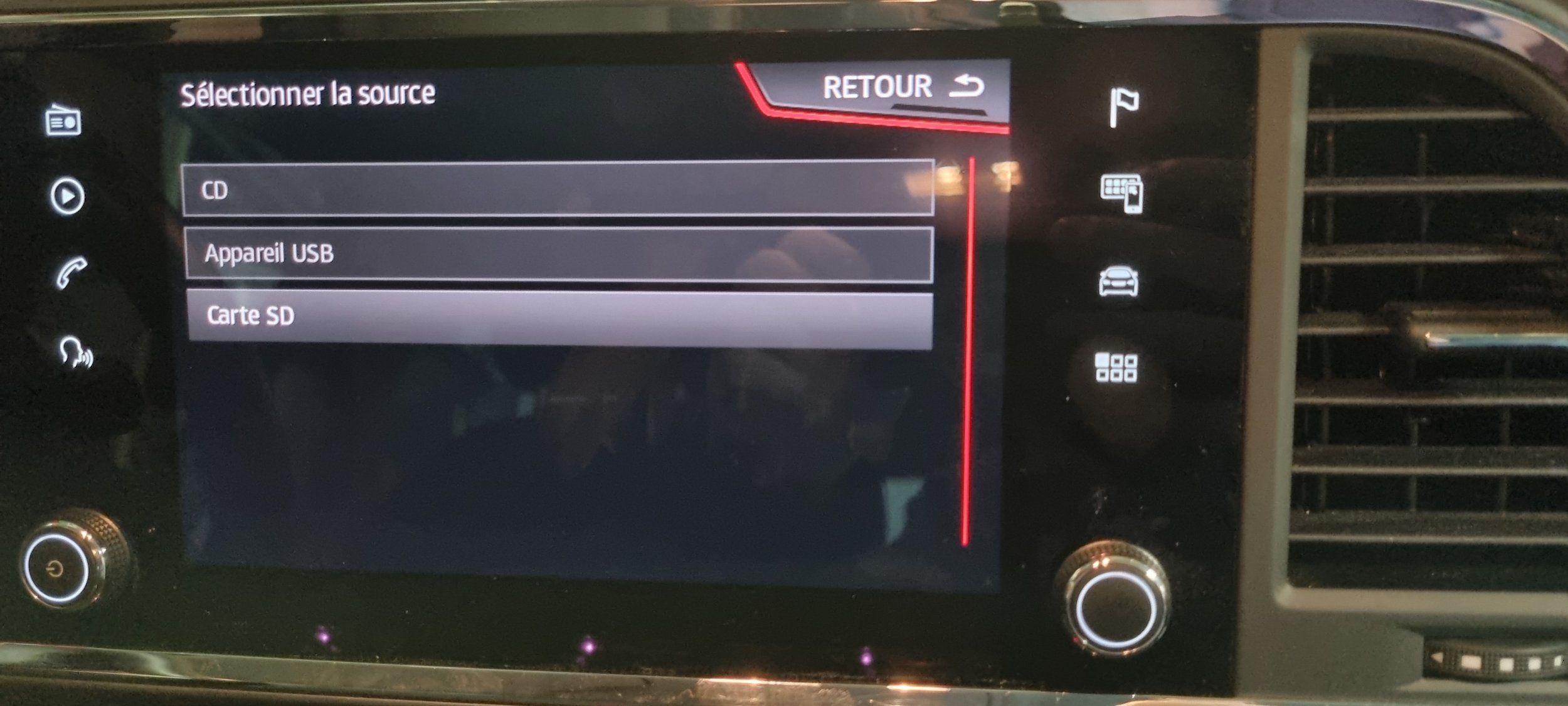

From SD Card
It's the 515 version that i want to used

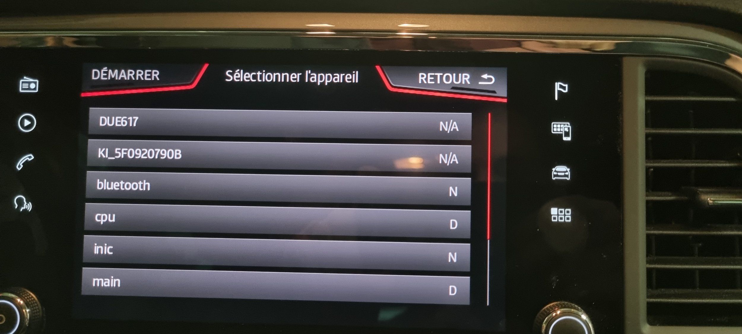

But I can't do the update, the upper left button "Start" if greyed out:
I've read that i have to "select all", but I don't know how.
Can you help me ?
Thank you !

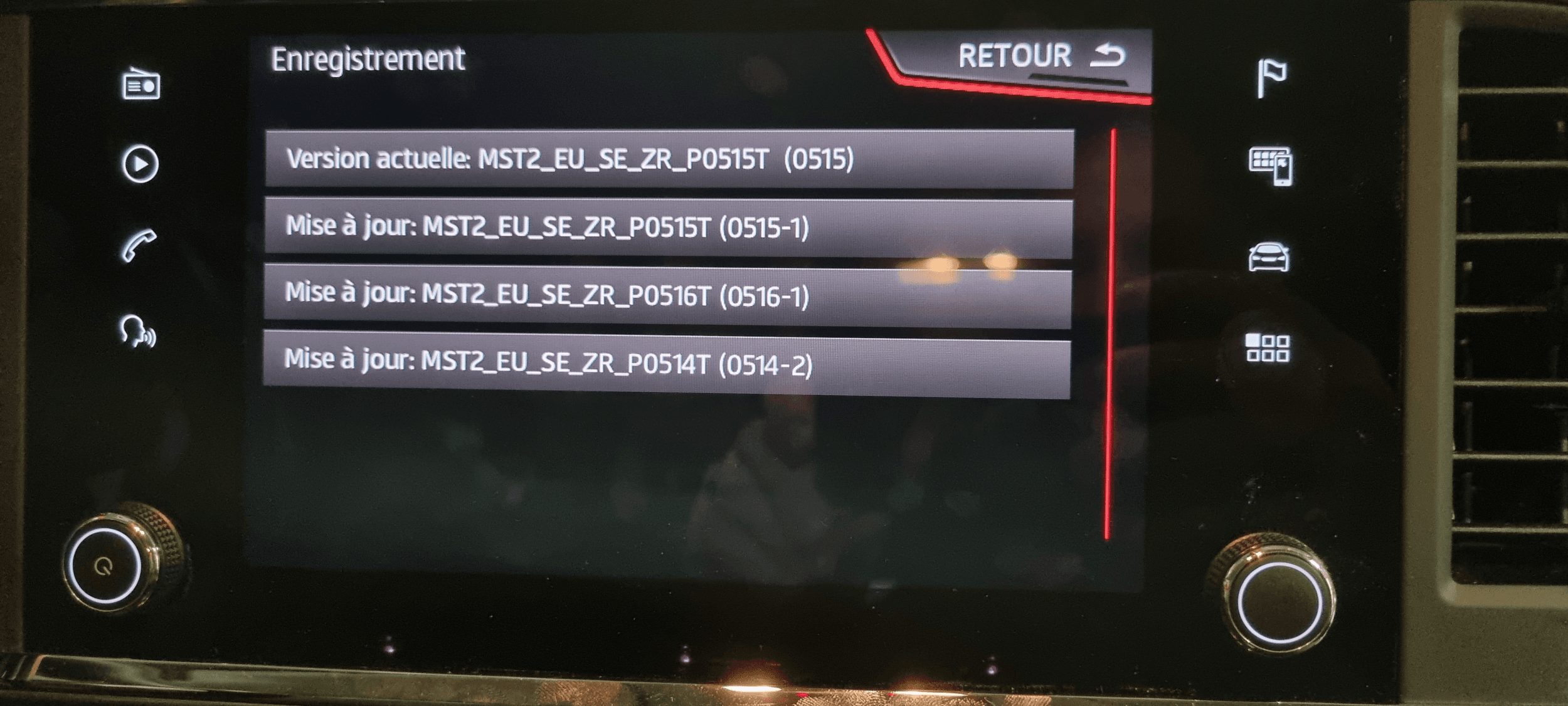

Kawaz.
Well to force a full 515 downgrade I suggest you hit "software download manual download", then you select all (on top right or left from memory once in there), then back out and then press start download (from my memory). By selecting manual download and toggling all in that, it forces "all" once you get back to that screen again. That top button toggles between an auto update or a manual one which allows downgrade or specific entities to be updated. If you back all the way out you have to start again. (Too much stabbing of the back button)
Well that is how map updates work in SWDL in the high. It's how that menu works but dont blame me.... but it is how a full forced software update was done on a high unit when it was decided by the expert here that a complete install should be done. It was on the SWDL menu it was forced by judicial use of the manual overide.
The other way is to just toggle the ones marked as D to update and leave the rest alone. D means it's got an update. N means it hasn't. Again that's how incremental updates can be done on high maps when I've experimented in the past. F is not good after its done it, means fail. Oks or N after is good. It's got no more to do.
Over to the firmware update experts if that doesn't work or it gets messed up... one poster has atleast reverted to 515.
Thanks a lot for your answer, but... I can't pass the first step ?
When I hit Software Download Manual Download, nothing append.
Don't know why and what I can do.
Top button
Then
Start Download
That as I recall toggles the option to pick all or the attributes. If you don't hit the top button then it's like a normal update off the front screen. Way back on the posts it's what we did with someone. That's what you should find.
I'll have a look in the car tomorrow if you haven't worked that menu out by then.
Top button
Then
Start Download
Here is what i'm doing :
I've checked that I'm in developer mode with obdeleven and it's ok.
Mystery !
Yes it's the one you pressed, then press the one below (start download). It's just a toggle to say do it manually.
@Slickric21 I believe downgraded to 515 from 516. See if we can get them to come in.
After you have selected do it manually and press start the buttons below it should change revealing an all type of button, hit that.... step back and do it or something like that. You have to dance around the buttons. In the manual mode you can pick off each entity to update or select that all button... then as I recall you step back and just press start download. I know I've step back too many times in the past and come out of SWDL... so certainly reverse comes into it... somewhere ?.
I go into that menu every 6 months to do a high map update since I like to see what's going on. Saying this I am using SWDL on a high unit but will be similar.
Don't forget you need enough power to keep the unit on once it starts you can't stop it.
Ok I post an illustration of the SWDL menu, look from "Some screens"
You see the select all... and read on. So you want to do that on your firmware. The post above was part of my exploration of the mib2 high navigation update, that's all history now since we know you up date the navigation FeCs.... but is an example of partial and full updates using the SWDL menu.
The all important screen with select all on it, poke it it and start.... how you do it in a mib2 high. Will be the same. Ps since nobody is saying you don't do a 516 to 515 down grade this way we'll assume its the way.
Reactions: Walone
YES !!
Thank you !
With your help, i've succeded the downgrade in 515, I hope to have less android auto reboot now.
Thanks again !
YES !!
Thank you !
Thanks again !
Glad it worked for you. The all powerfull yet idiosyncratic SWDL menu on the manual toggle. As I said that was an example of its use... but not one you'd use on navigation updates but the one I cut my teeth on.

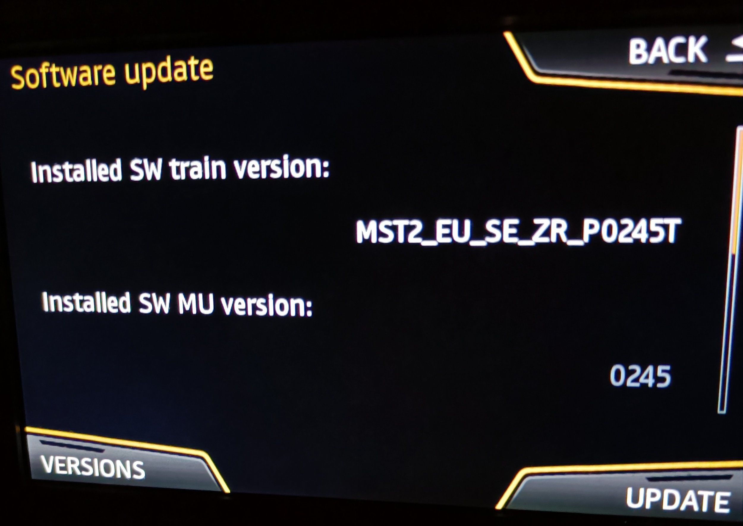

Hi guys, is there a newer sw version than this? Been experiencing some glitches lately. Ignore the old maps. I only use android auto so I don't really care about them.
5F0035877
H50
0514
6P0919866AF
1030
ECE1 2018/19
SHIELD 2016-44 (build 309)
