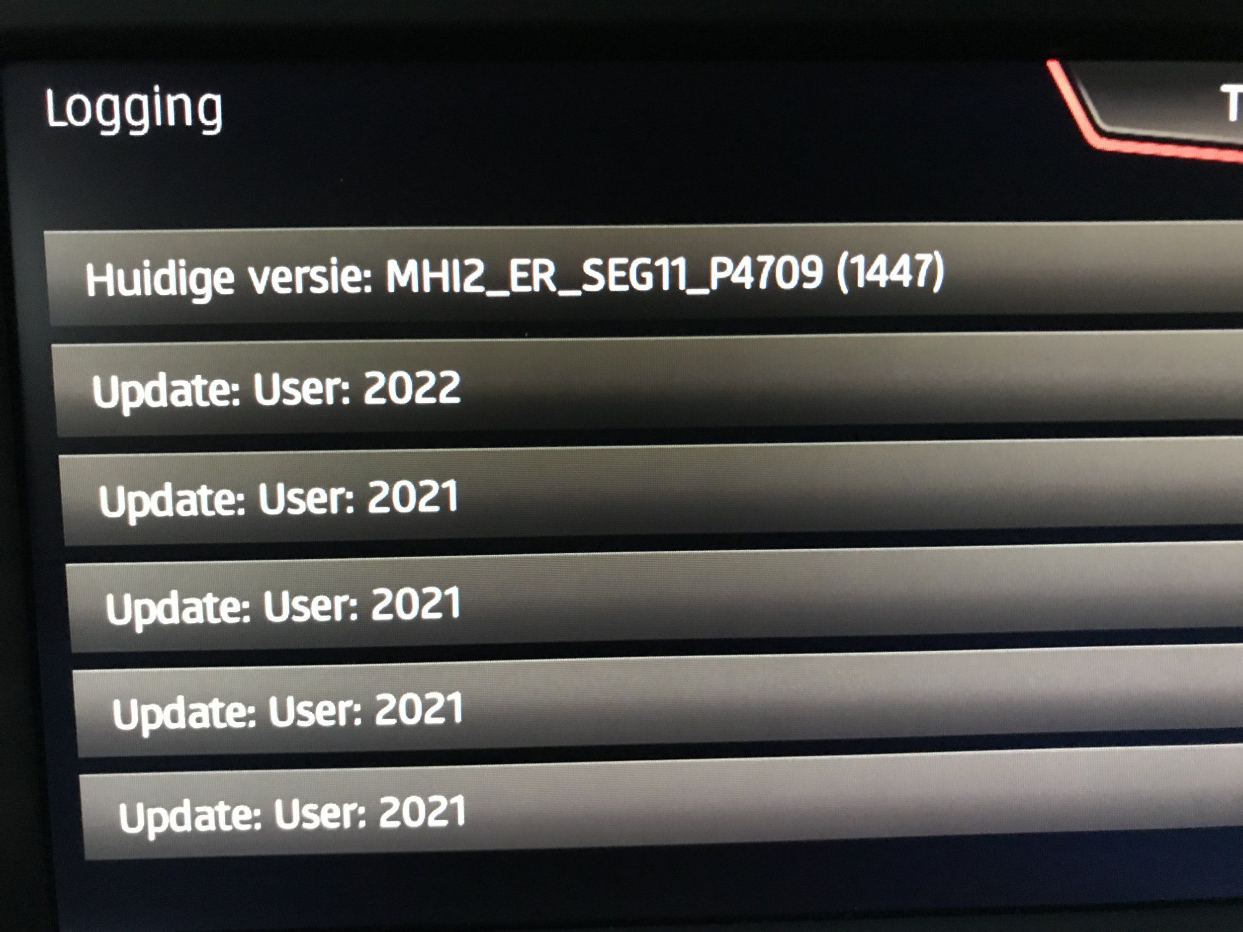

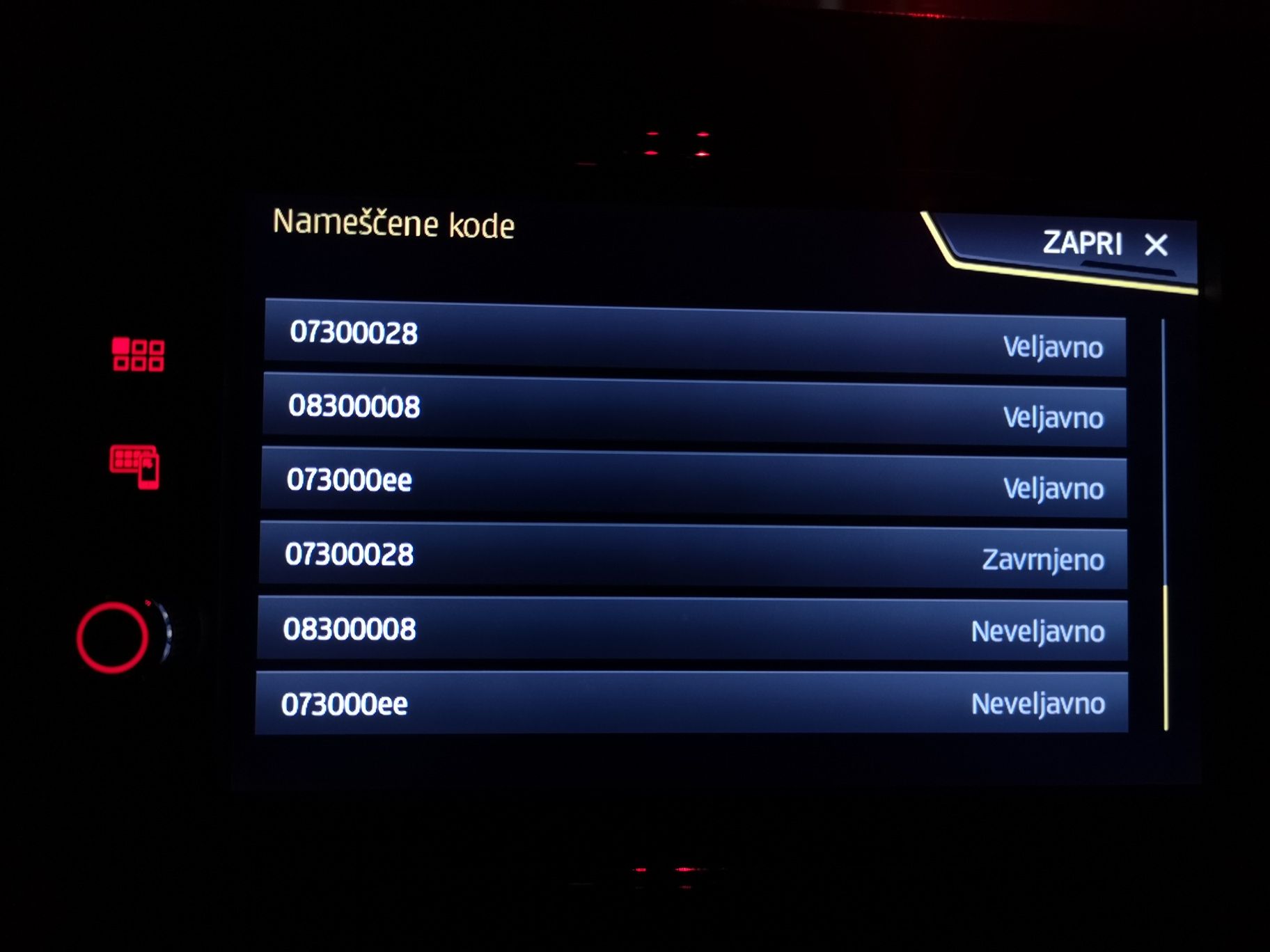

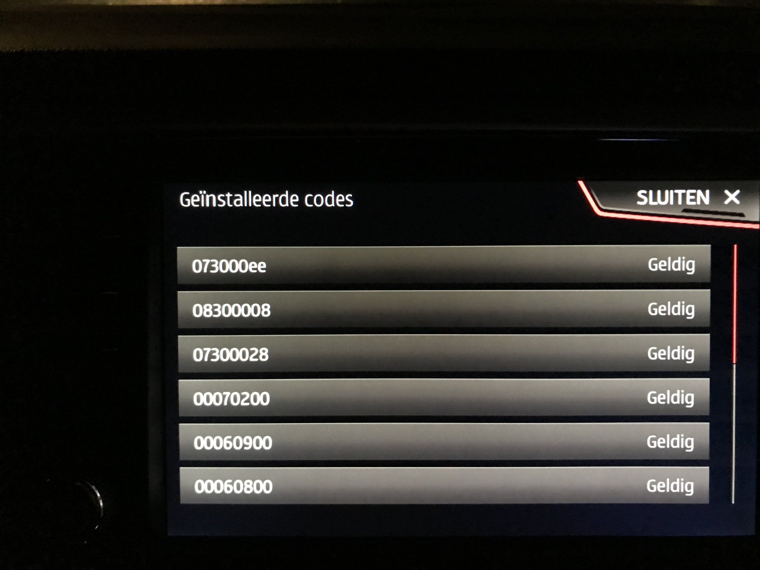

About my FEC's. Im write that I have one 07300028 NOT VALID but this is not true. It is REJECTED. Today Im see that there are 3 states: Valid, Not Valid, Rejected...
Veljavno=Valid
Neveljavno=Not Valid
Zavrnjeno=Rejected
Today Im install MIB tool, and by mistake patch FEC before Firmware patch. Can I somehow delete that Not valid and Rejected FEC's?

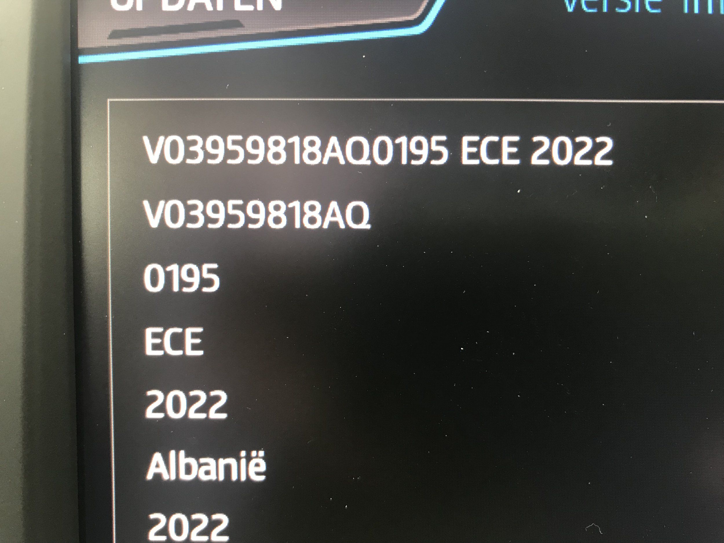

Tomorrow I will try update maps to 195 but I don't expect issues because it already show me progress that map 2022 is detected and not show error...
Thanks for all help.

This one could be one for the experts.... odd that you get it recorded twice. The ee one is the life long FeC so see where it goes thru, why you get double entries I pass on that. Before you didn't have any valid ones for the map you were loading up. Now you do, but still get the odd list.
Suspect your dealer messed something up... The experts will know. Whether it's workable as is to be proved.
Reactions: _Dejan_
Im make mistake that Im do all this tired... Im install MIB and make backup in the morning. Then in the evening when I had some time check menu and select "Add new Fec's to FecContainer.fec" Then unit reboot and there has been new navi FEC's 073000ee and 0830008 but both NOT VALID then Im remember that in the morning didnt patch firmware and Im run patch "Flash patched image". And it add another new navi FEC's 073000ee and 0830008 with VALID state.
So now I have 073000ee and 0830008 with VALID state and 073000ee and 0830008 with NOT VALID state...
If remember right Im see on youtube one video how can FEC's be removed on patched unit... Need to check again...

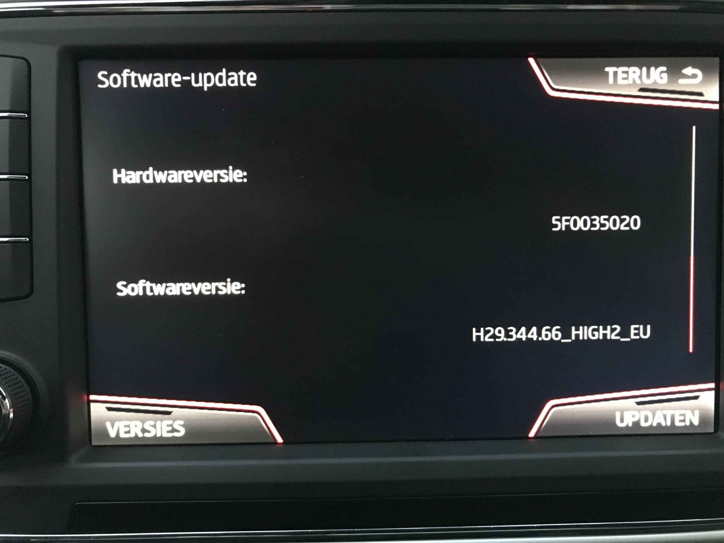

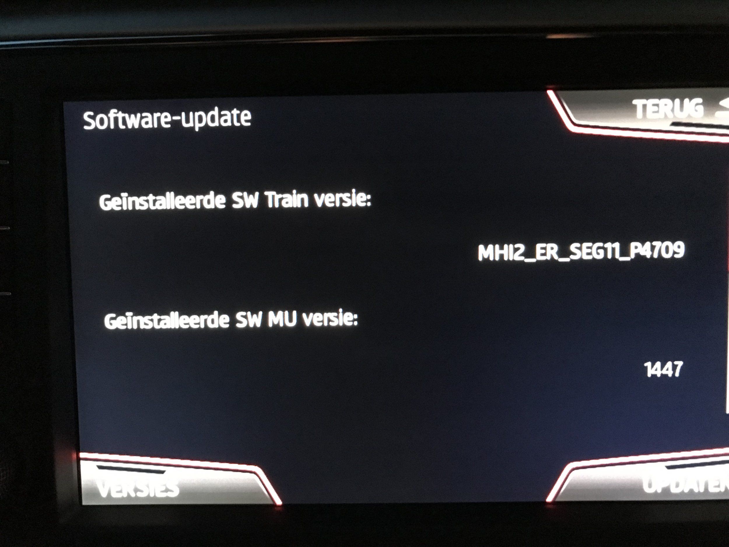

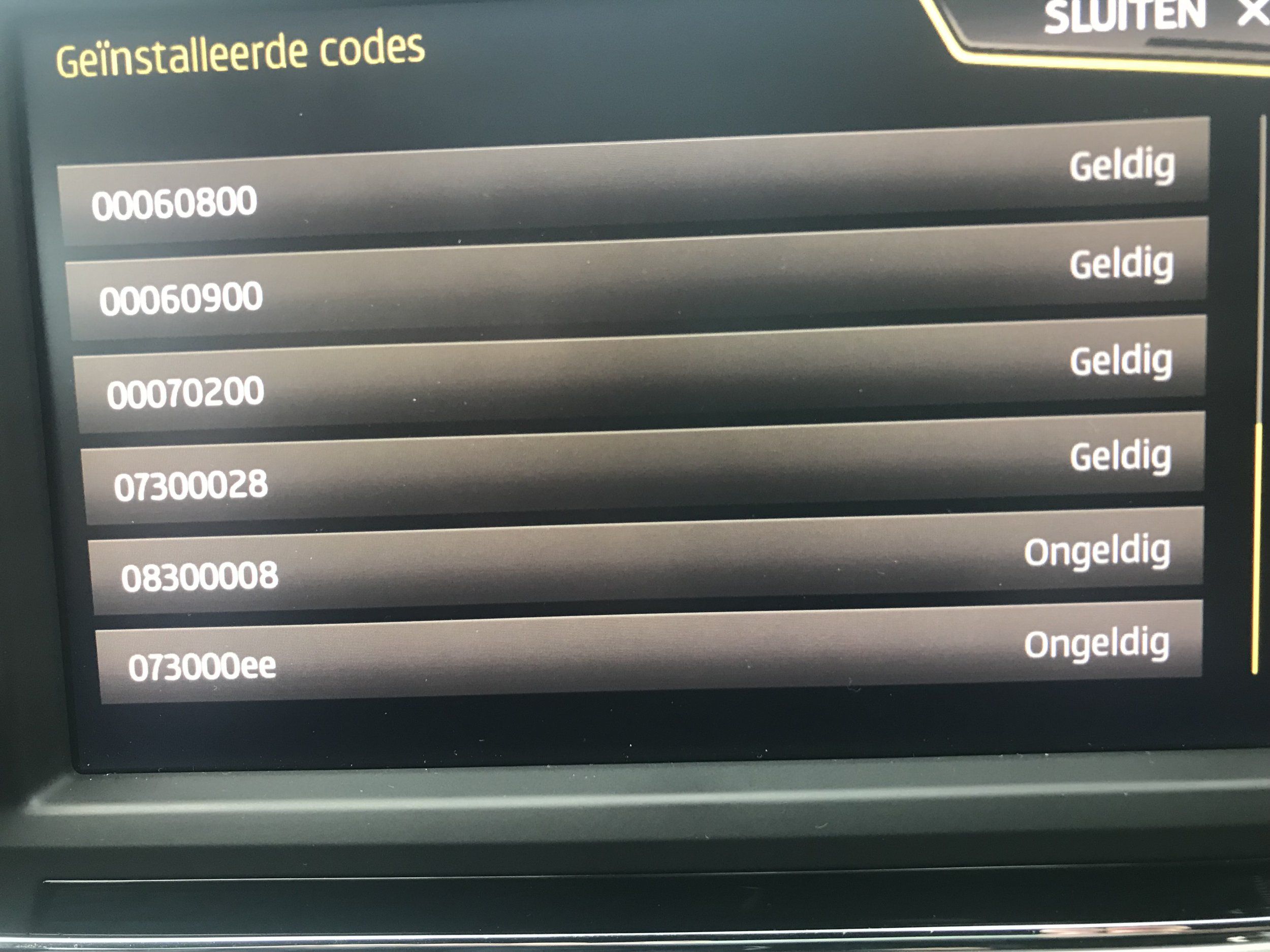

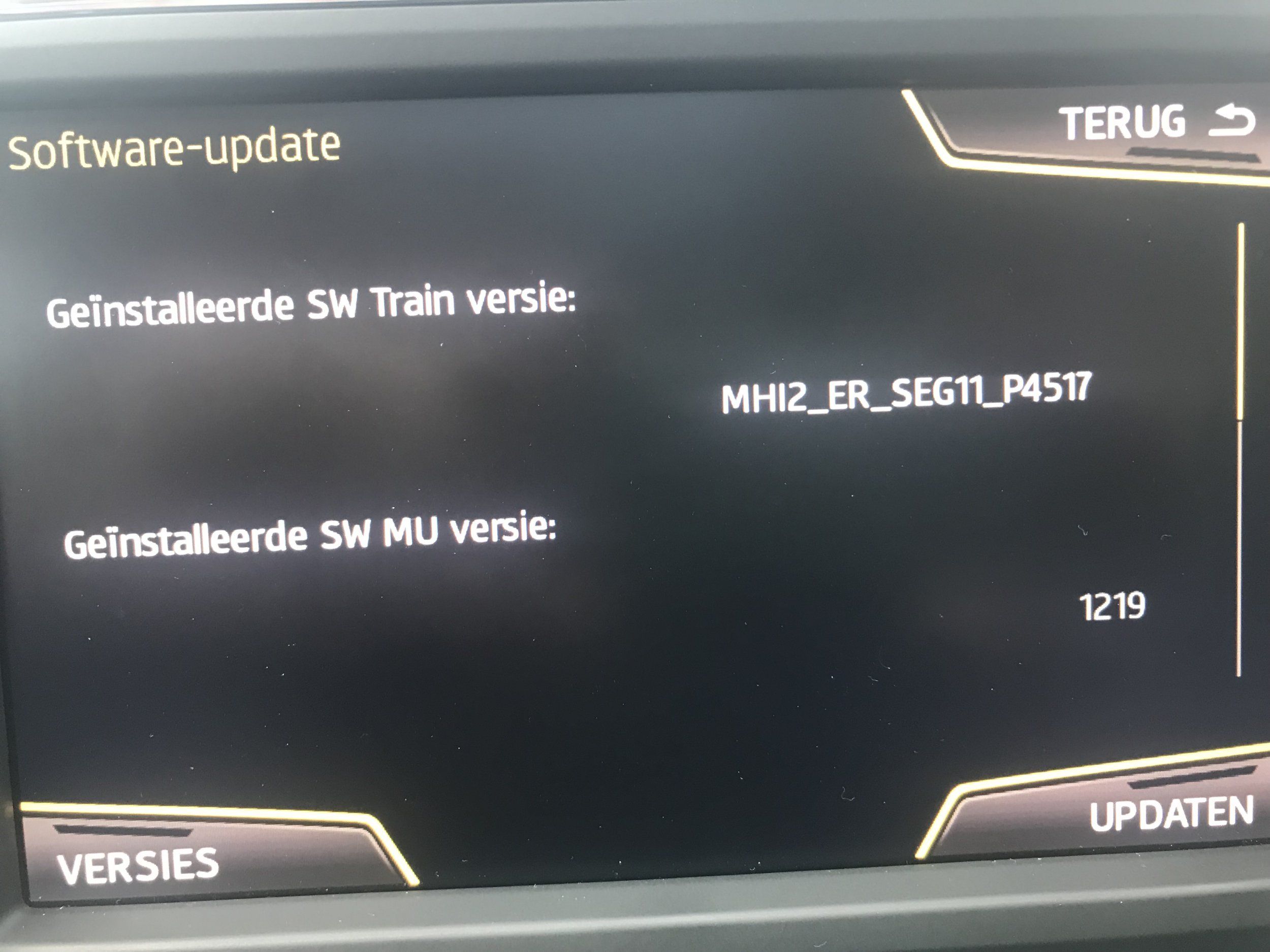

Hi guys,
I need some support from the experts.
I used M.I.B and run the patch however I have missing FECs
After reboot install latest P195 maps.
System says the map is invalid
I also would like to install the latest software: FM2-H-N-EU-SE-MQB, FM2-H-ND-EU-SE-MQB
Any help is appreciated!
Thanks,
Marc

@Marc1702
just use the AIO Update to latest FW version.
And share the log from M.I.B.

Well, M.I.B backup will always capture the situation on unit before patching. So, no discussion needed about the state before on unit. One just has to look in the backup.
Deleting invalid FECs is easy. Use the „clean SWDL“ function in M.I.B.
And again, if unit was previously handled by „expert“ run and share M.I.B backup. All information to check on any special treatment required are in there.
Safest solution normally is to run a full SWDL FW update to clean unit and patch fresh afterwards.
Or SWDL the AIO update.
Invalid FECs are often caused by using M.I.B functions in the wrong order.
E.g adding FECs before patching. Due to adjusted patch function and GUI design in GEM, this should happen less with latest 3.1.5 M.I.B.
On already patched units it could be, that MIBROOT was only patched for EL and therefore added FECs will fail.
But all this can be fixed and does not break the unit.
In most cases it is just a cosmetic issue.
Just get in contact here, all can be fixed
And as always, before patching get latest M.I.B
mib.mibsolution.one.

Hi guys,
I updated the software, used MIB and patched the FEC and it seems to be working now. Thanks for your support. Much appreciated!!

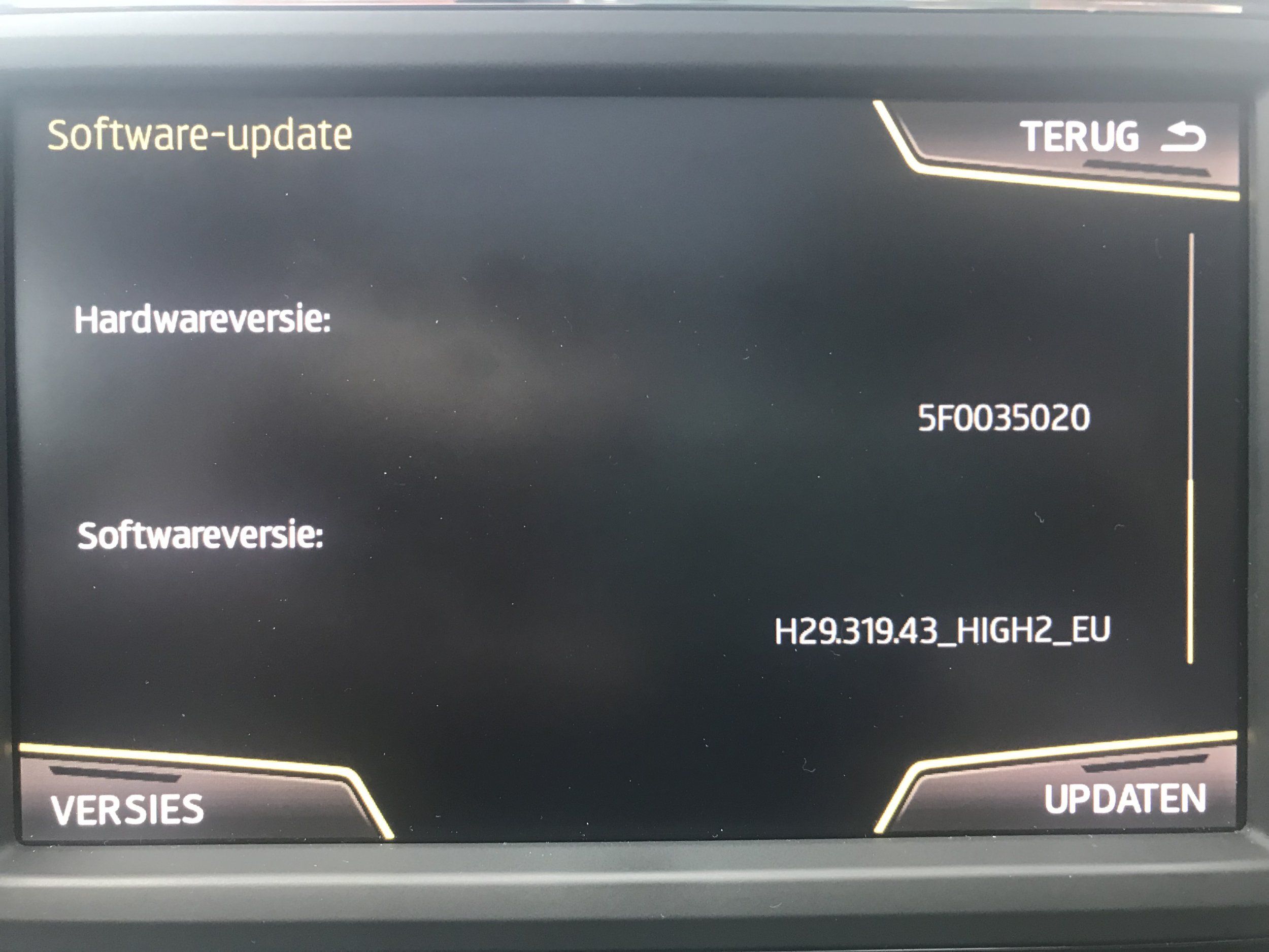

Hi guys,
Sorry but it is not working. See attached pictures of all recent software version and (invalid) FEC. I have quite a few invalid FEC's
