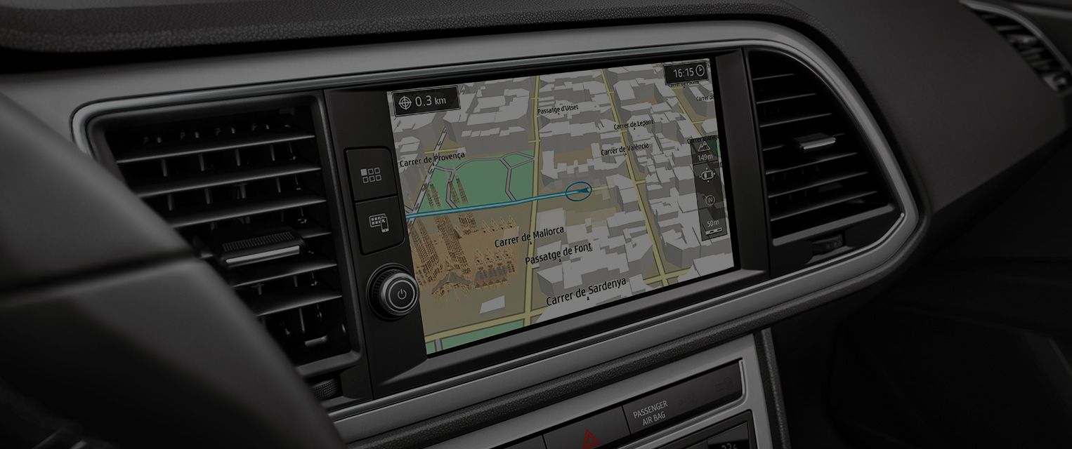

But there is no Music SD card inside... and no USB...
How can I put a demo or a replace mode if the screen is not touchable? Is there a direct method?
I would like to know if is possible to enter in recovery mode and install a new firmware (also, which is the correct one? the Infotainment is similar at the one in the photo... Seat Leon Xperience 2018).
Thank Yoy so much for the reply

I think at this point you are talking about your friend or have you messed up your own system ?. This is the importance of keeping within train on the updates. The updates are within train not across train. So the units aren't designed to be updated from the train they are on to another. 2* say is the train so if you aim for 5* you get a problem. Some retrofitters sell modified firmware that will go across trains but never the less cause issues. Once broken they have to be taken apart and pins shorted. @East Yorkshire Retrofits historically sorted out a number of board posters that messed up their upgrades via DIY firmware train jumping.
If you aren't prepared to take the unit apart you need to find someone who can to do that pin short. You will find recent conversations on the mib2 standard toolbox on the thread here. Hobbyists that have taken the units apart. Only really recently has the mib2 standard toolbox been discussed here that's where they fiddle with the non standard firmware upgrades. All the rest is were where they didn't follow keeping within train or loosing power during an upgrade then find they can't boot up the unit. The source of that issue is wrong firmware, loss of power during the update or fumbling with the mib2 standard toolbox.

The 2018 Seat Leon Xperience infotainment (device number 5QA035846A, hardware H30 and software 0359) has startup problems after using maybe the wrong map update on the SD card.
I would need to understand if there is the possibility of restoring and/or updating the infotainment system even though the infotainment itself does not always turn on and does not react. Is there a method to reset the infotainment system remotely?
