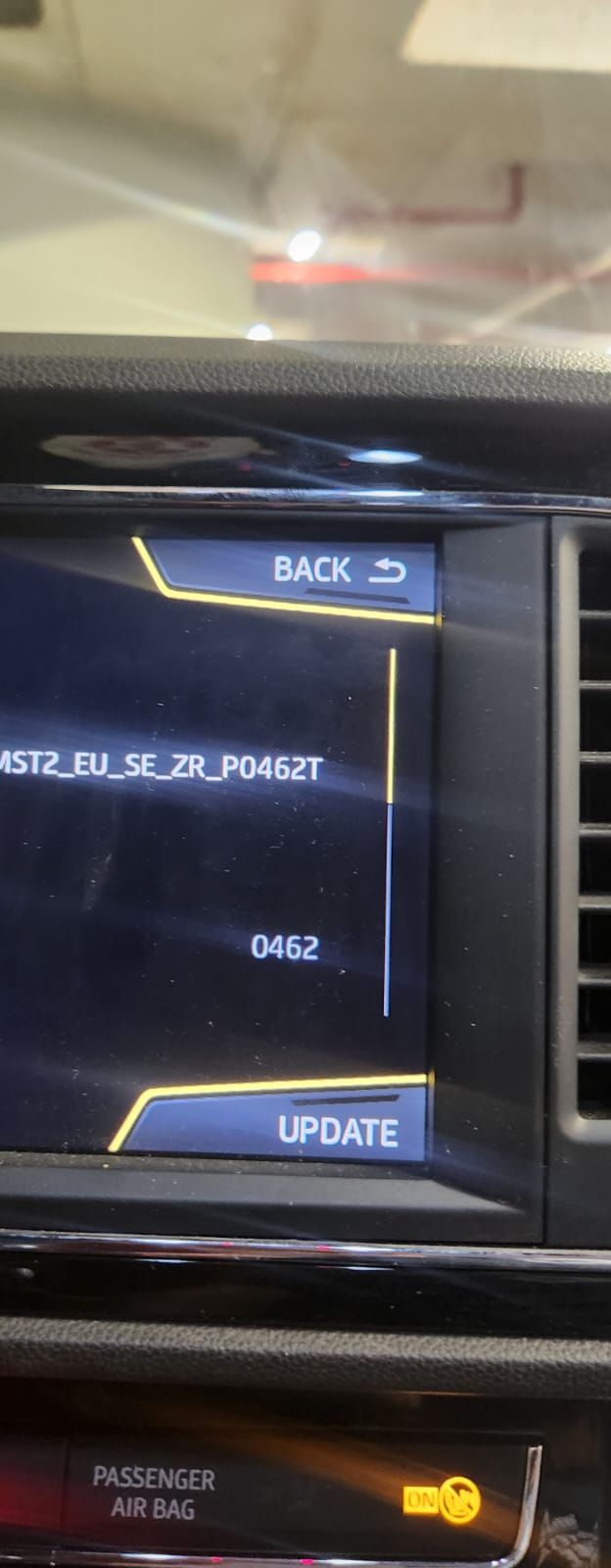

Hey,
Pleasse Help with an update
MY2018 Leon 5f SC FR
MST2_EU_ZR_P0462T
HW0462
5QA035824B
H29.204.28.4_std2plus_EU
Can I jump to 0516T?
I want to retrofit my car to a cockpit and want the update regarding multicolour (when you pick an ambient color, all the infotainment and cockpit changes as well).
P.S.: can someone help me with the performance monitor as well?
I really appreciate any help you can provide.

You are not suppose to jump trains which is what that it is. 4 to 5 is a train change. It's suppose to freeze your unit up eg. Brick it. Other people that have had a modified trains have been told to go back to the old train. East Yorkshire Retrofit a board sponsor here offers an on the bench train updates or they did. See their web site but since you are in Israel tricky I guess. Units which refuse to boot up after they have been messed up have to be taken a part, pins shorted out etc. You find instructions on the net for that. You do see modified trains posted up (not here) but given they can end in trouble, not recommended.
The performance monitor is a FeC change. Pass on that on a mib2 standard. I guess it's in the area of the mib2 standard toolkit not the mib2 high one which does that. Mib2 standard toolkit like the high one has to match the software. Again seems little experience on that one on Seats round here. Mib2 high is more amenable to firmware changes that the mib2 standard and FeC updates.

Thanks for the quick response.
I've tried to look at the toolkit for the monitor performance.
even talked with Eask Yorkshire but can't do it remotely.
so I can jump to 0480T?

I believe on the updates you keep your existing FeCs so if you don't have the performance monitor now you won't have it with 480T. How the mib2 high works, it will be the same. If you find the mib2 standard toolkit that works with say 480T that might be a way of doing the FeC. You need to check which 4 series software that toolkit work with if that's the route. You can upgrade and downgrade within a train but not across. Well that's an idea.

Can you explain to me within train? I need to update what is between 0462 until 0480?
The train is "4" so you can go directly to 480. You can't go legitimately to another train although there are hacked ones about. My understanding the memory is divided into banks so once you try to go off train it sticks in the update. That is when the unit needs to be opened up. Put on a bench and pins shorted. You find that documented on the net.
