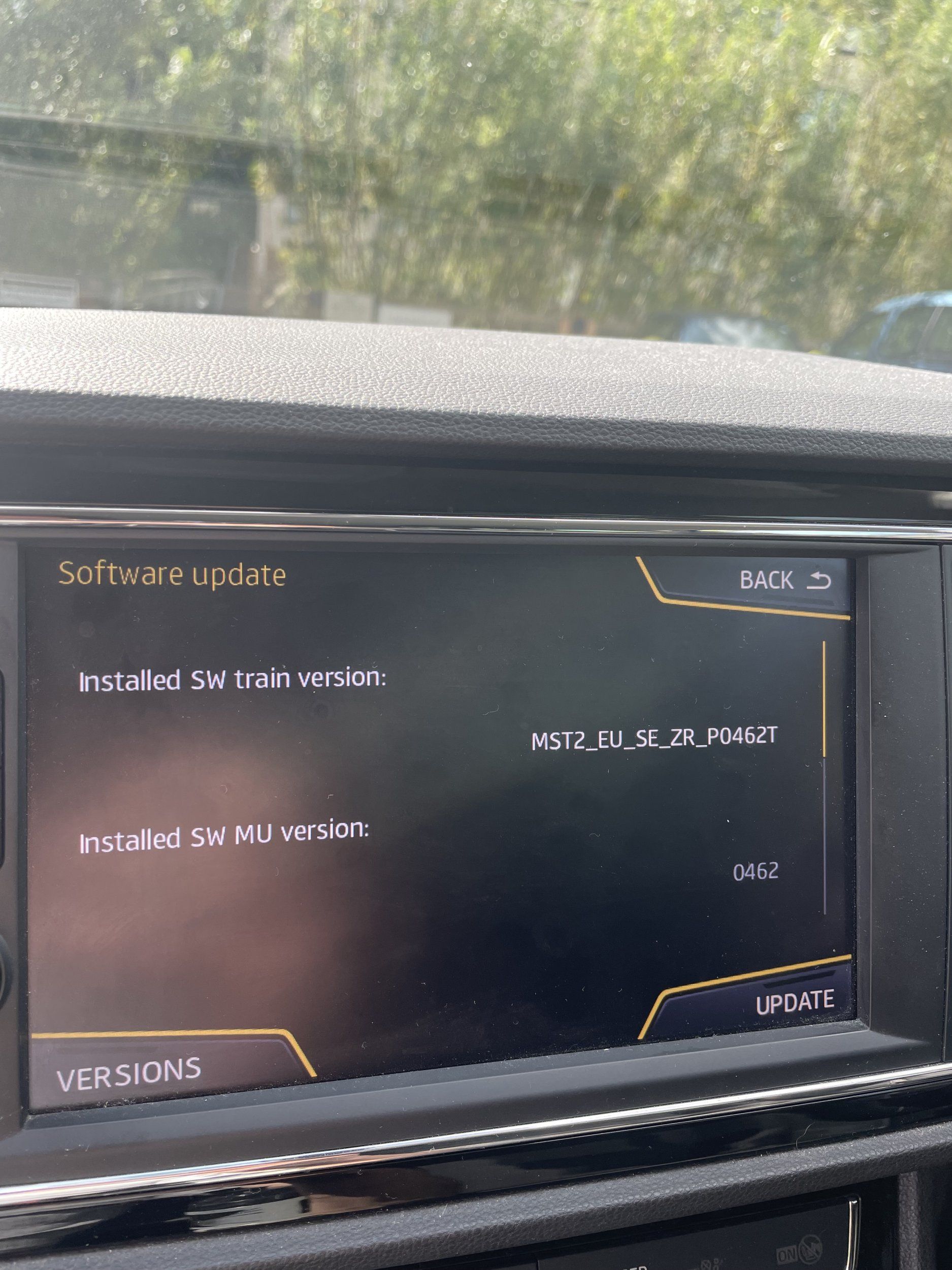

I have a 2017 Mk 3.5 FR MIB 2 with software 0462 (MST2_EU_SE_ZR_P0462T)
I think I can update to: 0480 (MST2_EU_SE_ZR_P0480T)
As far as I can gather this is not changing train, and P0516T is not appropriate if I did not start on 0514?

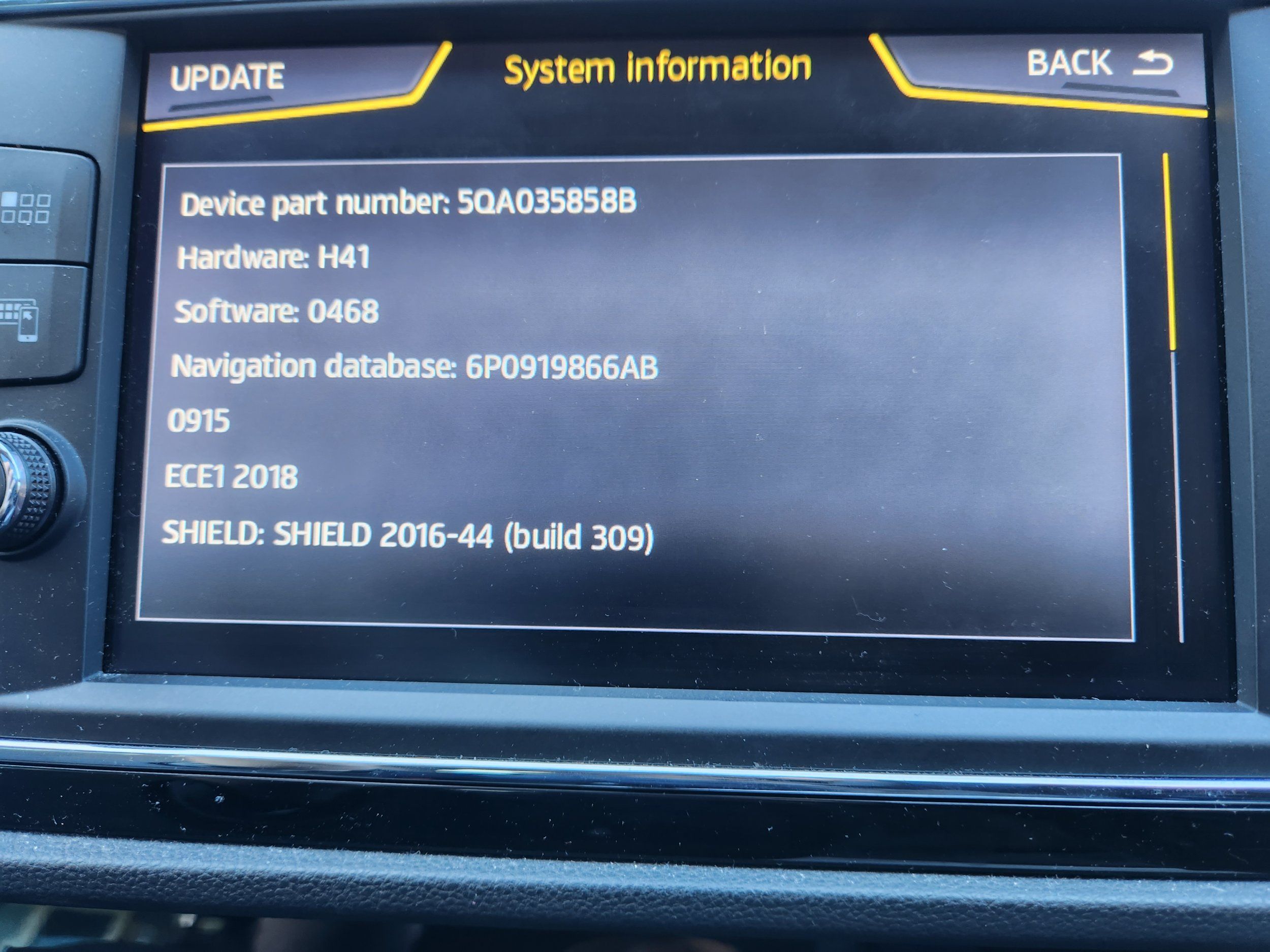

Any ideas what (if any) software updates I can do on my unit? And is it virtual cockpit compatible?

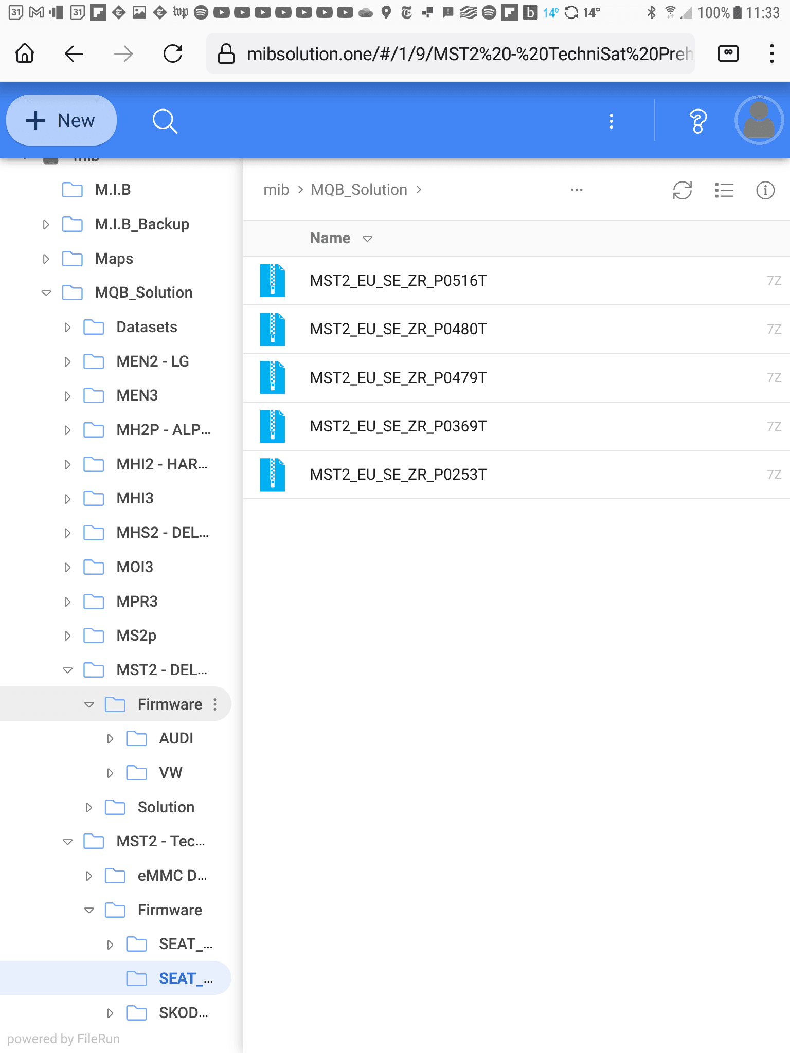

That's a mib2 standard. You can't change to the 5 series, you are on 4 series, 0468 as the picture.
Looking at the mibsolution.one we site, guest, guest
Your options are 480T or 479T. There might be a reason why both are posted. 480T would be the most recent. Generally the updates are for fixes to make things work better like Android Auto etc.
They are to answer that question. You put it on an SD card and keep the engine on or battery charger. Never done it but plenty on here have.
The maps can be updated if you yse them. Details here, you use the workaround, take the link:
Current release is 2010 (June 2023), you are on 0915 which is pretty old, 5 years ago.
