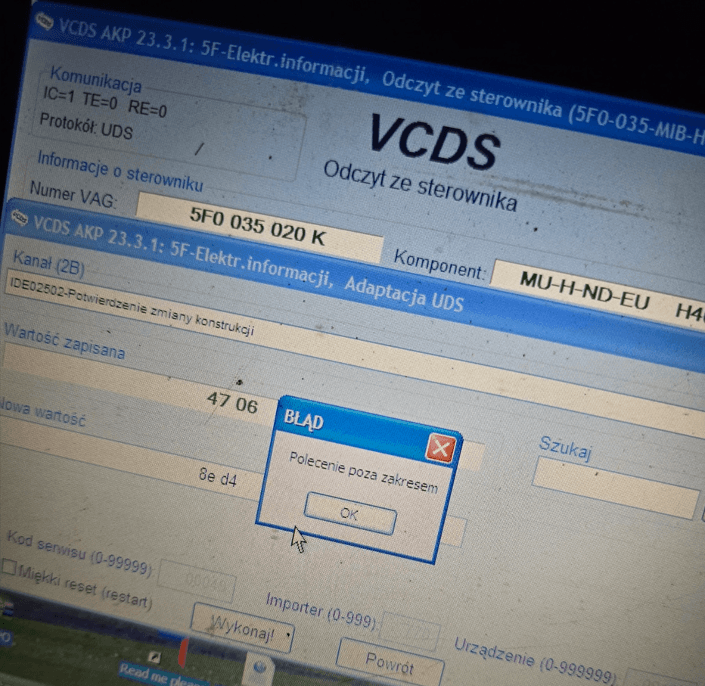

But I couldn't figure out IDE02502 check software ver.. (1555 dtc fix)
I had 47 06; calculator said new should be 8E D4 but no matter how many times I trieid it - Error; request out of range... so I left it like that.

It does ring a bell that I looked at those parameters once. I don't use Android Auto so I'm not the best person on the connect side. It's where the port is conditioned for data. @Walone might know a VCDS owner. Mere obdeleven pro person here...
registered as a developer in vcds?
I'm not sure but he's doing long coding yourself and said that he's updating vcds 1-2 times year. I searched for informations regarding it and it may be caused by UDS protocol? The program is too new?
Reactions: Tell
Pass on the VCDS, it's another world ?. Those are macro scripts that they run. IDE whatever do you pay for that. Just a script that you can do in the Obdeleven Pro but you just type it in. Expect those IDE things are like Obdeleven micro payment apps but VCDS costs you much more ?.... unless you got friends in ?? with dodgy cables. Alliexpress.
