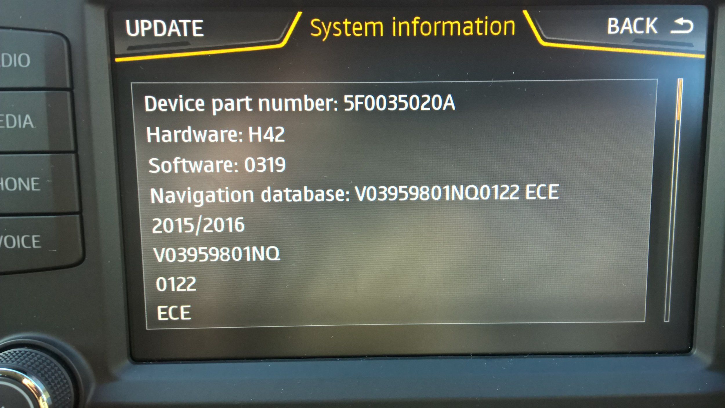

Hi Tell, I had MIB2 High with AA and Carplay from factory,
This was taken a few weeks after taking delivery.

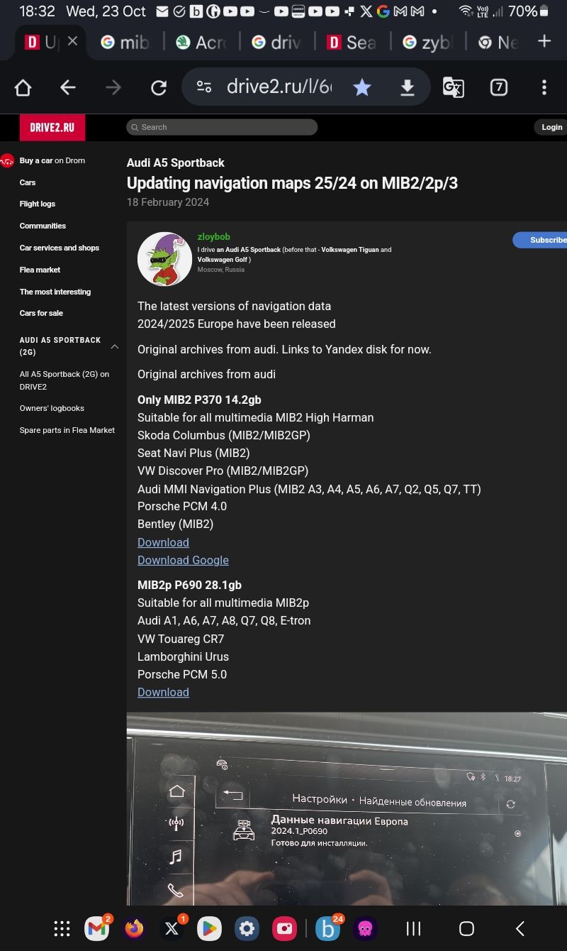

I've just updated maps and all I have left is POI
I've used 350 ver EU(almost 30GB) cuz thats what mib-helper showed me
but on mibsolutions i see P390_N60S5MIBH3_EU 2025 (only MIB2) uploaded on wednesday but idk if that's correct one because its only about 16gb :LOL:
Thanks for help 💪
Tell
Full Member
There are 370 maps last June. I'm sort of waiting for someone to leak 390... the Russian hadnt done it. That may be it. 16gb is because from 370, last June they just package up mib2 high only. 350 and before was a joint mib1 /2 high release. They dropped mib1 high support in 370 hence the small size. What's in the directories is meaningless since their file naming directory stuff is potty.
The mib2 tools github project... there are two... got to remember is name... will type in gives the FeCs in the documentation. You press the appropriate buttons to read off the FeCs. I should have said photograph them before and after. I have given the key combination. Long hold on the menu button. Will give you installed and possible FeCs. You check the documentation.
You should find all the FeCs in here listed
370 follow the links here:
I will check for 390. It's the number I'm expecting in the sequence. We didn't do new mathematics for no reasons :cool:.
