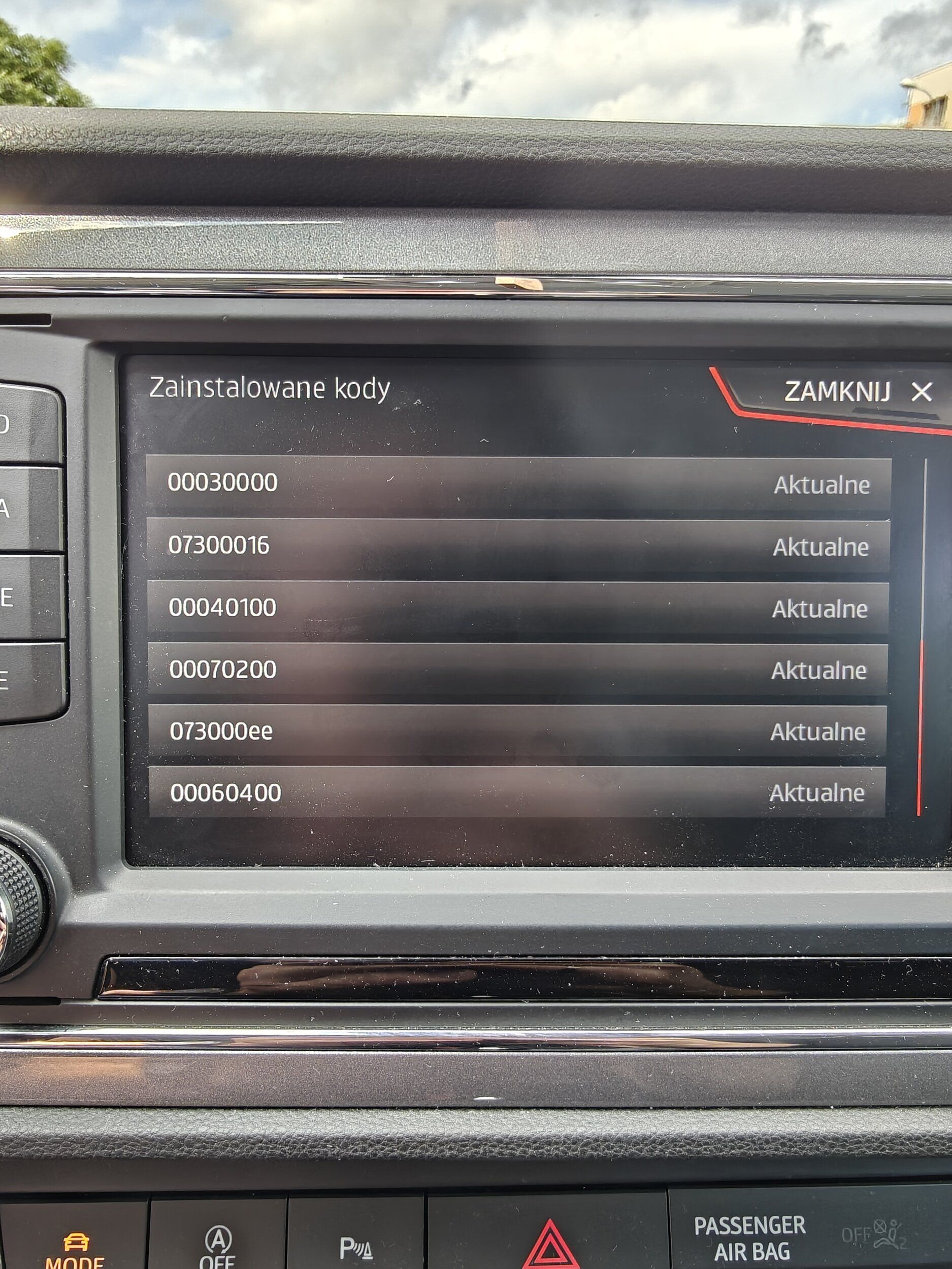

I've checked also my FEC codes and didn't find there "023000ee", could that be the reason why I'm not able to perform update?

The Seat FEC to enable map updates should be 073000ee or 073000ff, mine is the later number.
The software you have is FW 0319, which is the same as mine was when new, I have updated to FW 1409, the HW is H42
