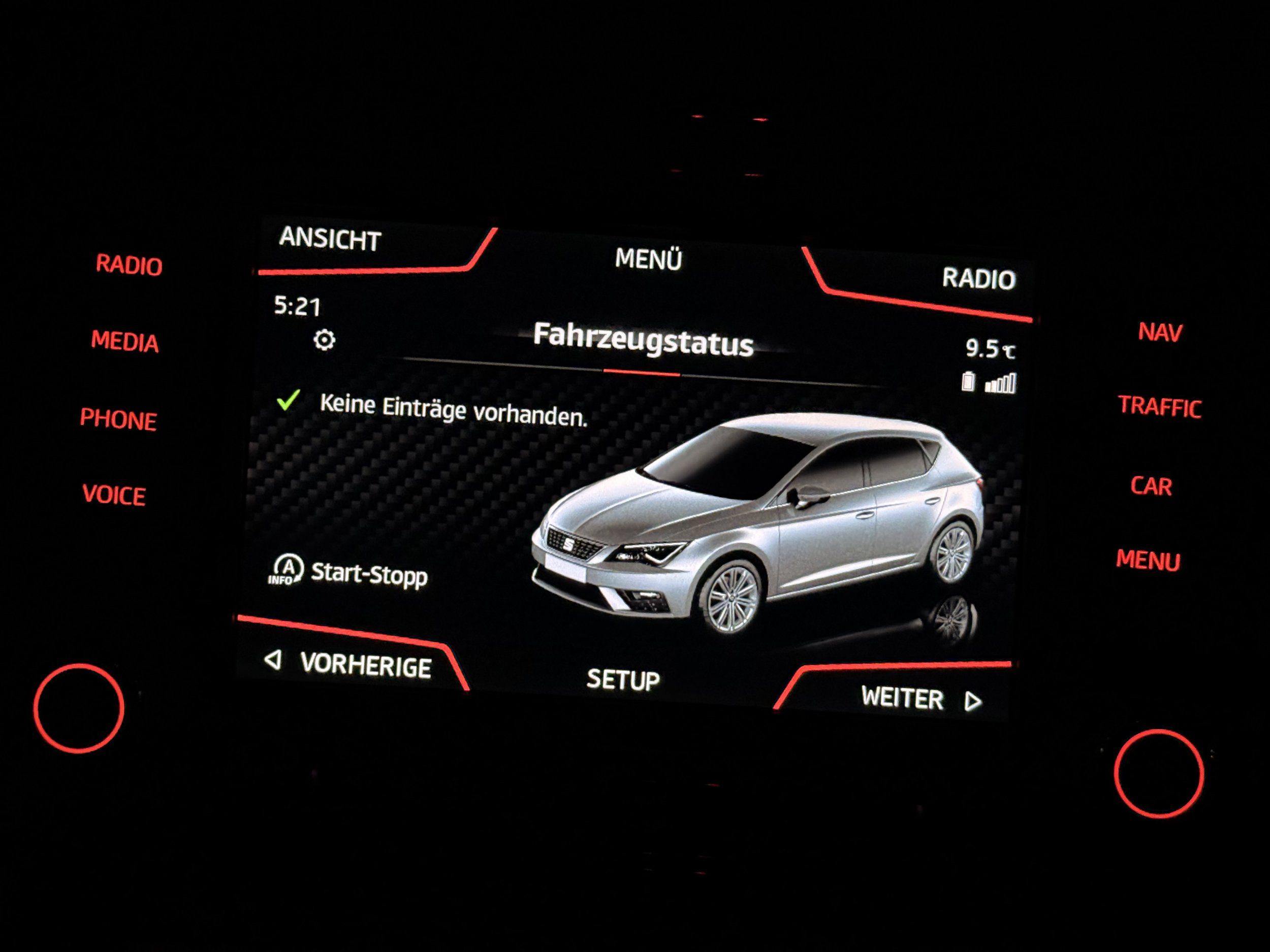

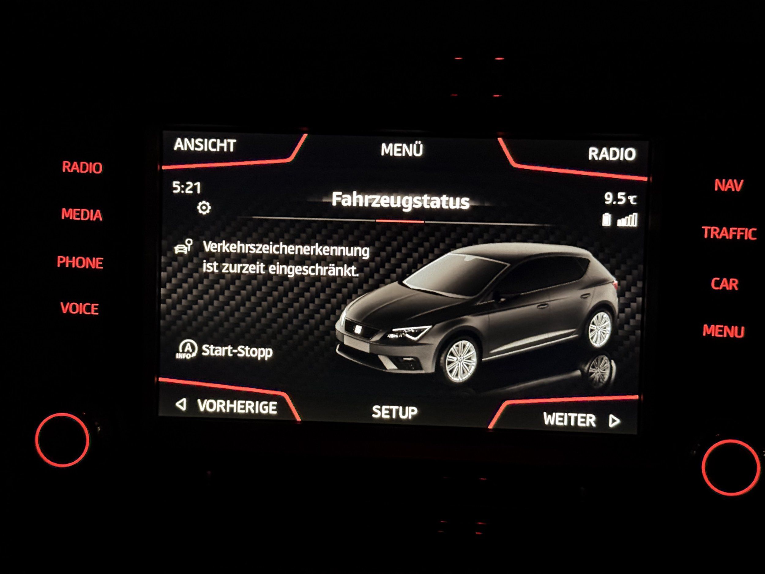

hi. i have a problem after updating MIB2 and navi.
Now there are wrong vehicle pictures / graphics in car status. I have the Leon Cupra ST (5F8), but it is shown a standard Leon hot hatch (5F5).
Attempts with long coding via ODBeleven have no effect. Does anyone have an idea or suggestions for a solution?
