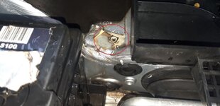

There has been quite a bit of rain recently (we are up in the north east) and I had a quick look at the battery tray swimming pool situation.
Of course there was about an inch and a half of water in there so I removed the battery and took the bung out, but while I was there I realized that there is another rubber bung towards the centre of the car. I left that one in place as I guess it can no longer flood the car but just wanted to check what other people have done with it.

Yep, remove that one too. It's got a cable through the middle of it so push it down as far as you can with a big screwdriver.
I removed a large bung just under the battery., Pushed it down with large screwdriver and pulled it out from underneath.

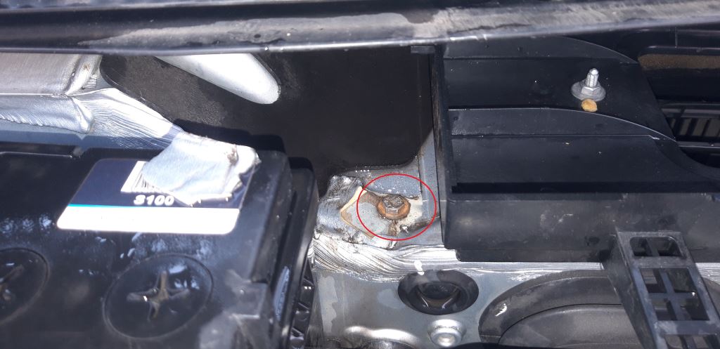

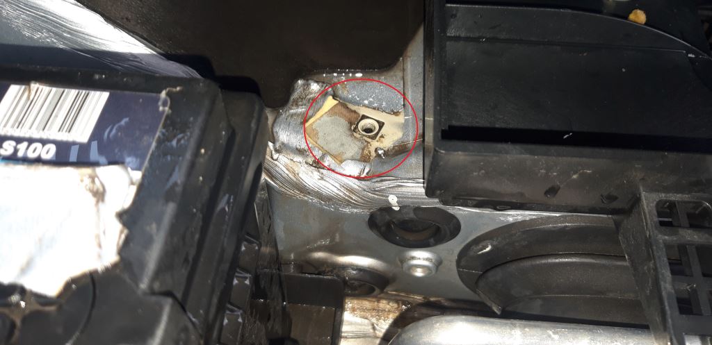

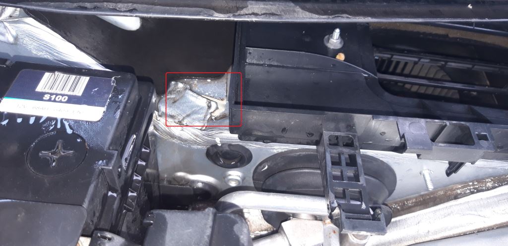

I have suffered from water getting in to the passenger footwell. first noticed it in april this year when the back passenger footwell was sodden. I had carried out all the suggested checks, removed the bung under the scuttle, removed the pollen filter and silicone sealed around the housing. I even removed the large 4 " bung on the bulkhead and silicon sealed that as well ( it was a right Bu££er to get back in ). I dried the carpet and put newspaper under to help dry out. the dry summer really helped and i thought that was that. 3 weeks ago the catch on the glove box snapped and so i had to remove the glovebox. thought I would peel back the carpet again 'just to check' it was soaking again. after a lot of swearing and checking every thing as before, i put a hose in the scuttle area- no sign of water build up nor any water getting into cabin. put the hose to the right of the pollen housing- ( looking from the bonnet of the car) again no sign of water ingress.
Put the hose to the left of the pollen filter and there was water dripping into the cabin from somewhere above the front footwell.
looked around the pollen filter for any sign of where it could be getting in and i noticed a different coloured area Pic 1 on the bulkhead to the left of the pollen filter housing.
put my fingernail behind it and it was loose. pulled it back and lo and behold there was a bolthole pic 2 that was sucking the water straight into the cabin. Sealed it with thread tape and a bolt pic 3.
Hopefully that is that. i have used a dehumidifier for three 6 hrs sessions with the carpet raised as far as possible, so hopefully that is it dried out.
only problem now is the airbag light is on because i turned the ignition on when the glove box was removed
