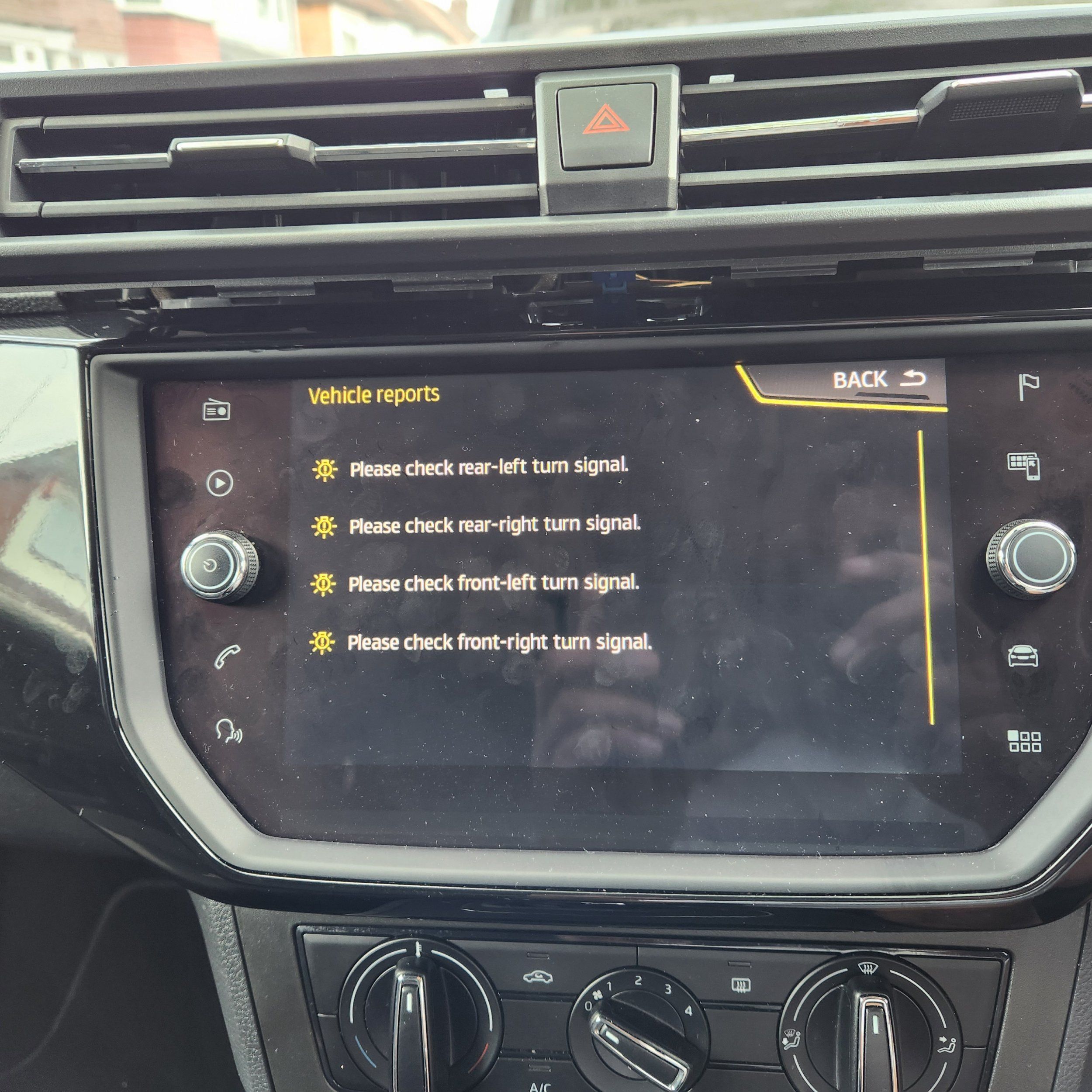

I have a issue with indicator not working, with ignition on or car started indicators dont work , just the wing mirror ones , just get a dash light msg and fast flash on the cluster, hazard work only when car is off.

today i tried again and indicators worked with ignition on, but it was faint/weak till it all stopped working again and fault appeared on the dashboard

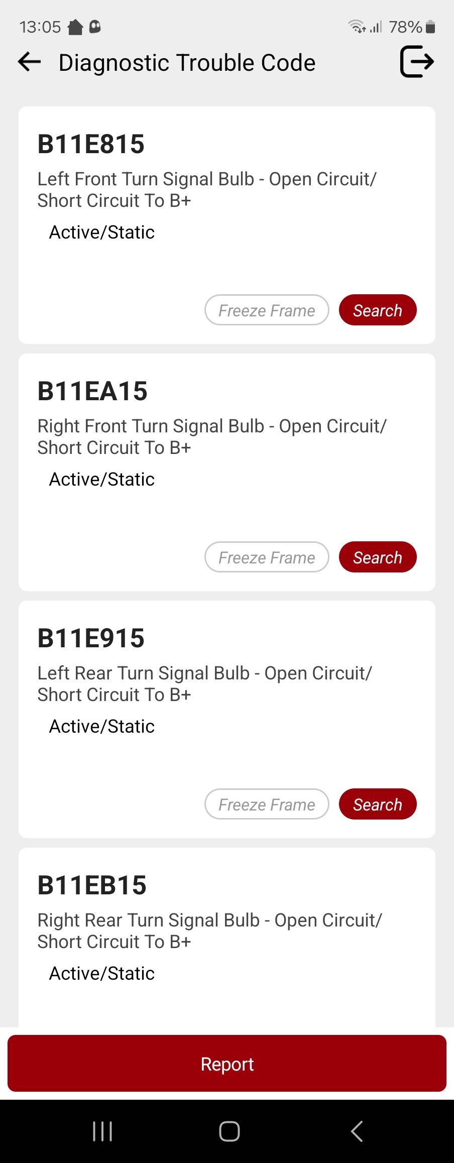

Fault codes comfort module say Open circuit fault for them lights. no other errors.

After few diagnosis was told bcm / central control module is faulty
