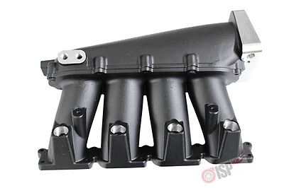

Seen a few for sale on ebay and wondering weather to get one but unsure if they'll make any difference at all or compliment a front mount intercooler?
Gokiwi64
Geriatric Member
Apr 26, 2014
1,379
722
Hockley, Essex
The first one looks to be of better quality than the red one however they will make no difference without supporting mods, fmic or not.
You will need a good hybrid turbo and downpipe/exhaust and a decent rolling road remap (not a chip tune) to take advantage of and get the best out of them.
Both look good though from a bling perspective.

I keep mulling over the idea of an upgraded intake manifold and have seen both of those particular ones posted above from various sellers.
The first one is quite similar in appearance to the Integrated Engineering one which is rather tasty but has the price tag to match.
The second one I've seen various guises and a multitude of colours and finishes.
These ones can be found on many of the Chinese websites eg. Aliexpress & Alibaba for considerably less money but I have no idea how they perform?

Another one that looks very good quality and I've noticed a lot of the yanks running big power 1.8Ts is the 034 / Grams intake.
Reactions: Manic172
Thai-wronghorse
Self proclaimed Cupra R addict & butcher!
Dec 3, 2015
2,250
1,107
Kent
I love the look of these but not sure I could bring myself to spending that much on one.
It's a shame the SEM manifolds have now been discontinued as they've been dyno proven to make a huge difference in performance in these engines.
When they do very rarely come up for sale they demand top dollar unfortunately.

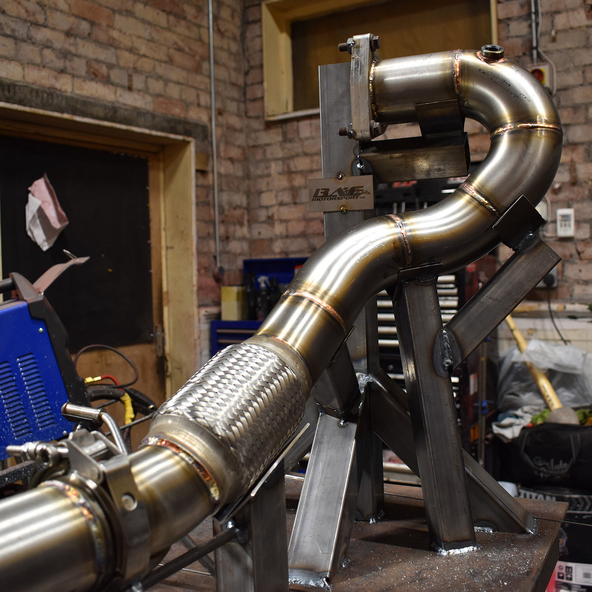

Im guessing changing the downpipe on these is a ballache aswell?
I feel like selling up and buying an RS6
I cant afford to sell up and buy an RS6
Gokiwi64
Geriatric Member
Apr 26, 2014
1,379
722
Hockley, Essex
To change the downpipe is not a huge ball ache but isnt that easy either. KO4 - you need to jack the car up as one bolt is underneath and not accessable from the top, the other 2 bolts can be got at from the top once the boost pipe and heat shields have been removed. You will need C spanners or obstruction spanners for the top 2 the bottom one a normal wobble socket and various extensions. Dont forget a new oem gasket :)
Reactions: Rich.T
Rich.T
Feb 15, 2020
1,609
932
Sounds not too bad, i was more thinking the subframe and steering rack needs lowering down to get the downpipe out and in?
Also it looks like milltek only do a decat downpipe so dont know what other companies to trust for quality and clearance issues (on body/subframe,rack etc) that may occur with the cheaper brands.
Rich.T
Feb 15, 2020
1,609
932
Nice one :)
Are they a subframe down job?
And
Any chance the car will still pass an emissions test?

I am looking in to the grams inlet. Looks very well made also company in London are a distrabuter as well.... think I need to make some phone calls
If you weren't already aware the 034 inlet is identical and made by Grams albeit rebadged and with a higher price tag so just get the Grams one.
The Skunk2 link I posted above is the cheapest I've seen so far.
Sent from my SM-G986B using Tapatalk
Reactions: Manic172 and Rich.T
Manic172
Dec 4, 2018
1,447
1,580
Hemel hempstead
www.seatcupra.net
But I do like the look of the IE one tho......
As you say skunk2 do have a really cheep price tag some how.

Right looking at this link, they do 2.5 and 3.0 inch downpipe and sports cat. I have a 2.75 inch milltek middle section and rear box.
I could get either the 2.5 or 3.0 inch dp and cat to attach to my 2 75. Done properly with a welder that does stainless.
Would that be ok as i plan to go stage 2?
The middle and rear cost a pretty penny. Im not being tight but on the other hand, im not into throwing money away.
