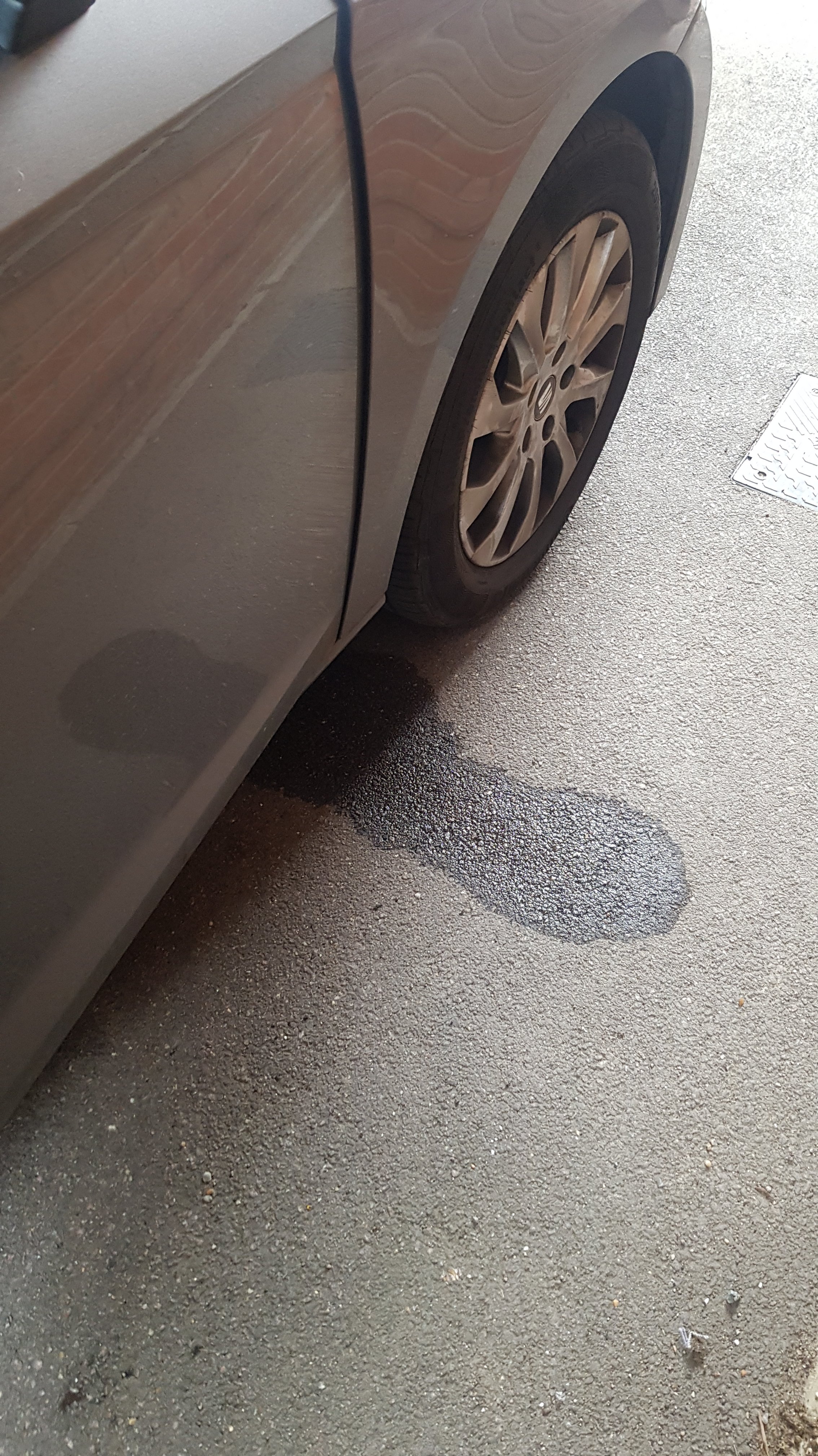

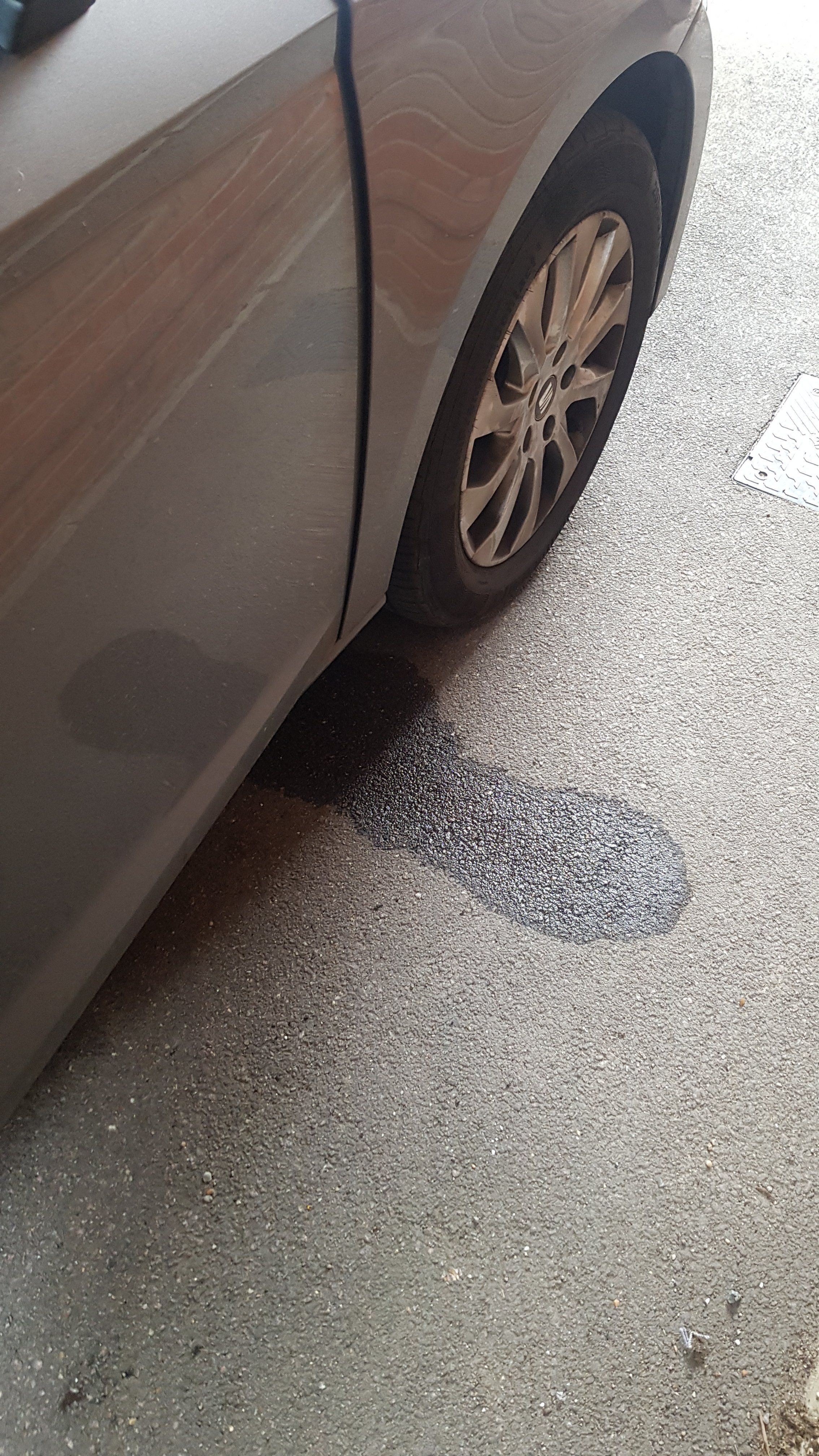

I can report back some leaking as someone else pointed out. See picture. Not sure how normal this is as I can say I've never used my washer whilst stationary and observed so intently.
There seemed to be a fair amount of liquid pooled on the ground, and whilst lifting the bonnet post application and spray, there was still a fair bit of liquid dripping from the driver side sprayer.
My guess is the liquid doesn't exit the fan washer as quickly as the jet, so when I disengage, the liquid which hasn't been jettisoned just sits in the pipe and leaks out. Therefore in reality I'm probably not saving any wash as a result of the swap; but the clean is certainly better and that is good enough for me.
Exactly what I had with geniune ones, the water runs out and wets the top rubber seals on the scuttle. They don't have a one way valve or something different, found the cheap ones better! But one of my cheaper ones gets blocked easy, so who knows!

Just ordered a pair of these , any leaking issues as per post 402?
