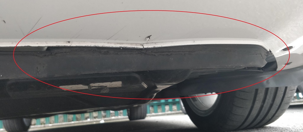

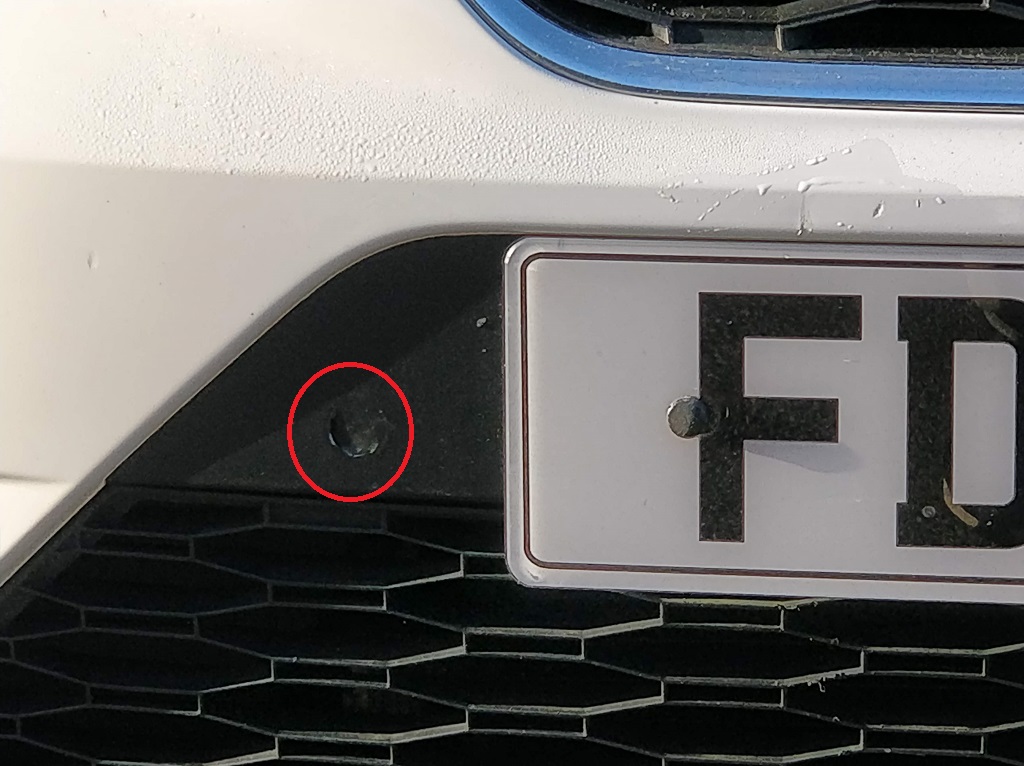

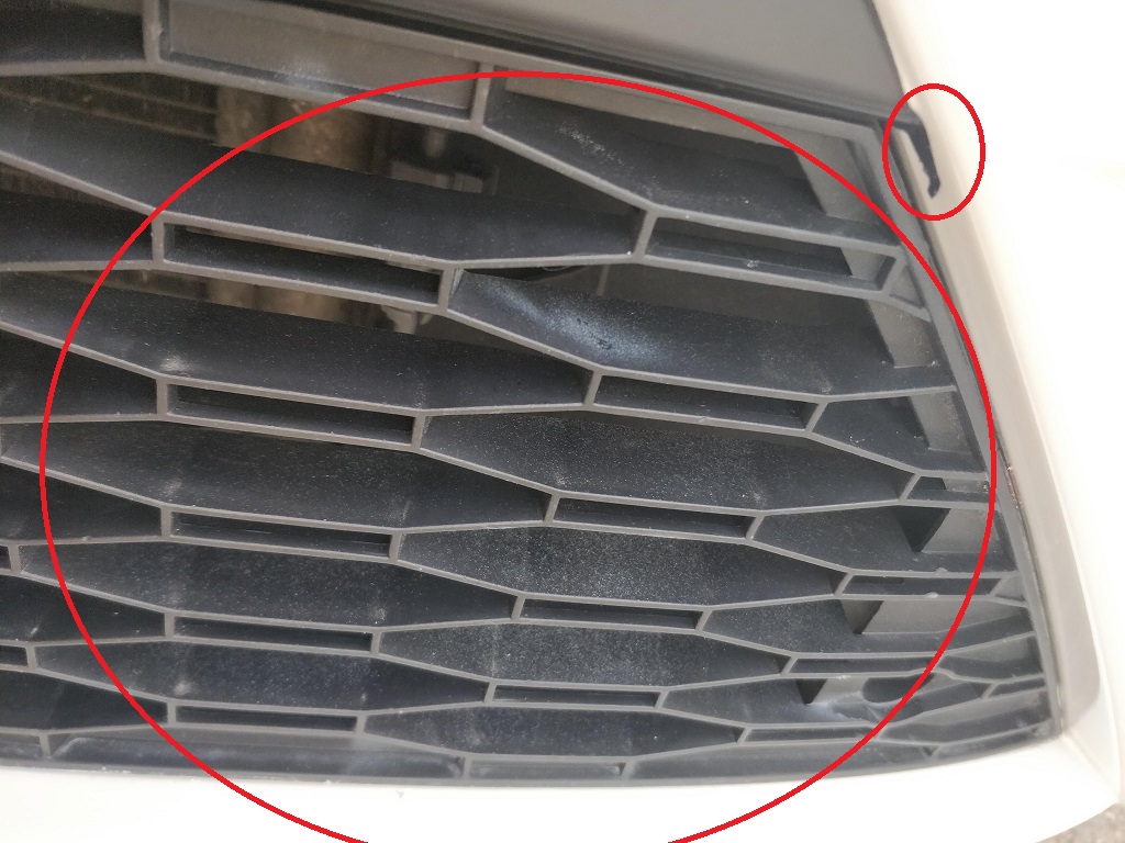

Similar situation I have with accident Repair Centre Sidcup approved repair garage for Admiral. Just a couple of pictures their "quality" work.
The car has been rejected twice. After accident only Headlight has been changed otherwise they tried to patch everything. Very badly as you can see. Damaged wheel arch plastic hasn't been changed at all. Alloy wheel refurbishment is disgusting. Front grill heavily overspray with paint. Another headlight damaged with some solvent so plastic is fade out :repuke:
I would appreciate any advice?
IMG_20180929_084219.jpg IMG_20180929_084233.jpg IMG_20181004_162313.jpgIMG_20181004_162229.jpgIMG_20181004_162243.jpg
