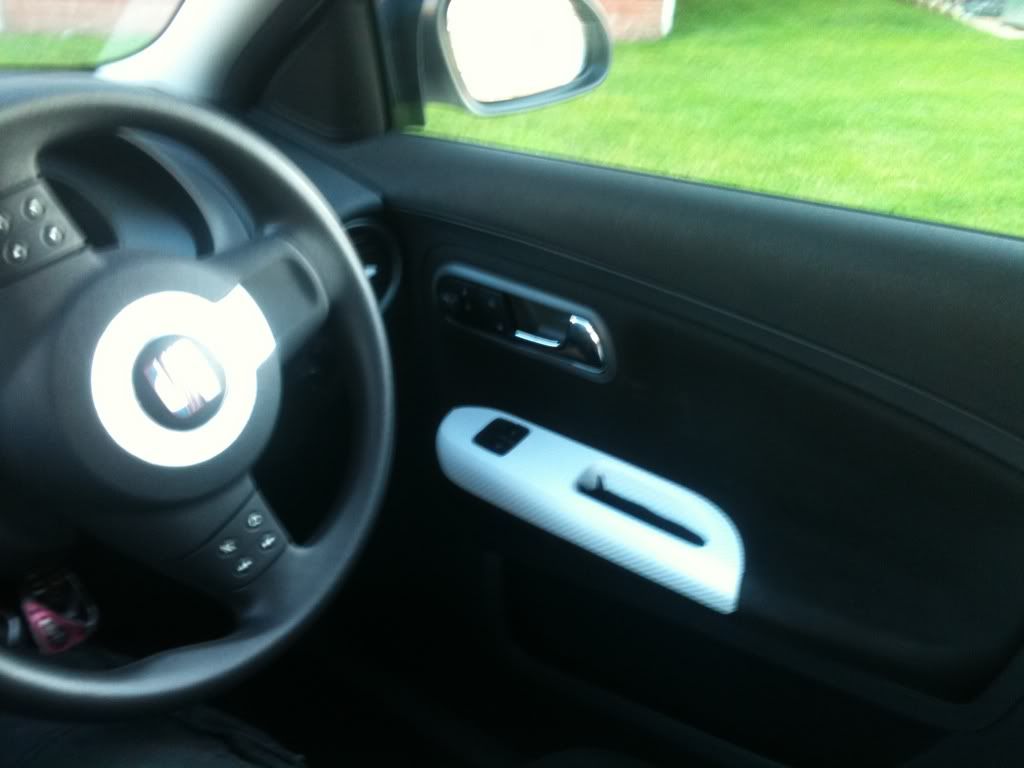

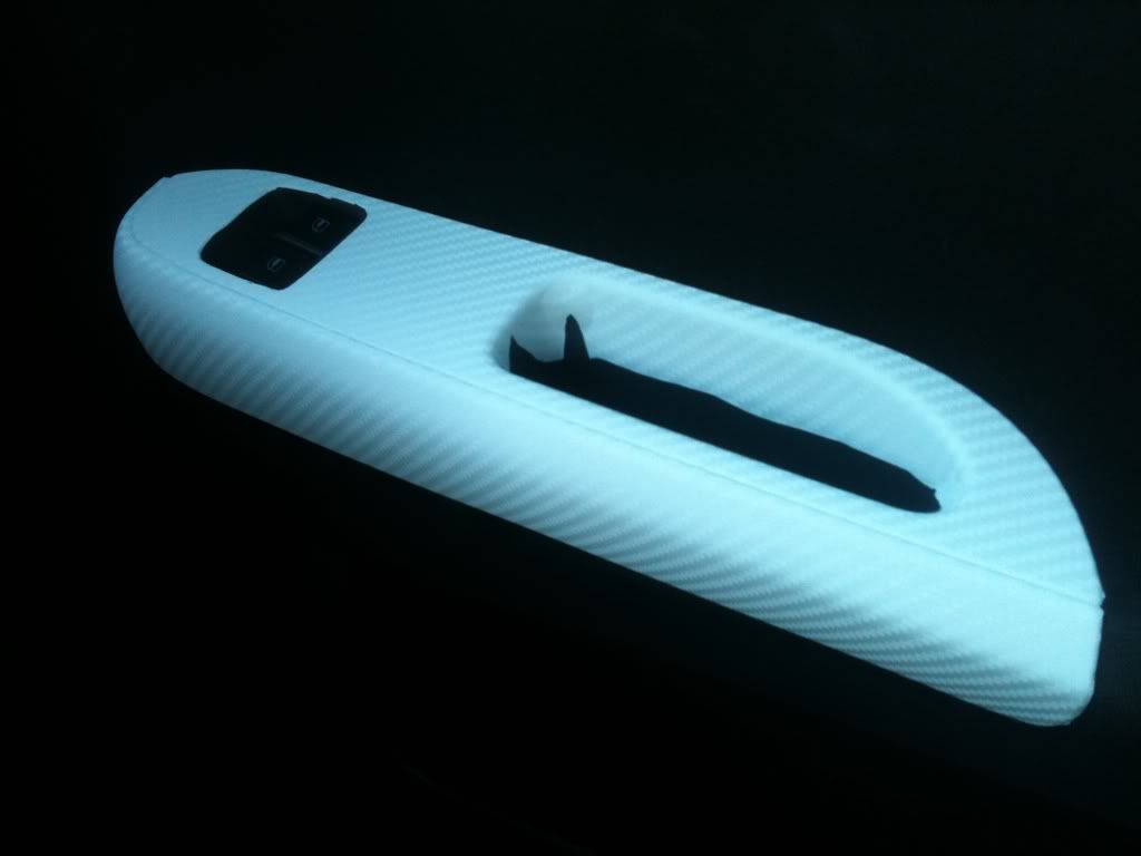

This is what I had tried but it kept peeling and I'm already sick of pushing it back into place.

yeah does'nt look right, need to do inside the grab handle and the window switches scoop. I'm going to try gloss black plasti-kote when i get paid - so skint can't even afford £6.98 can of paint from b&q lol

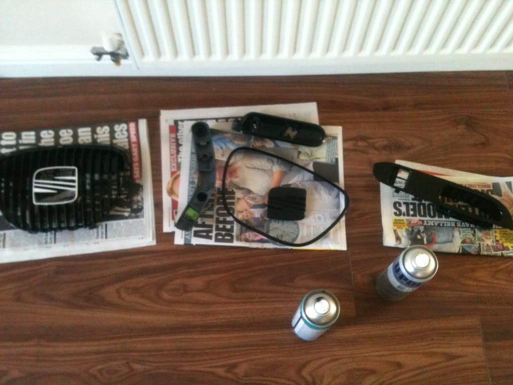

Sanded with 240 grit. Plastic primerb sanded with 600 grit n then sprayed it gloss black. Will let it dry and sand in the morning with finer stuff (another trip to autogear) then a few clear coats.
is the stuff from autogear cheaper than halfords? Hate how things like wet sanding paper etc always cost a bomb in halfords!

Peeling? They are just hard plastic, no rubber to be seen on mine :( I'm sure they are cheap to buy new tbh.
