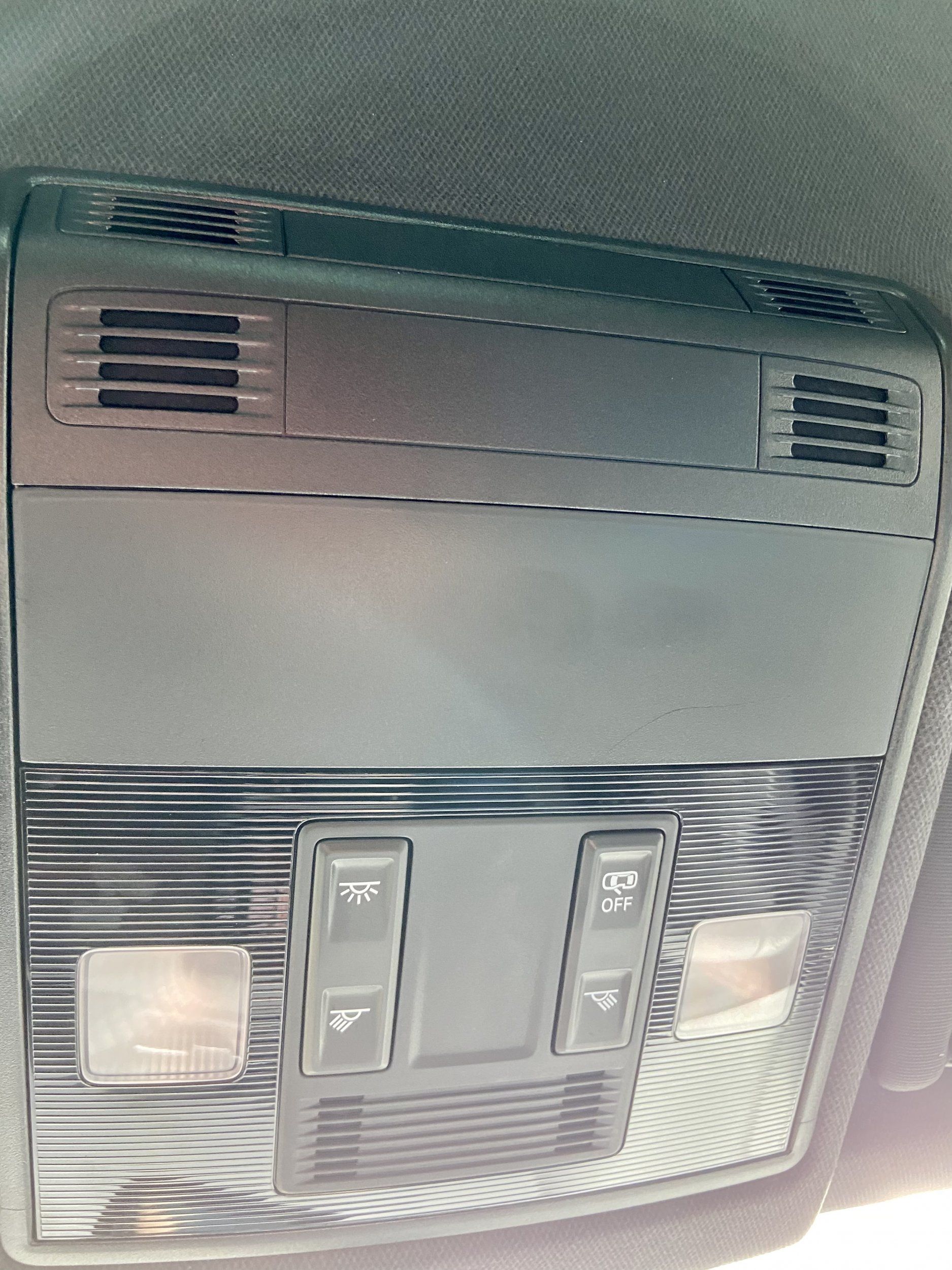

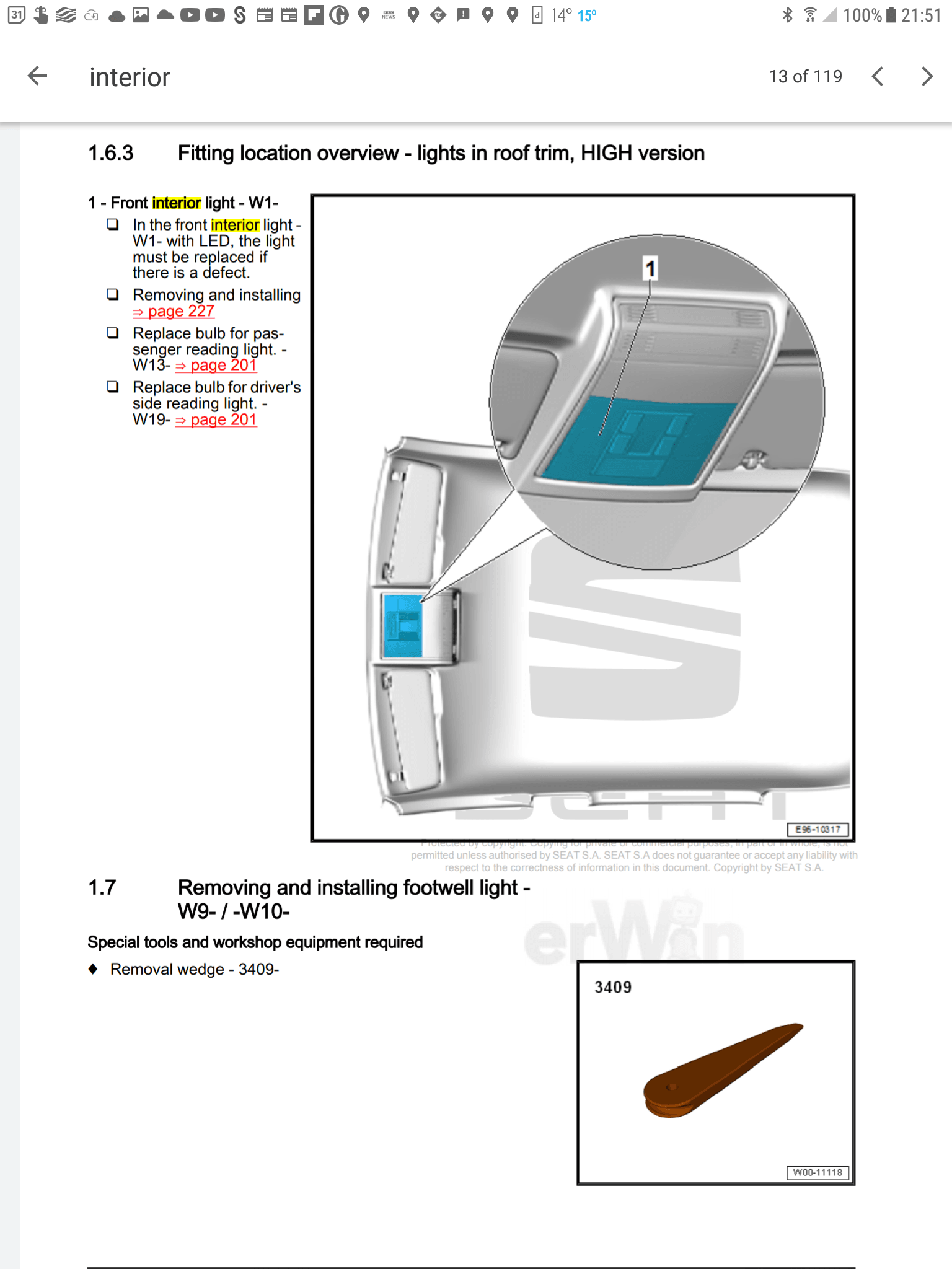

Does anyone know how to remove the interior light cluster to replace the bulbs please?
I'm guessing I need to prise the entire unit out with a trim removal tool, but wary of causing damage....
Just not sure if I start at the top (vented) edge or the bottom.
Either way seems a faff to change a bulb ?

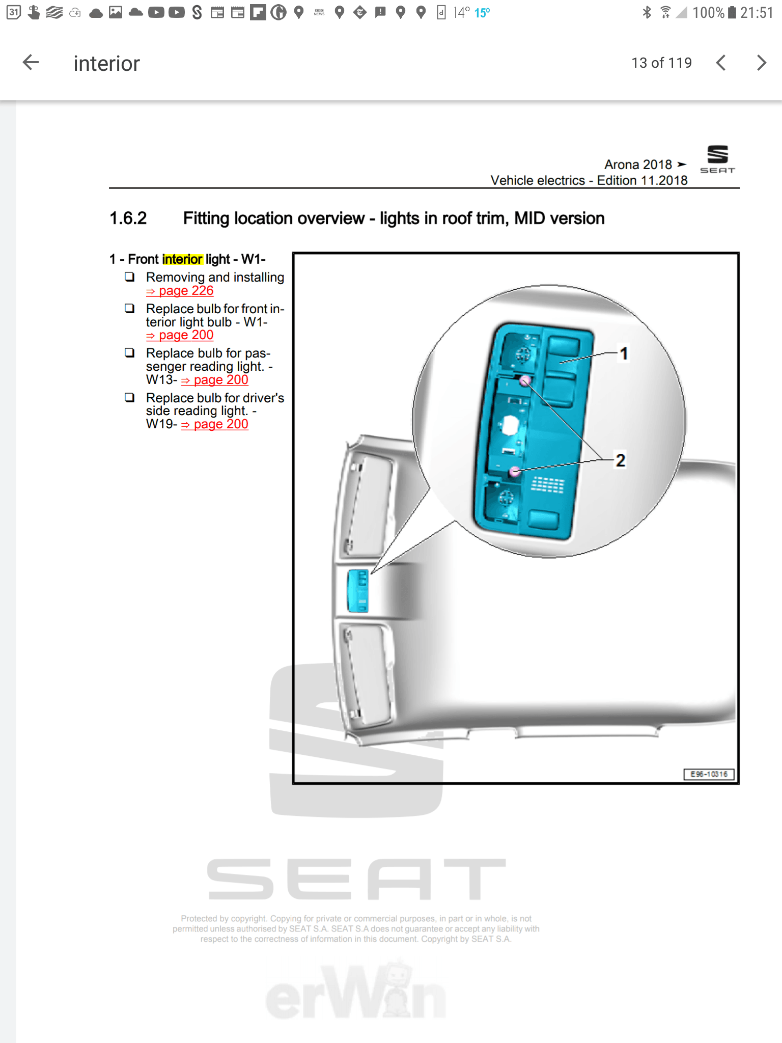

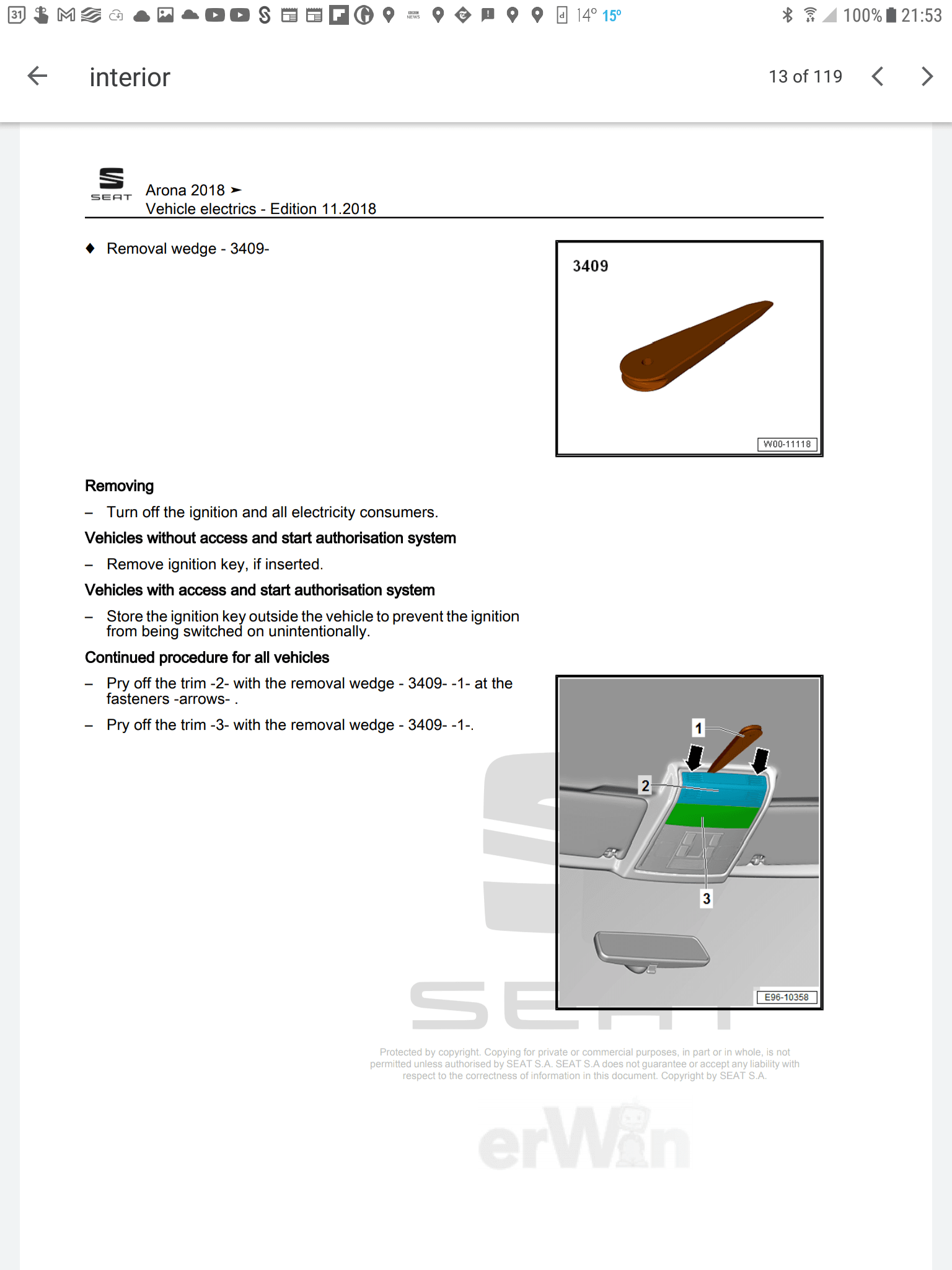

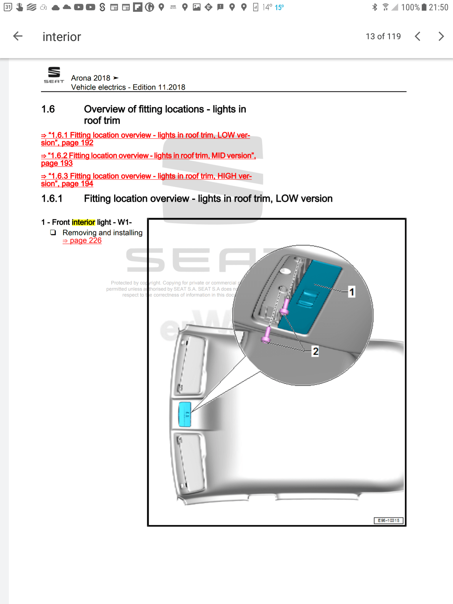

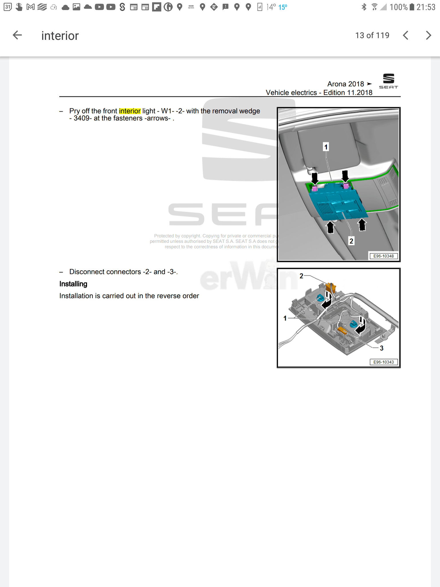

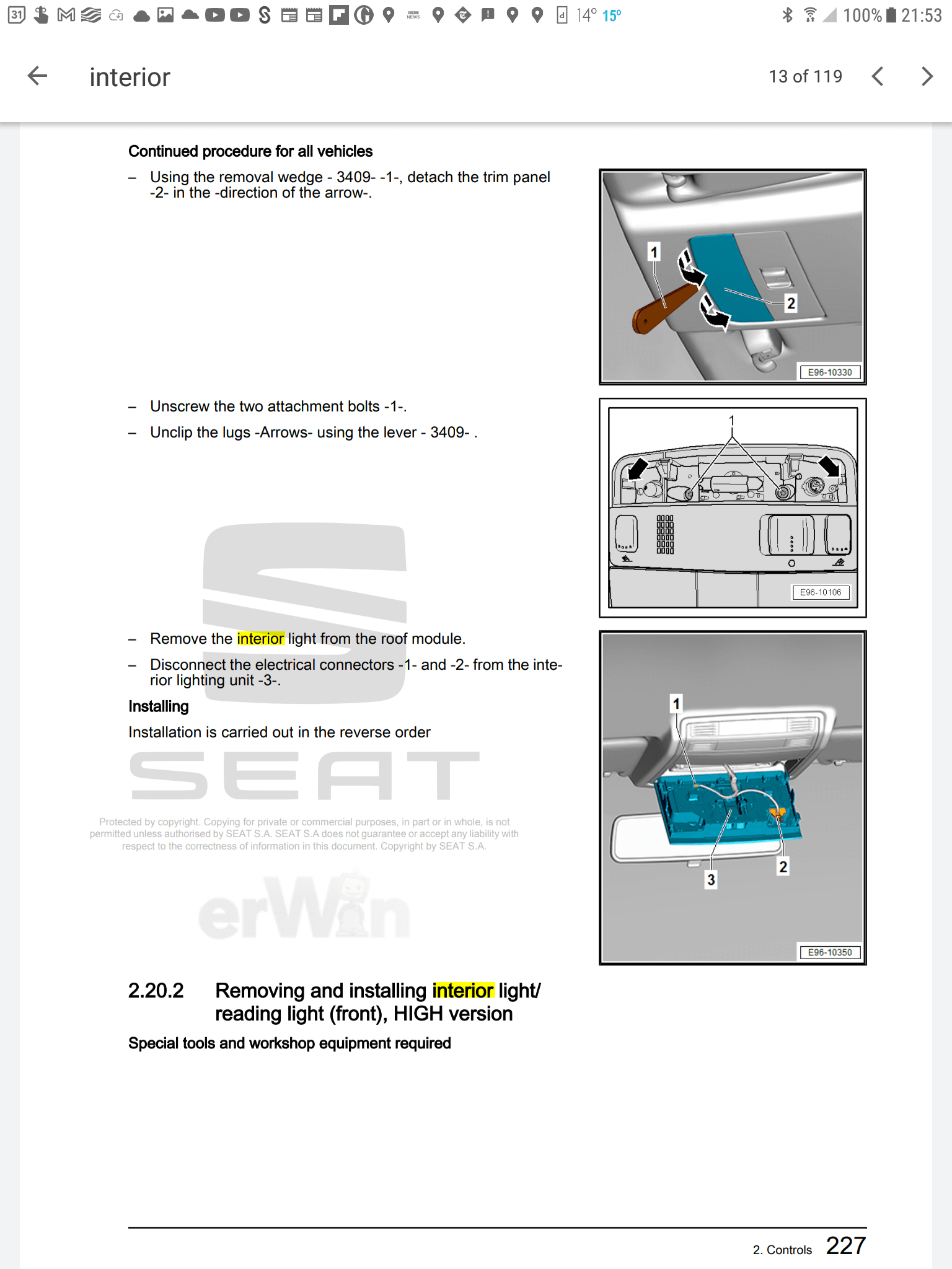

Give you a flavour, there are three types, you got the high type.

Sorted thanks for the photos - if any one else tries, just remove the bottom strip covering the bulbs (bottom third of the unit) it's very flexible and will pop off with a wide trim tool. Do both edges and top edge of the strip, bit by bit. Popped in the LEDs and massive difference.
