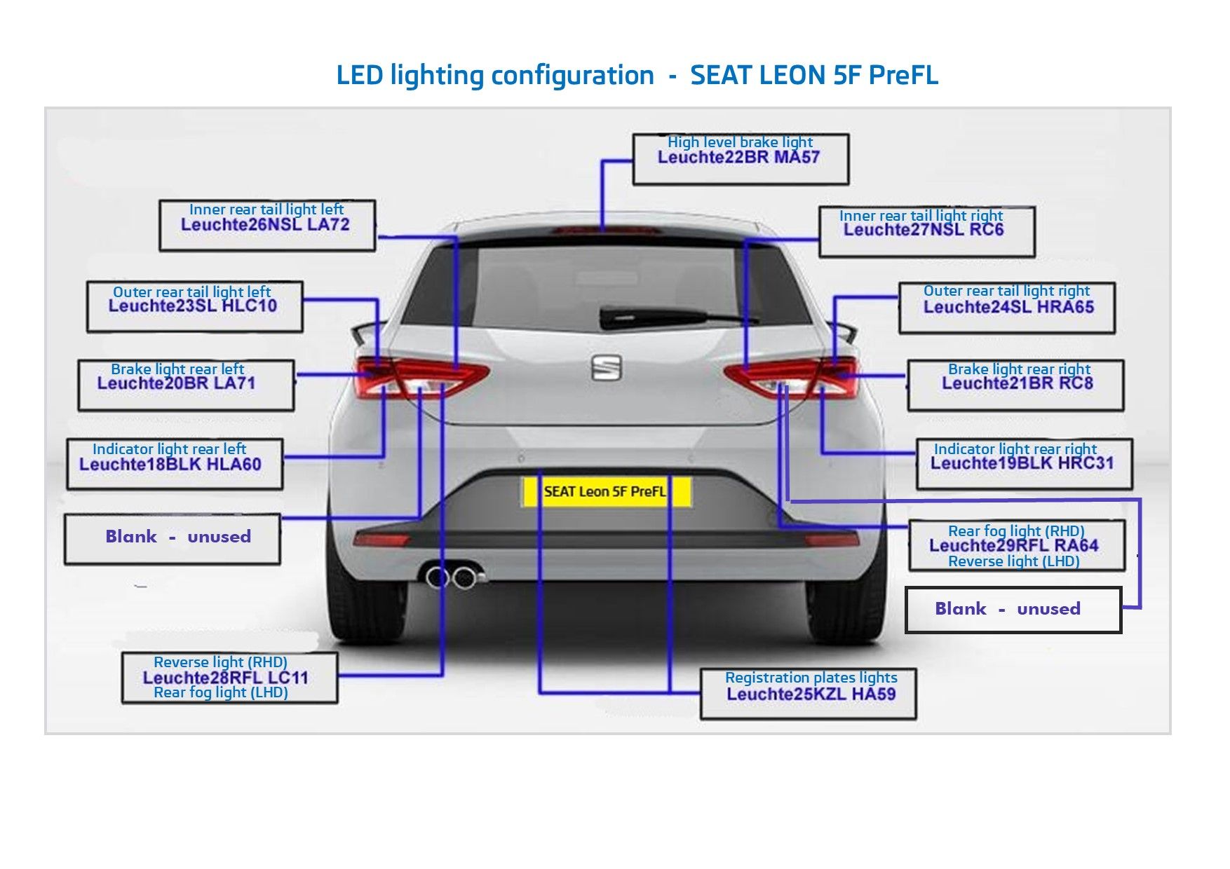

When I reverse only the left side is working and not the right. When I tried changing the bulbs I realised the lights on the right were completely different to the ones on the left.
how does it work? When I removed the bulb on the right, the left one also stopped working.
the bulb on the left seems to be a fog light bulb.
The Leon mk 3 only has one reverse light fitted - left side in UK right hand drive, right side for left hand drive cars. The equivalent light on the right(right hand drive) /left (left hand drive) is the single rear fog light, which is a totally different type of bulb to the reverse light on the other side

thank you so much, was wondering why both lights wouldn't light up
