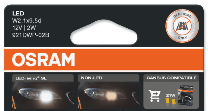

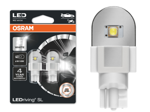

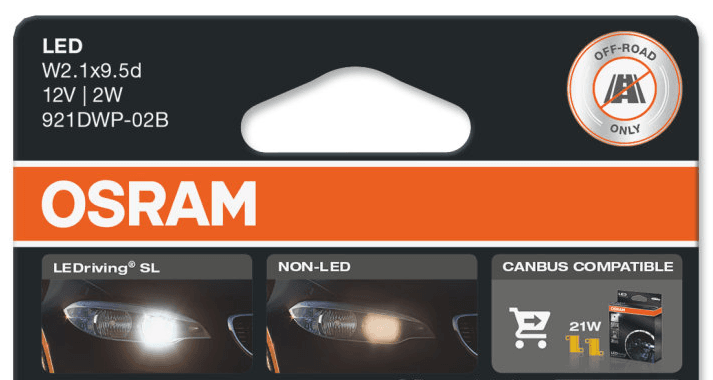

Hello All,
I have a 2020 Facelift Leon FR. I want to replace my reversing bulb to led. Which of the below bulbs should I buy?
Does the fault light come on after installation? or plug and play? I am waiting your kindly help.
Thanks and Regards.

My only comment would be that the website states the Osram bulb is not CANBus compatible; which suggests it will throw a bulb-out warning (if the reversing light is monitored for bulb failure- I don't know if it is or not)

@hakanFR
I have the previous generation OSRAM W16W LED on MY2019 car. No bulb out warning, so I’m assuming that the reverse light is not monitored.
I do have VCDS, but 99% sure I haven’t coded it out.
Easiest way to tell is to remove the halogen bulb and put into reverse and see if it throws an error.
