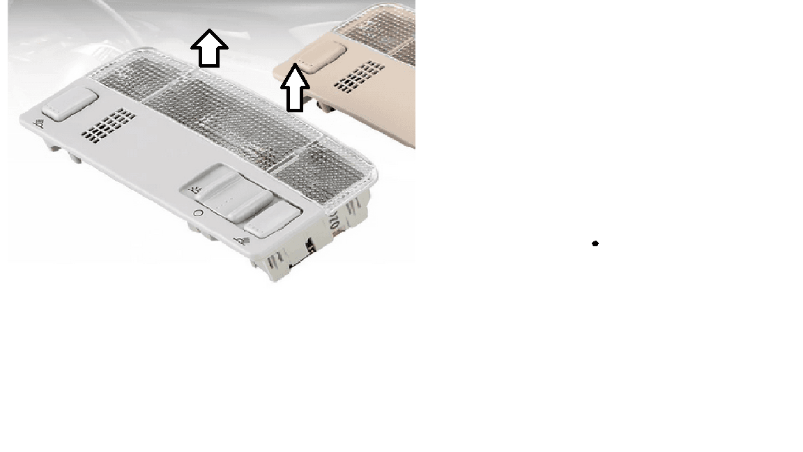

Hello,
I'm looking to replace the two interior lights in the roof lining and need advice on how to remove the housing to get access to the bulbs.

Place a plastic object or a small screwdriver and pull down the front area as shown in the photo
